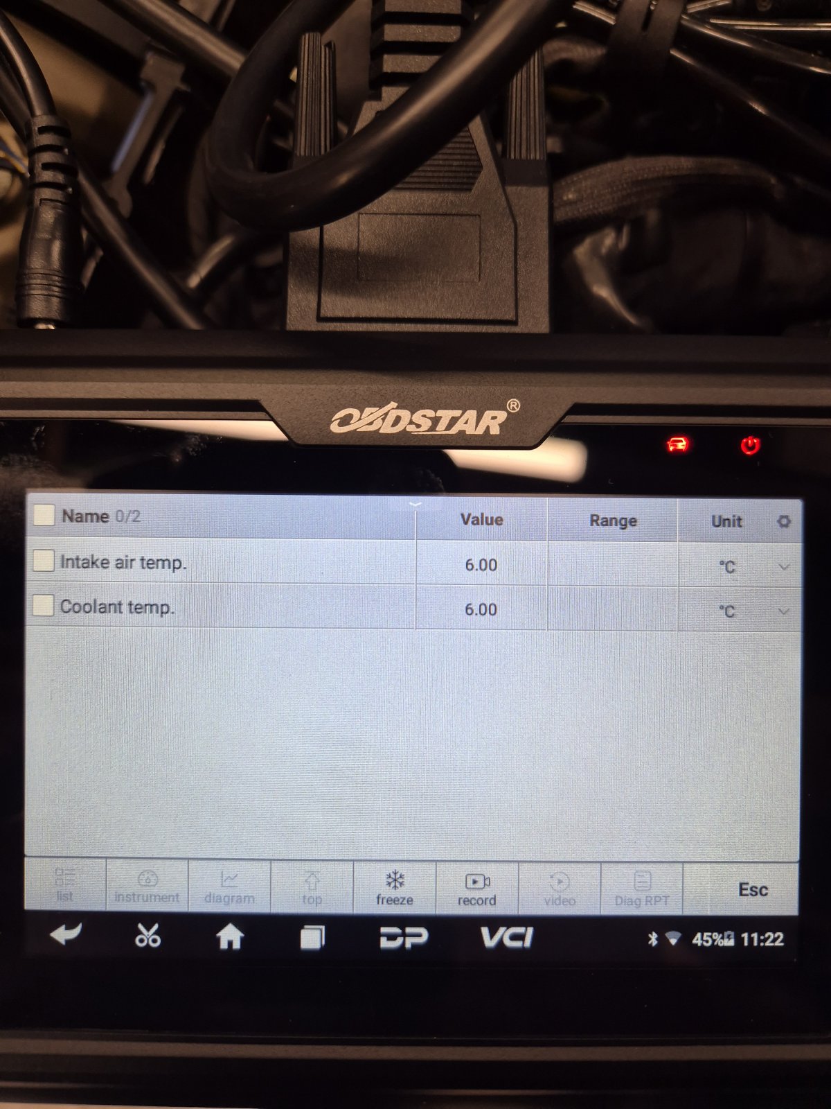

  13. plug it back in when back to ambient temperature (several hours after being at full temp) and observe coolant and air temp
  14. That's a good suggestion :upyeah: the fuelling certainly relies on info from the temperature sensors :thinkingface: Andy
  15. it could just be a il glitch depending on how long it ran the night before. age/millage of plugs and the kind of use/start up's it's been getting of late.
    i cant say for ducati of that era but certainly i know of vehicles that rely on air temp for start up rather than coolant temp. fiat from around 2007 which almost deffo means ducati used the same around that time too.
  16. 6 deg on both @10mins ago and the bike started up no problem at all.
    I think it was probably at the most 2 deg when I tried yesterday and 0 deg on Friday.
    I must figure out how to upload data to a file(Anyone walk me through it?) but the below is as good as on this occasion.
  17. assuming it's getting a correct value from the map, maps? sensor. it's probably a safe bet to say that it's fuelling ok.
