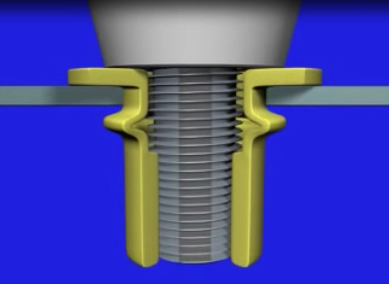

  4. IMG_0382.JPG Have you thought of using rivnuts, these give you a thread you can screw into.
    Vatrious sizes available, from eBay, screwfix etc.
    If using in plastic / GRP, dont over tighten when fitting to prevent cracking the parent material.
    These are fitted with a bespoke tool, about £20 similar to a pop rivet gun.
  5. There are lots of alternative fixings but on these bikes it is about preserving originality.

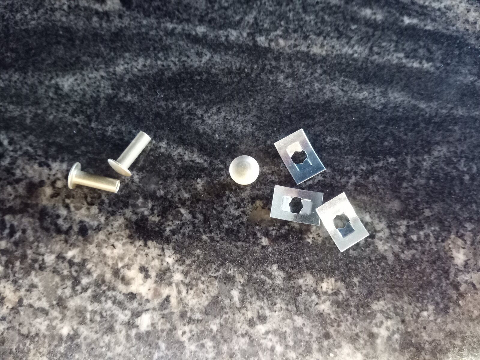

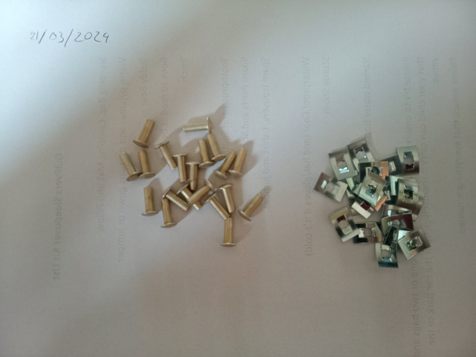

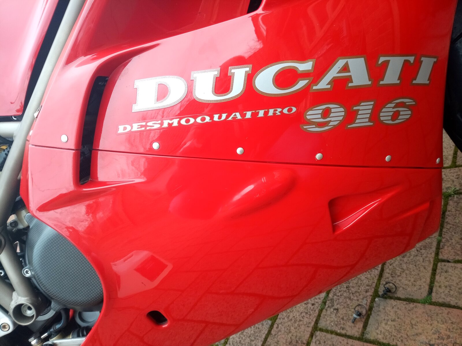

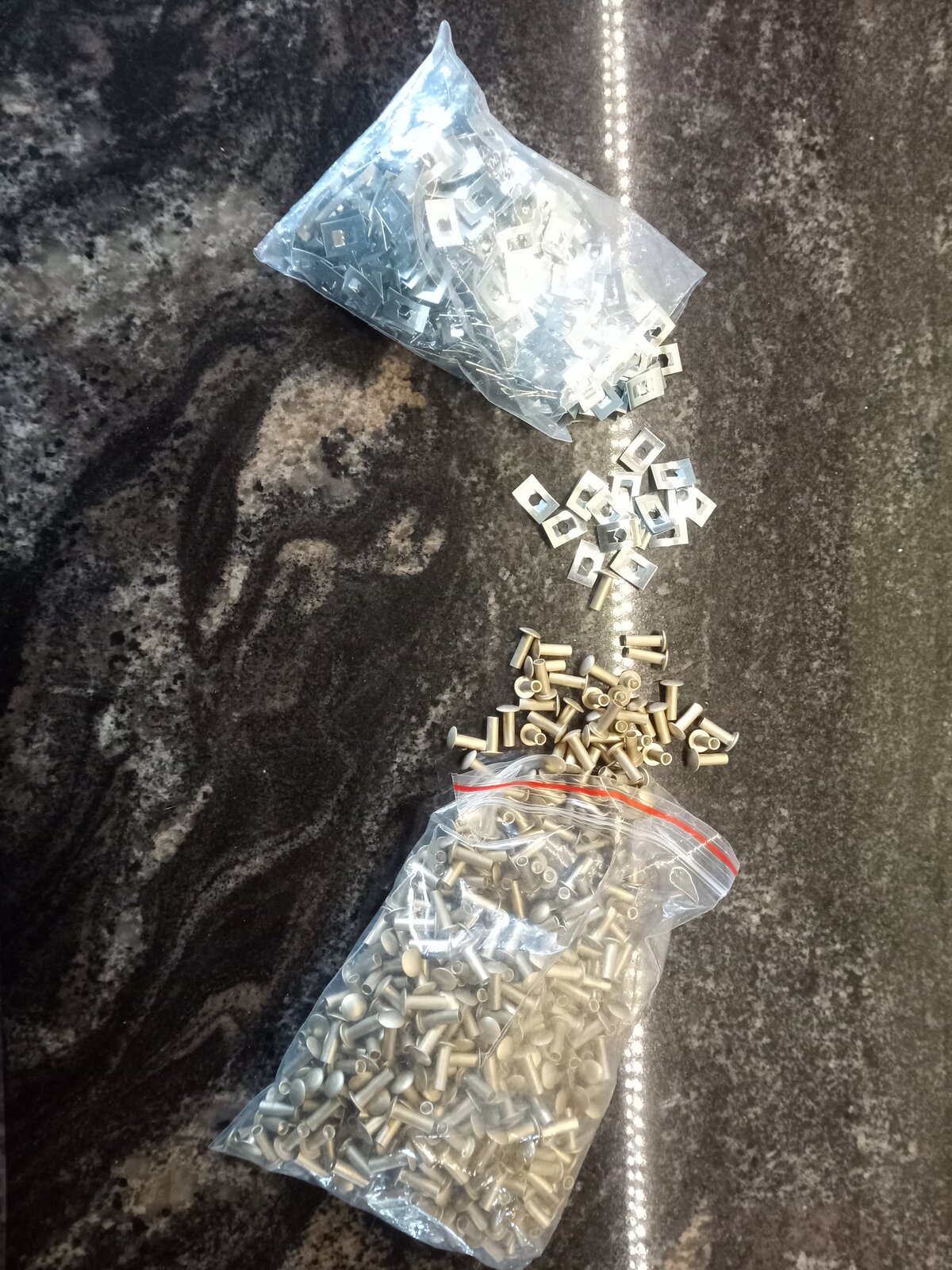

  6. Bit of a resurrection of this thread. I have been able to replicate these rivets to my satisfaction. If anyone is in need, feel free to contact me. I chose to have zinc plated backing plates but I can do them in the burnished steel too. IMG_20240321_114700_516.jpg IMG_20240321_114607_132.jpg IMG_20240321_122647_030.jpg IMG_20240321_123438_299.jpg

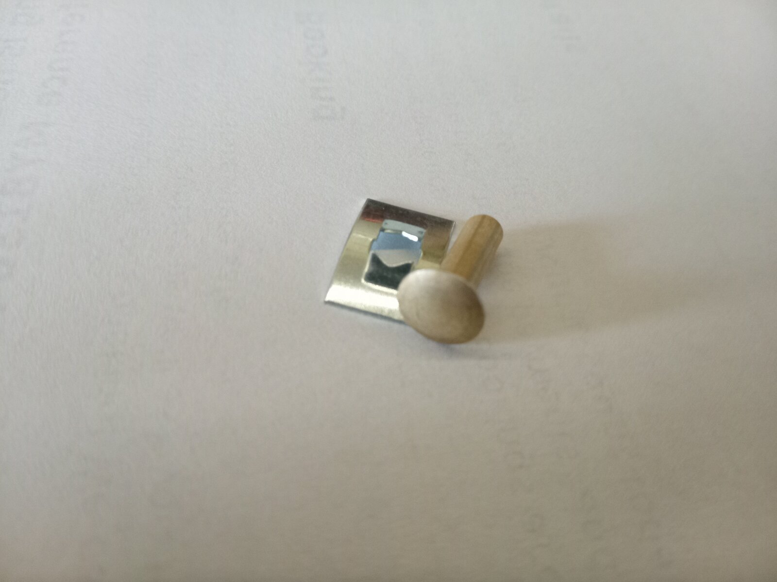

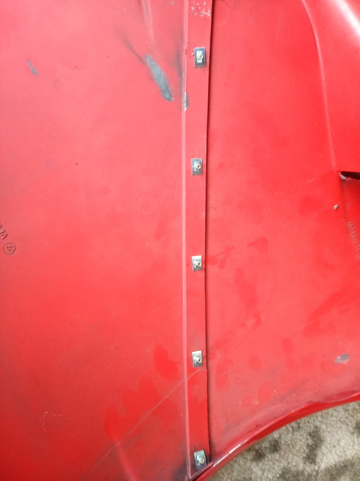

  7. I had a load of them made. Let me know if you need some. IMG_20240409_112550_680.jpg IMG_20240409_112648_342.jpg
