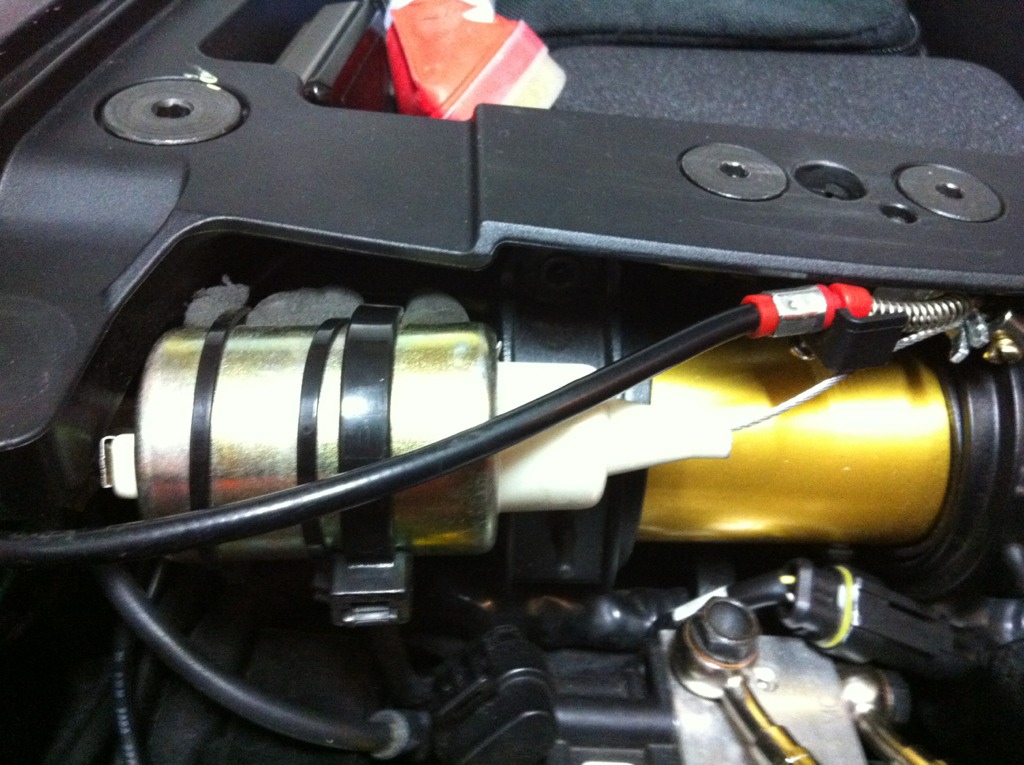

  4. Ive made a remote rear seat release, using a car central locking solenoid
    Works a treat, and saves you leaving the key in the seat release latch, which is very easy to do! I know cause ive done it!! But luckly it didnt fall out..!

    Here's a pic of solenoid fitted
    Strapped to suspension resoviour with a big tie wrap and some dense foam padding
    Wired to ignition voltage, push button switch, (hidden) pulls solenoid (quite powerfully) and up pops rear seat! Simples!!
    No need for key, just need to remember to pop rear seat before I turn off ignition ( or turn on to open seat)
    And link to e bay to purchase
    http://www.ebay.co.uk/itm/230686589133?ssPageName=STRK:MEWAX:IT&_trksid=p3984.m1438.l2649
    Hope this helps. PM if you want any further info?

    Boomer, was it as simple as taking a +ive feed from the battery via a fuse, to the switch, switch to solenoid and solenoid to -ive on the battery?
    Also, how did you attach the wire cable to the existing cable ?
    Thanks
    #30 Tripletrouble, Jan 17, 2013
  11. Hi Tripletrouble,
    Yeah thats right, + to battery via in line fuse, to push button switch. And - to good earth or battery -
    The kit doesnt need a relay if you use the supplied switch, as it can handle the current draw
    I tried a smaller push button switch at 1st, but it just fried the contacts in the switch! Could have wired via a relay, but decided on the simpler option of no relay and supplied push button switch
    You attach the cable with a little wire clamp grub screw type device, onto the original seat pull cable. I think it came in the kit, but i cant remember now..
    This also still leaves the original cable attached if you still wish to use the key option as well
    Hope that helps
