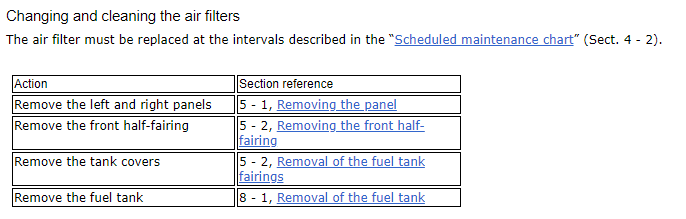

  12. Hi Mazza. If it helps. I don't have to move tank to change air filter on my 2013 1200.
  13. Really? Im pretty sure you do....
  14. Nope. Done it twice.
  15. Can you please post up how you do that then as its a job I need to do on my 2013 MTS.
  16. Remove the panels as in manual. You can just about get to the fasteners holding on the air filter's plastic cover, wiggle it out past frame. There is enough room to slide element out. Happy days.
  17. I may even have not removed all red panels, just the small black one over the flexible air duct on the right hand side. Cant remember. Ive had to do quite a bit of faff to correct design flaws (as we all know), tail light/ tail tidy/ chaffing wires to sensors/heatedgrips/switchgear,/exhaust valve/ the list goes on blah blah blah. Lovely motor, suspension and chassis tho. Either way, you don't need to move tank.
  18. C
    Cool. I'll give it a crack. Ta.
