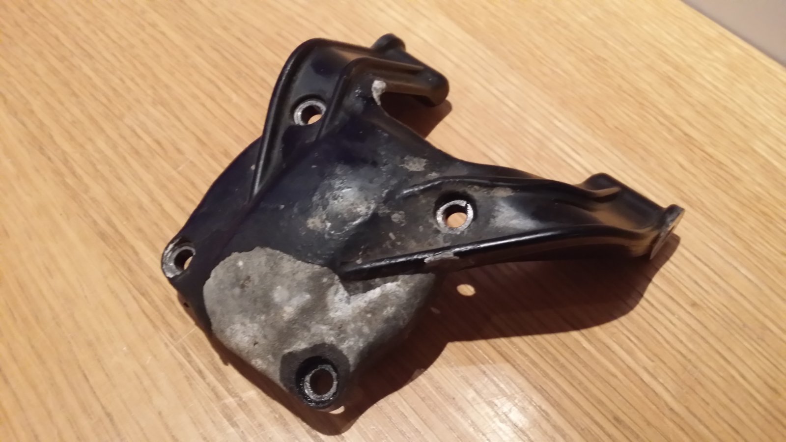

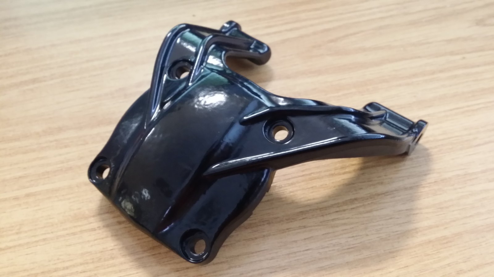

  2. Just to add a bit of weight to it - heres the first thing I got coated (the front rad mount)....this was a week after I owned the bike. 4.8k...
    And after I got it done....
    And since its been done not one bit has flaked off....the rear mount that holds the termi on was in a worse state...didn't take a pic of that but I should have done....the pre done shot...if it looked like that after 20k and a life being used in all weathers then I would have expected it and been happy at that...
  3. That is shit I bet it's down to some bloody bean counter in purchasing, we've known for donkeys years that Ali's notoriously difficult to keep a coating on without special treatment, all those extra stages of pickling & etch priming cost money but are absolutely necessary to stop oxidisation & flaking paint. They've probably just been sent to a jobbing powdercoat company who to get things down to a "competitive" rate miss these critical stages out. How the hell does this stuff get through QC !

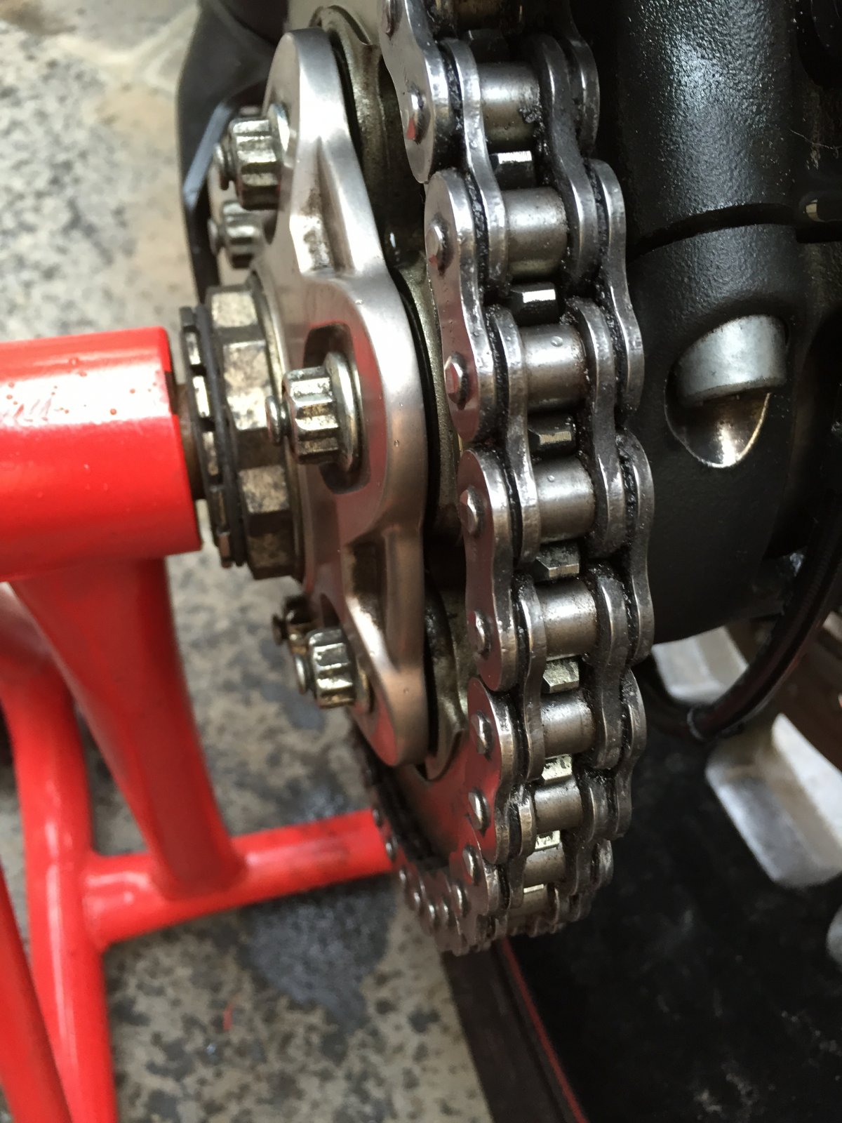

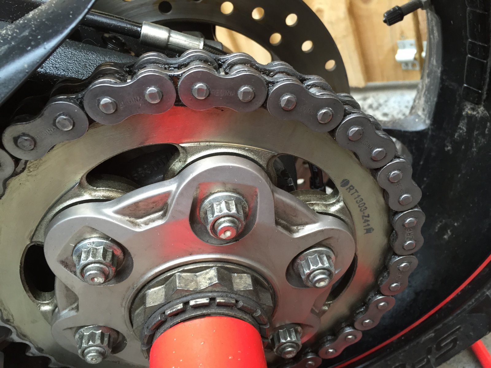

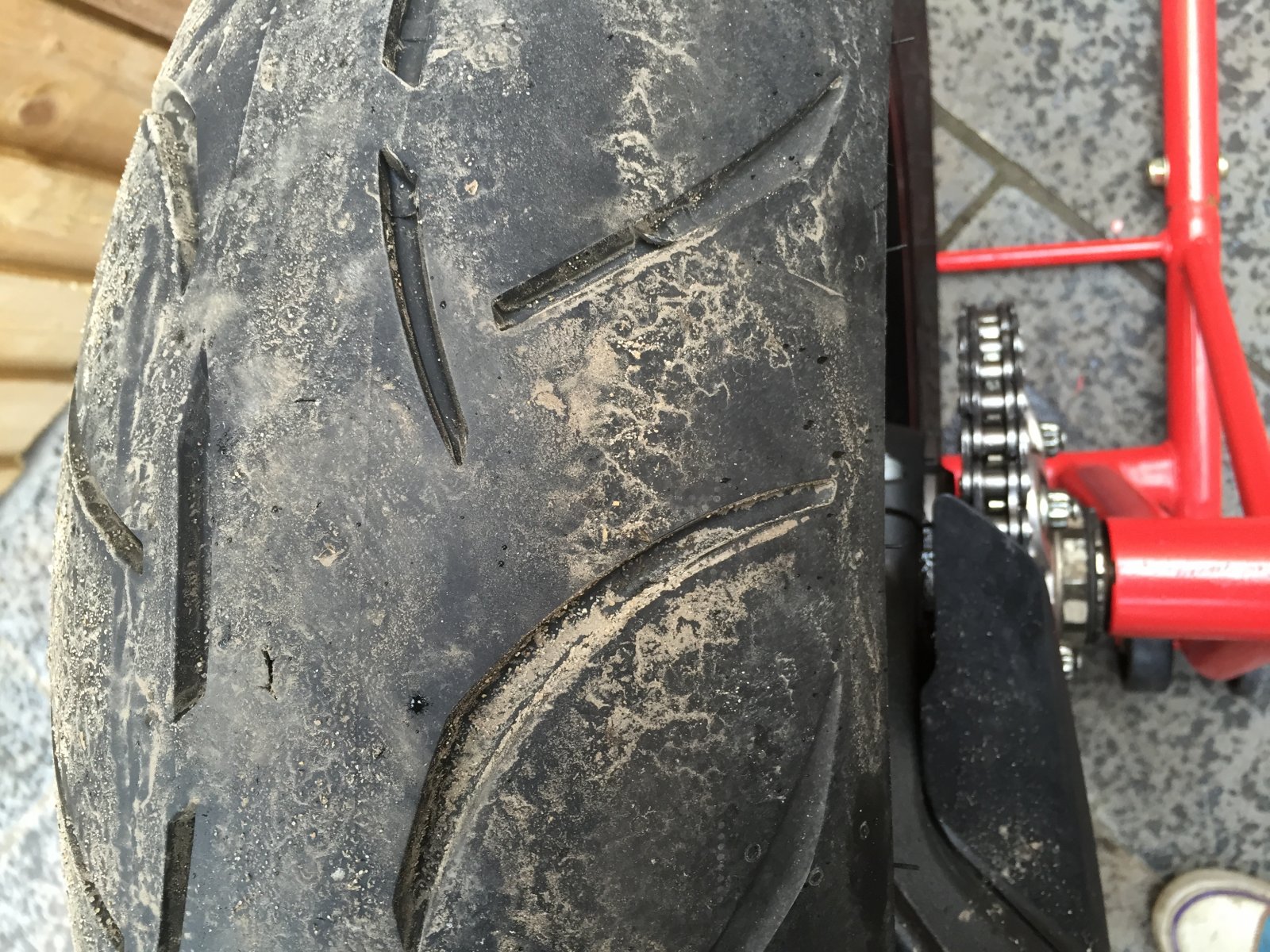

  5. Chain looks good red rust
  6. It's looking even better this morning.

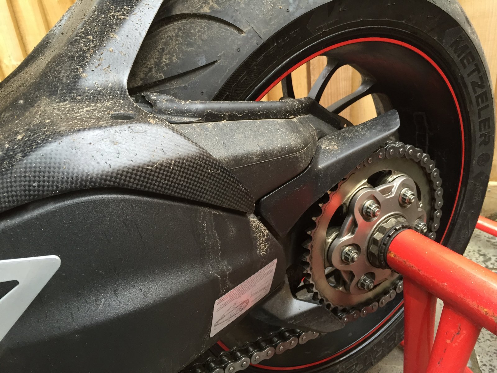

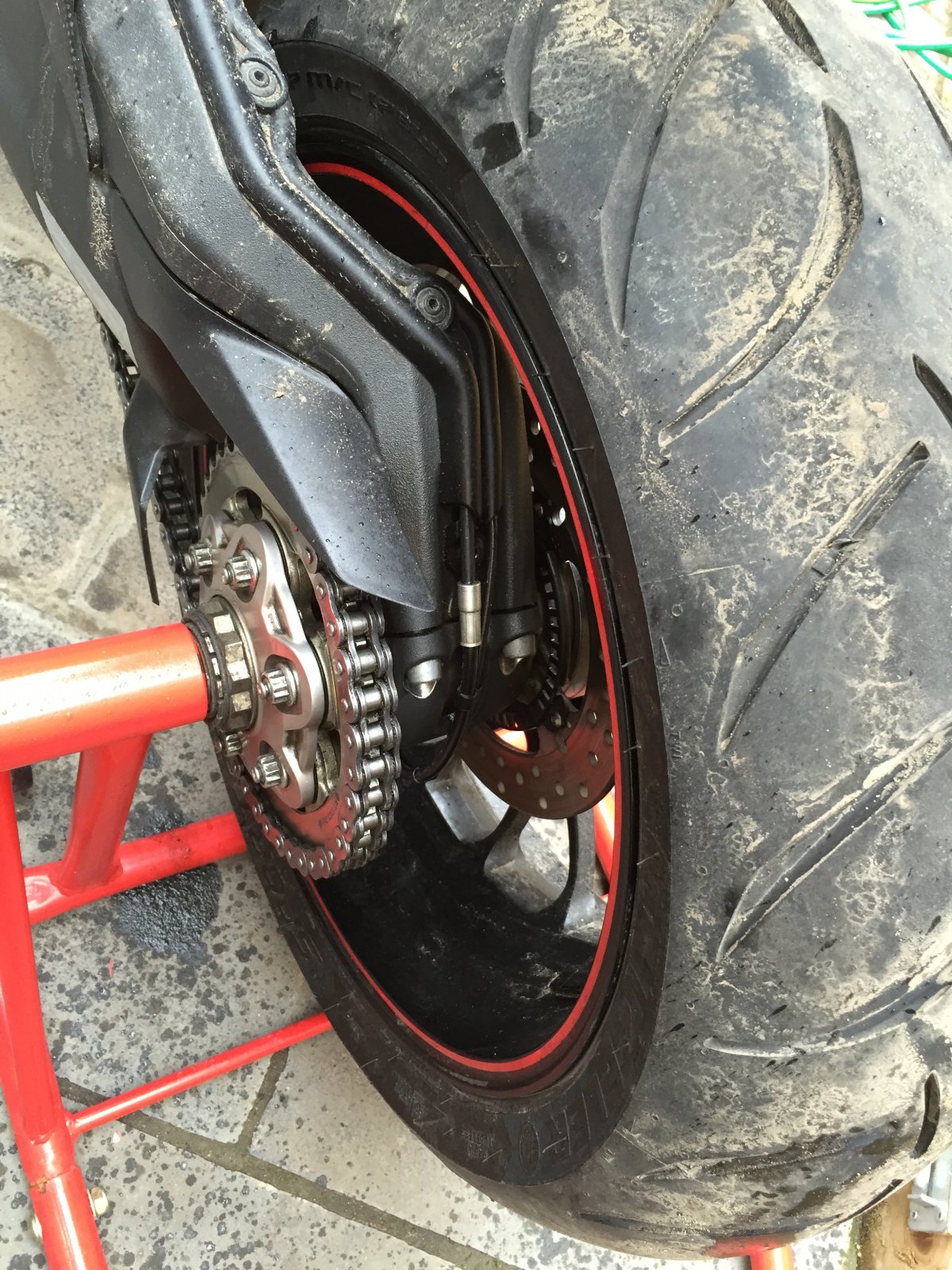

    Believe it or not chain is smothered in lube. Jokes innit. I'm beginning to think it's something to do with the exhaust heat and the lube and the salt. Other bike still sparkling!
    If it wasn't getting changed that would be two hours of my life sorting that shit out.

  8. No substitute for a cleaning regime, you would like to think, but ultimately even a Panigale is built to a budget. The only effective solution is to change the fasteners out for stainless or titanium ones. I appreciate that is not the most cost effective remedy, but it is about the only one that will work in the long term. As for the chain I use a dry chain wax which has always proved successful

    I bought a Renthal gold one and if anyone wants to buy an OEM chain with about 100 miles on it there's one in my garage :p

  14. Just back from work commute on it so the wheels and termis are covered in crud. Look worse due to the thick layers of acf on them though.
  15. Seriously....its not a good advert for someone considering a purchase....
  16. its not just the chain,the cans look the worst ive seen, the sprocket, carrier, nuts, its all wrecked!
