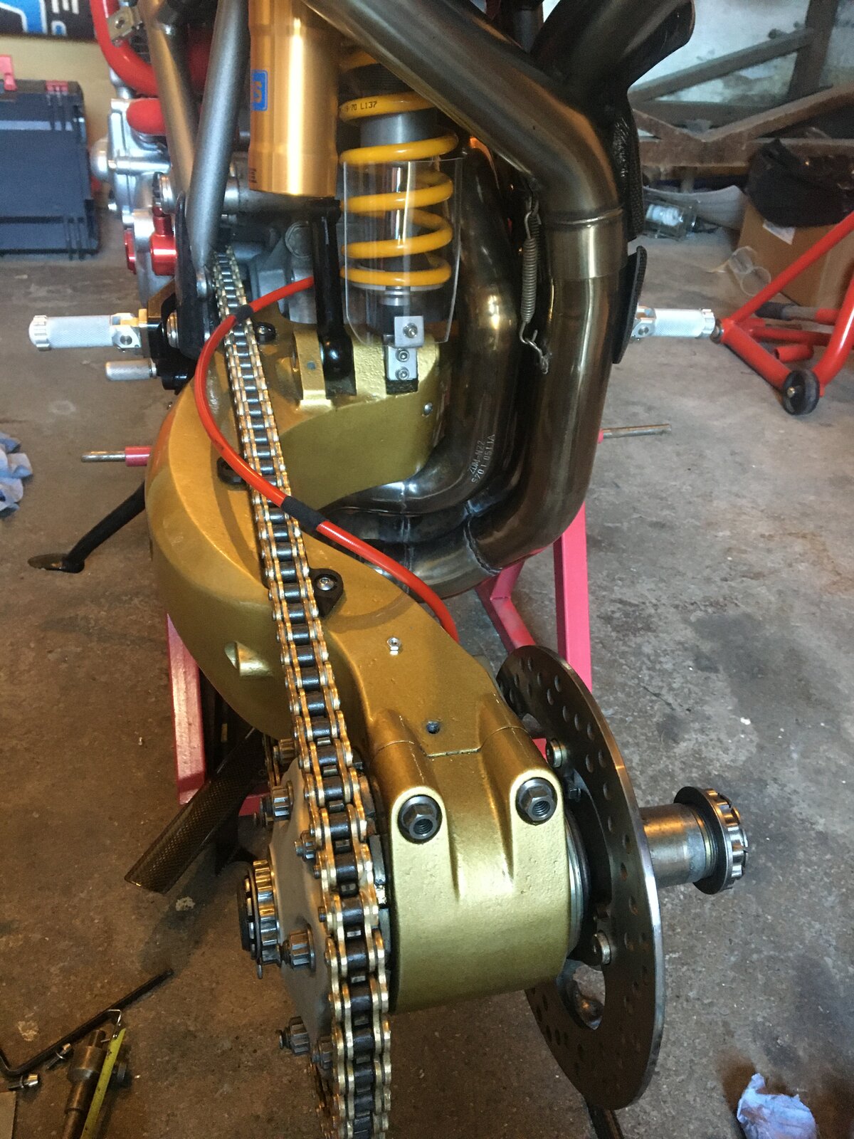

  2. Ian did you have to swing the engine out of the way or did you spring the frame a bit to get the bushes in.
    Steve
  3. 50/50 Steve. I used my engine stand to take the weight. So both wheels off the ground, front engine mount slackened off, one above the swing arm pivot removed and that’s it really. Just rocked the bike forward to make some space.

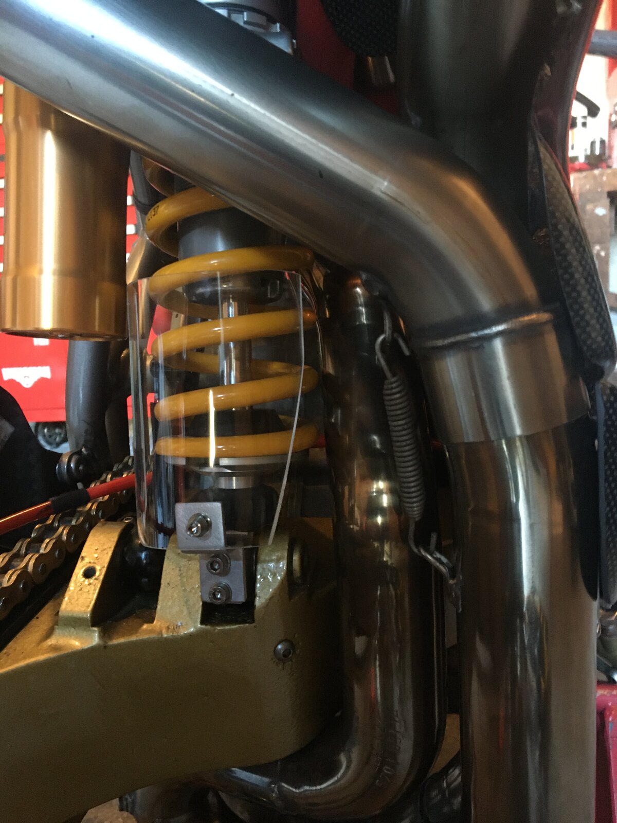

  8. With the mag arm and RS long chain runner, now thinking the back of the bike looks better without the hugger fitted. Not wanting to shag the nice shock, I rattled up a small shock protector. It should help keep it clean.

  9. As a matter of interest will the hugger fit the longer mag swing arm?
    I would think the mounting holes are further apart.
    As usual out standing work :upyeah:
  10. Cheers mate. No, I couldn’t get the hugger to fit unless I cut the rear fixing fin off and made a new one.
    The fixing hole on the right of the swing arm would be out of position too.
    And tbh, I think it looks better without. Might even leave the swing arm cover off...
  11. P.S I saw a DP carbon shock protector pop up on Ebay a few times and I know CM Composite make them also.
    As impressive as the clear protector looks, I suspect chain lube and road haze may drive you nuts. ;):mask:

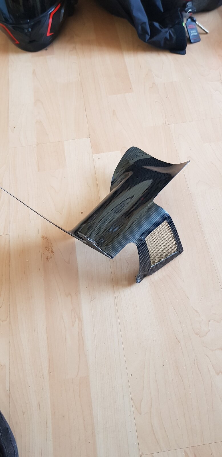

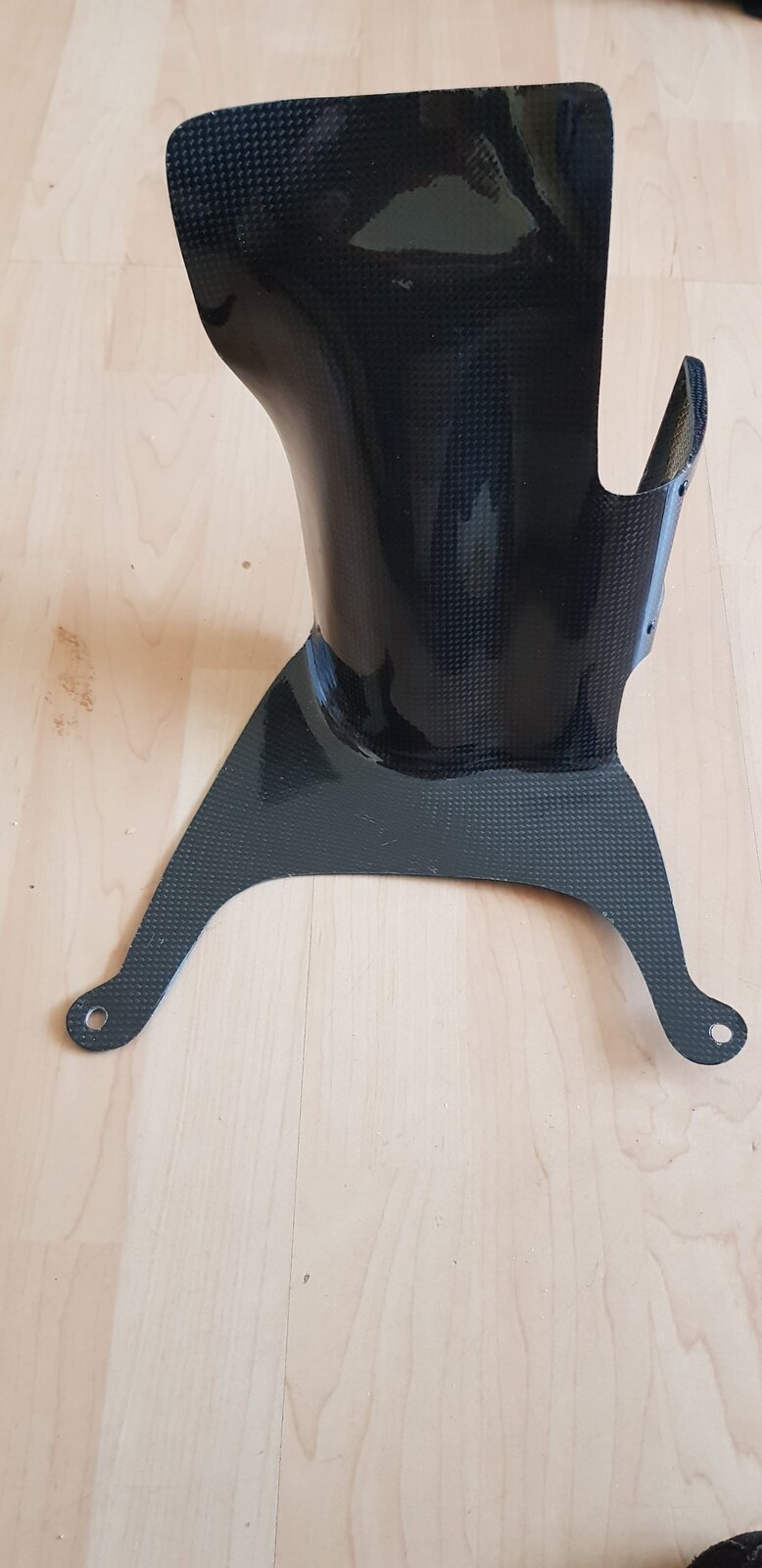

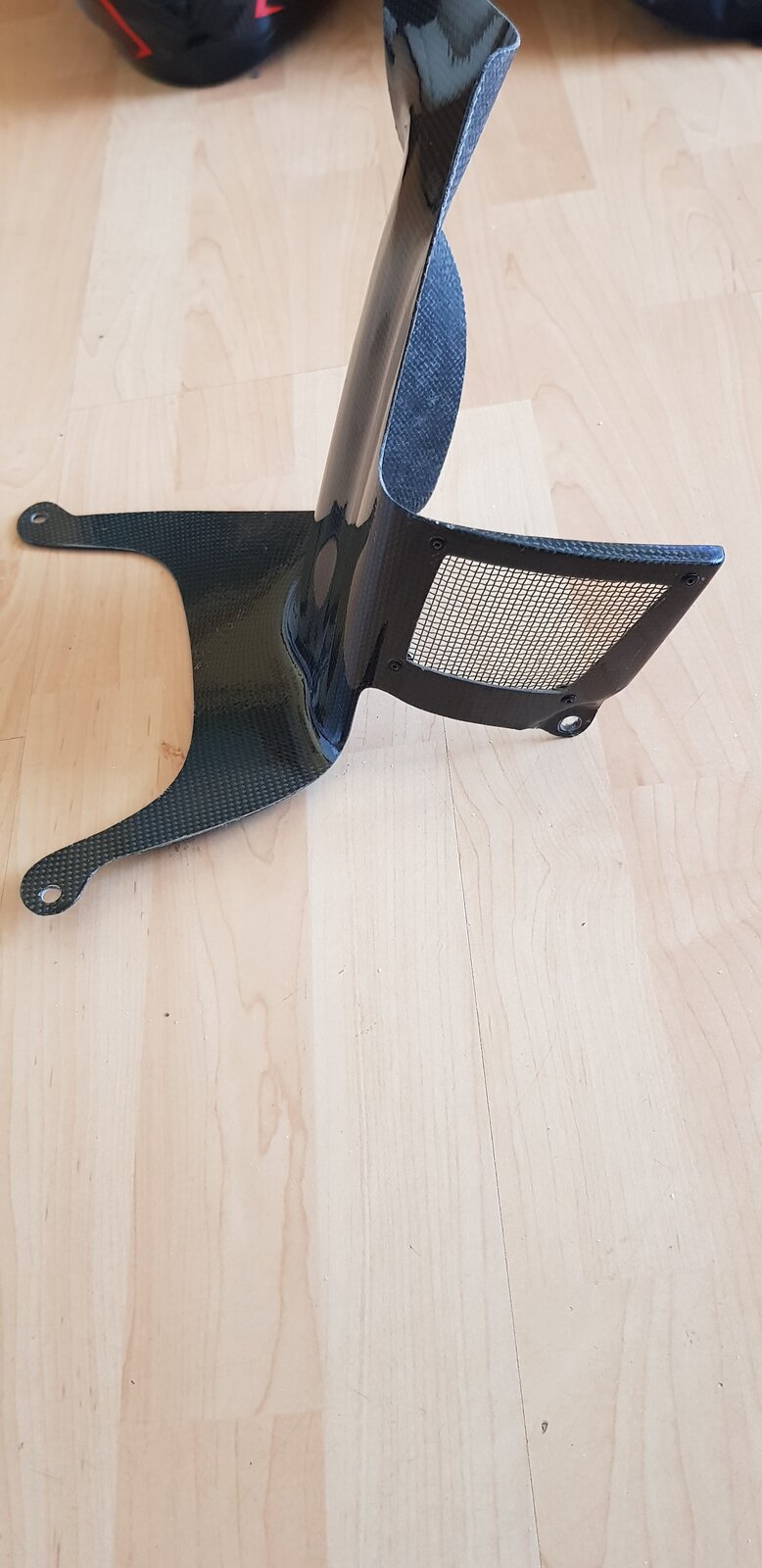

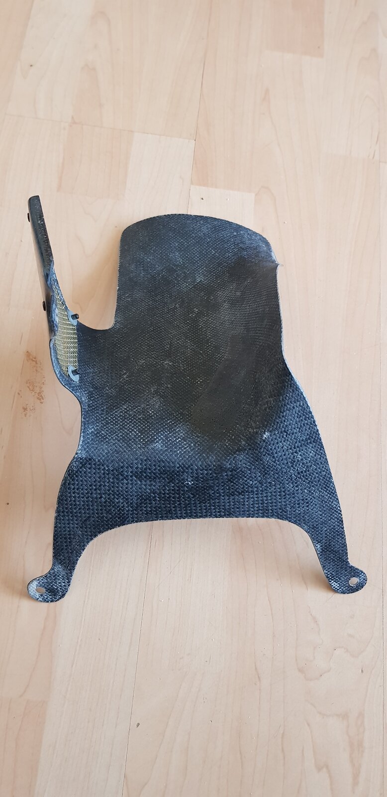

  12. Here's one I bought earlier :D
    20200407_135158.jpg 20200407_135209.jpg 20200407_135221.jpg 20200407_135329.jpg
    Andy
  13. Probably mate! The tube only cost £20 and there’s enough for 4 pieces, so I’ll just change it when it gets too bad. The carbon ones are a good option but wanted to try this first. Thanks. :upyeah:
  14. No idea, came across it whilst tidying up and have no memory of buying it :joy: although I have a vague recollection of posting it here some time ago. Andy

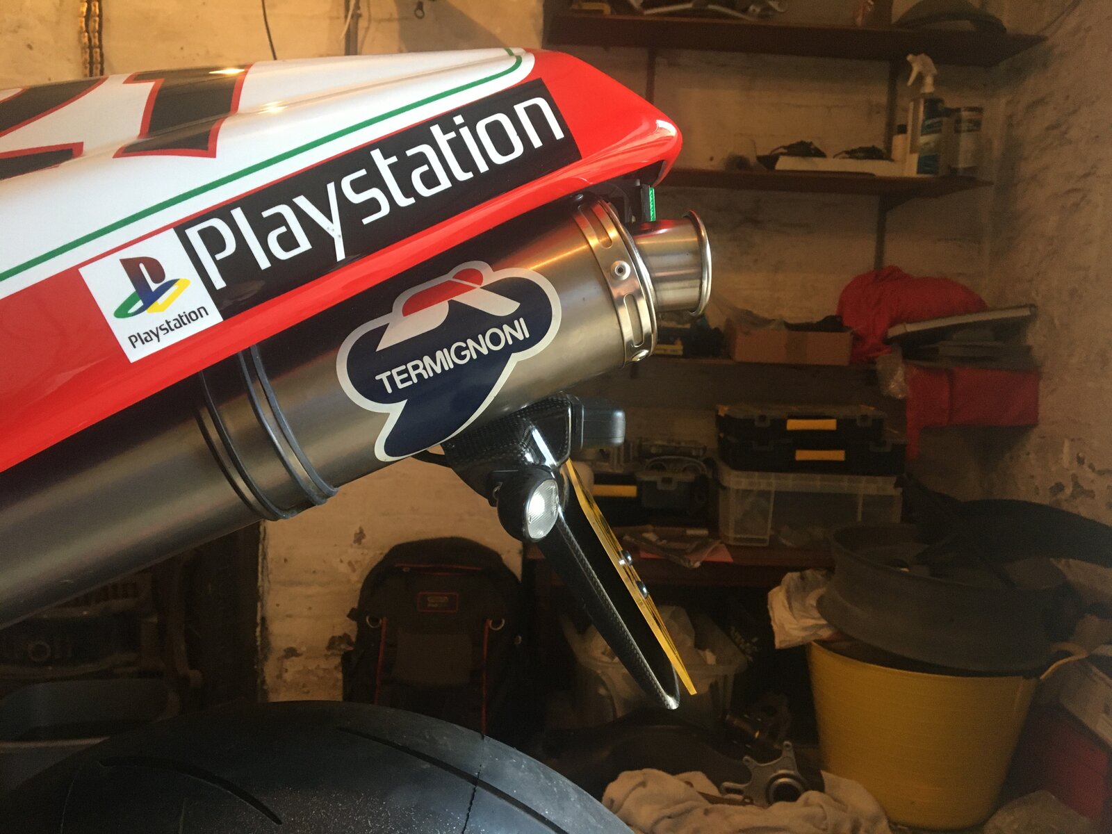

  15. Lockdown boredom kicked in again...
    Re lacquered the swing arm protector and fitted the RS long chain guard.
    Then cracked on with the DP reg plate holder. Tucking the cans right up under the seat unit made the reg plate look too low. Cut the stem just below the fixing triangle bit, cut 15mm out then rejoined the two halves back together.

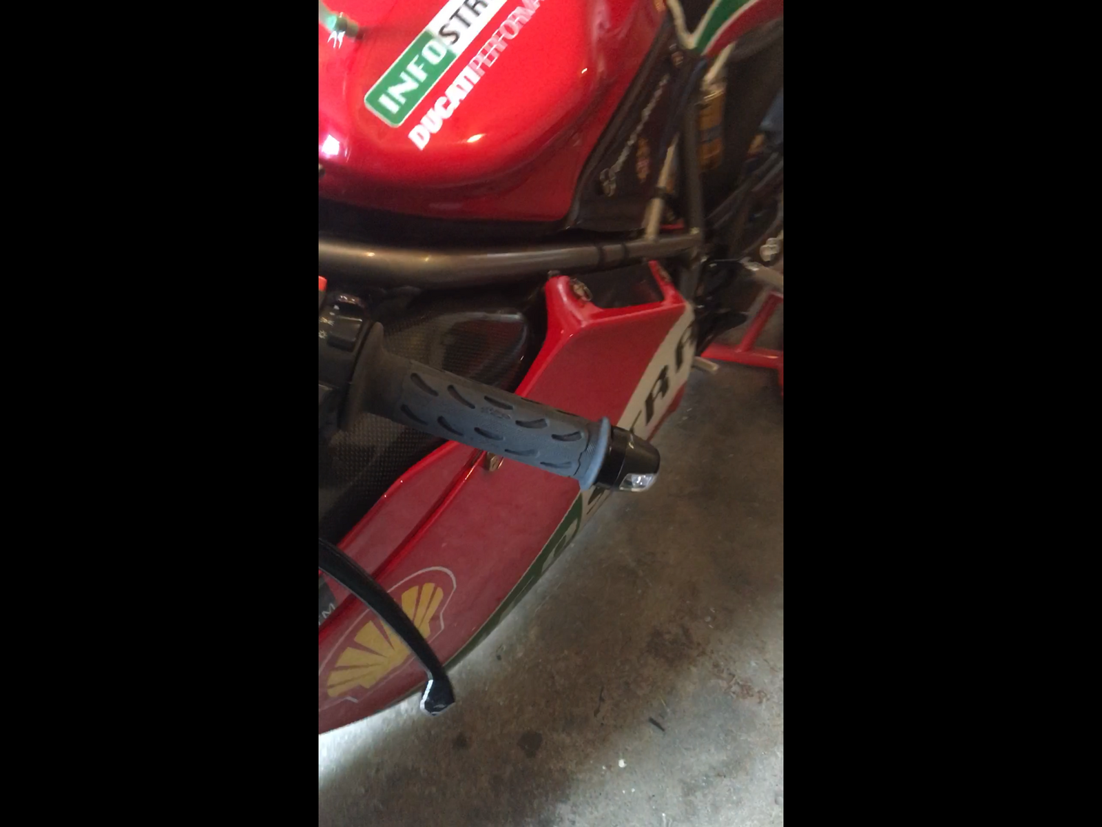

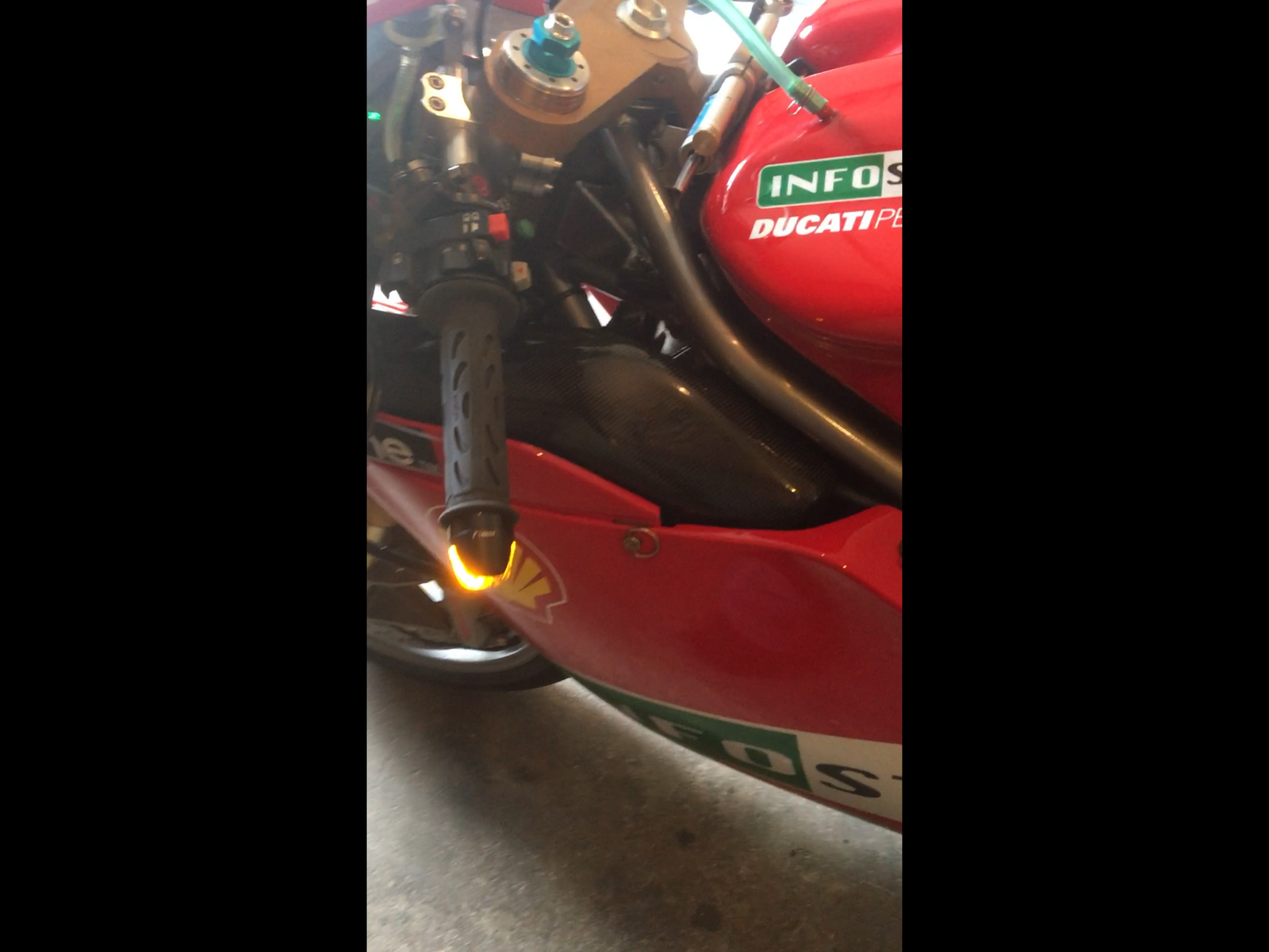

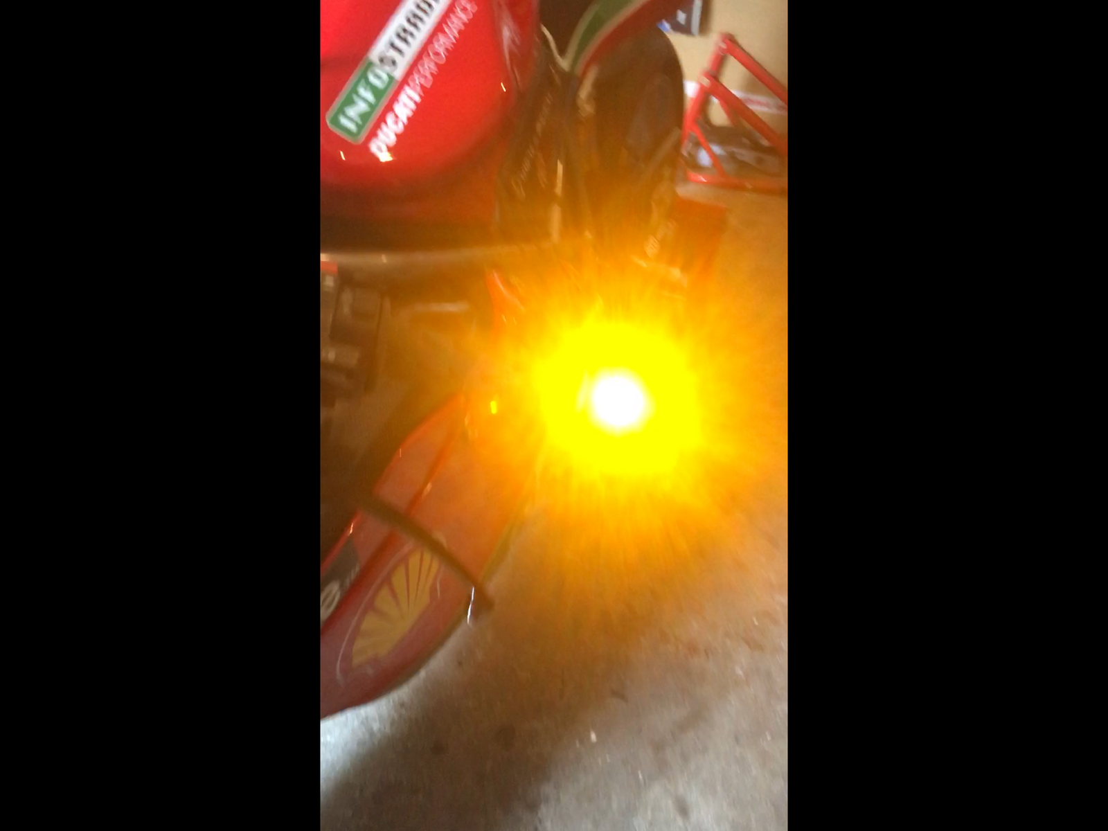

  19. Since fitting the 996RS oversized airtubes I’d been thinking where to stick the front indicators. Went with some Rizoma bar end indicators. Not a big fan of these brands on my bike. Their quality is always spot on, I just don’t like the brand labelling. They are maga bright and don’t stand out when not in use.
