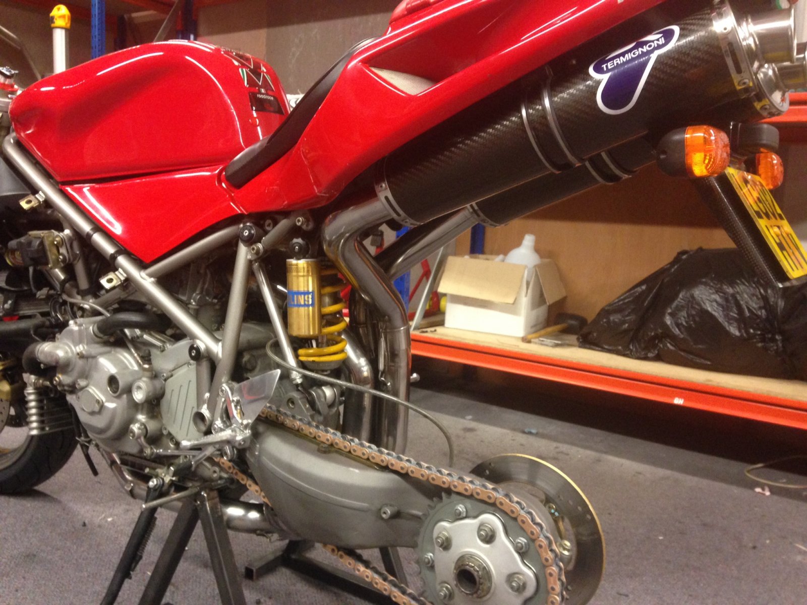

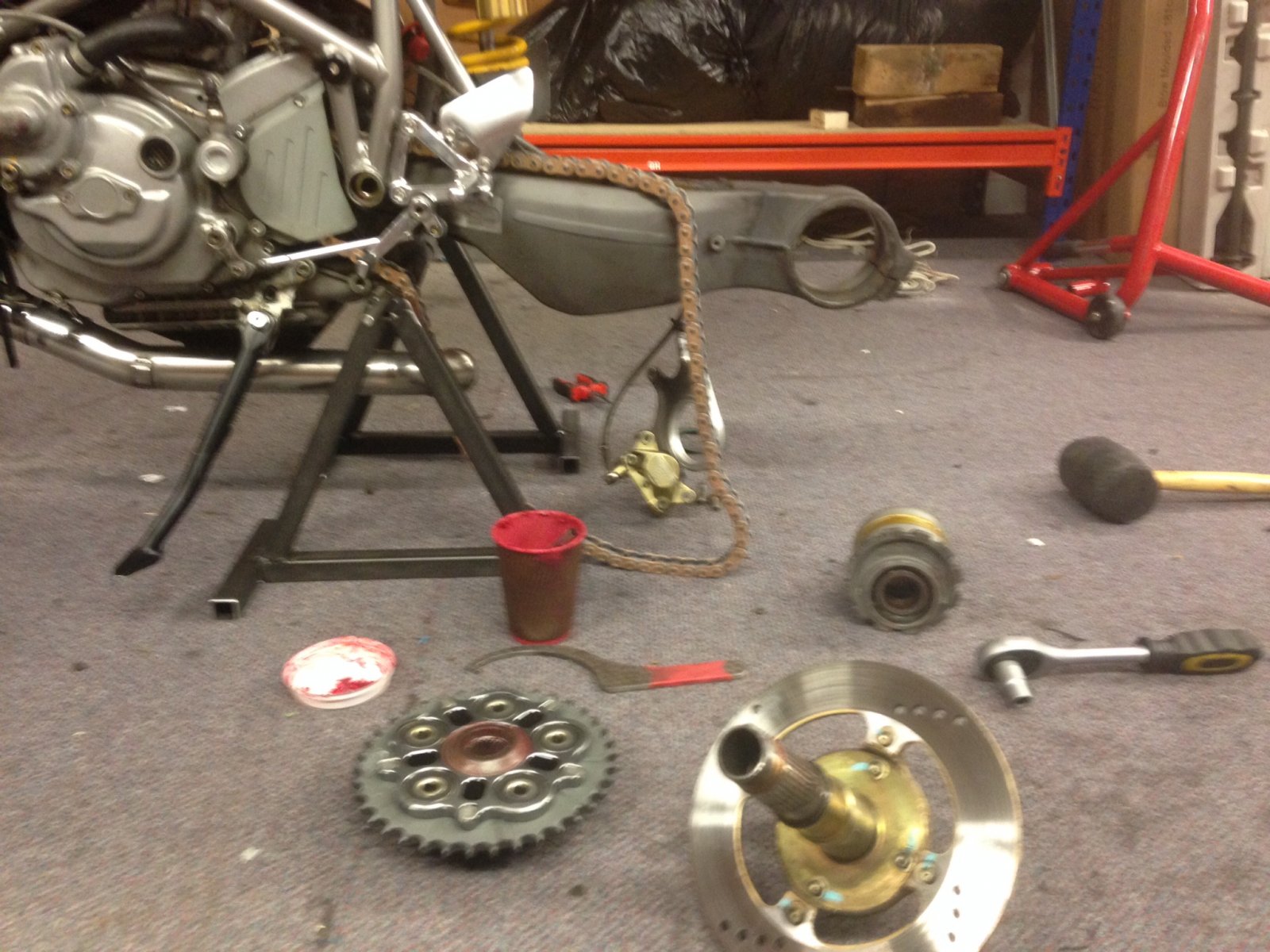

  1. Pipes back on. Rear hub stripped, cleaned, re greased and back on. Swing arm pivot removed, greased and back on. Shock and ride height rod out, cleaned and back on. Found a spare hole to the rear of the engine casing ideal for the stand. Very pleased with the results and little time it took.
  2. Nice, what you clean them up with?
    Think the chain may need a little oil.
    Get a front sprocket cover, the OEM plastic looks cheap (IMO).
  3. Cleaned it carefully with a mild solvent I use at work and a few rags. Hope the chain doesn't need oil mate. It's brand new. :grinning: The white grease on it from new makes it look odd in the photo. Not too sure about changing all these bits. I was planning on keeping it standard ish but with all the polished bits on it now maybe a bit of carbon fibre to break it up a bit. We'll see.

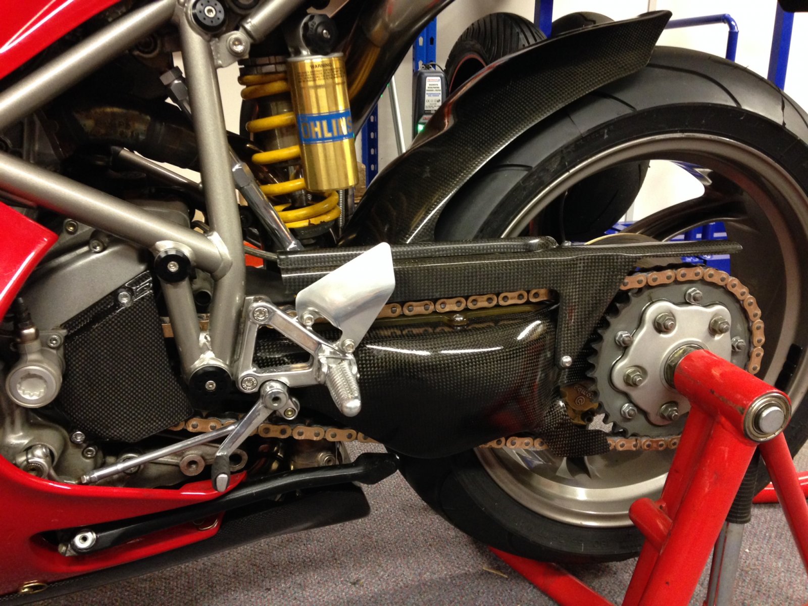

  8. A bit more TLC tonight. I had to go into work anyway so spent an hour fitting the corse dynamics ride height adjuster and carbon swing arm cover. It's a ms production one I picked up for nowt as it came off a crashed bike and the L/H side rear set put a hole in it. Not noticeable when on.
  9. ^Bugger! I'm aster one of those! :Banghead:
  10. The cover or the adjuster? I got the adjuster from @cookster and the cover from a bloke just up the road from where I live in Halifax. He has a shed load of stuff kicking about. Frames with V5s, complete engines, clocks, headlights brand new ecu's. Couldn't believe how much stuff he has. :)

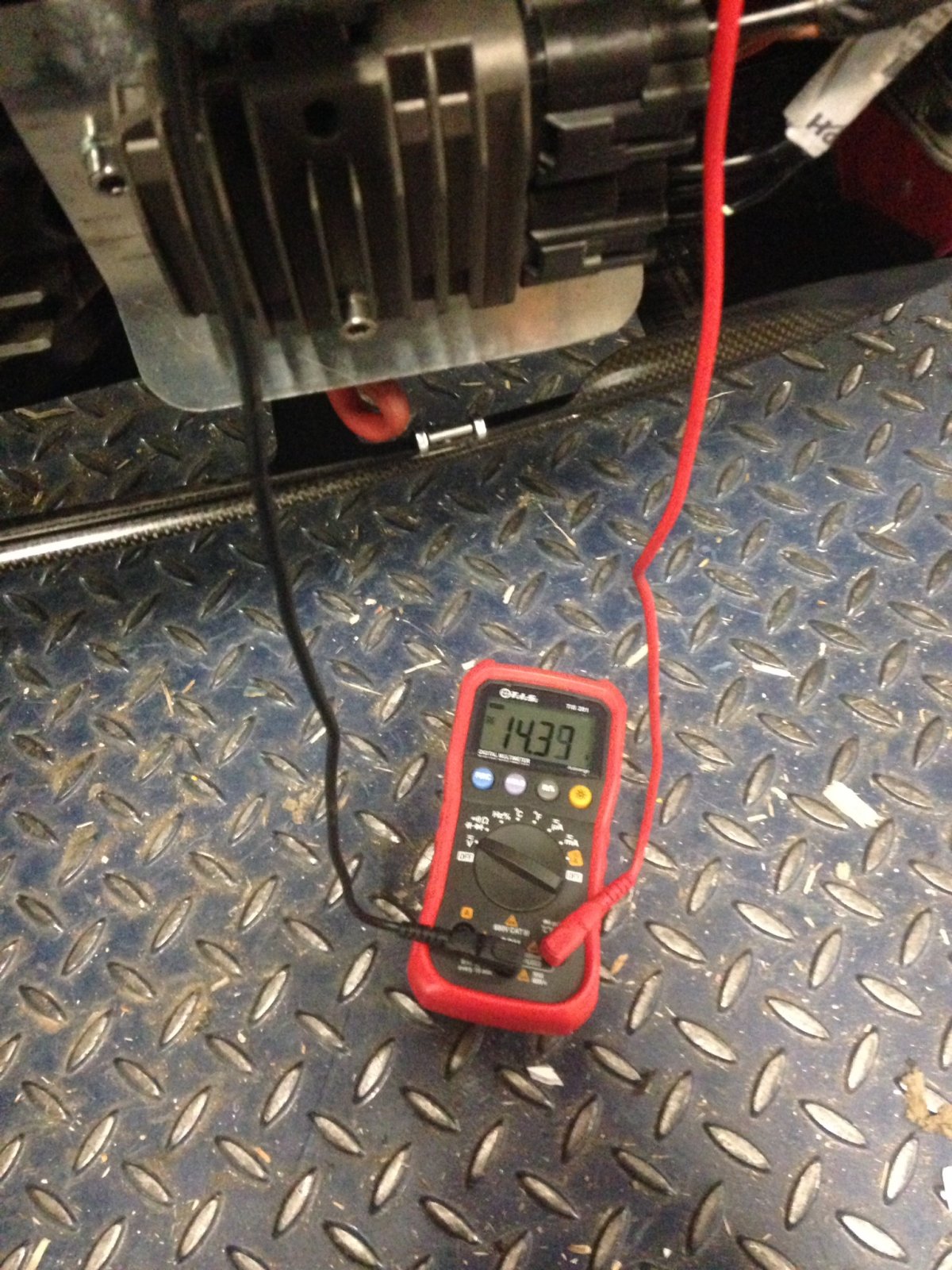

  14. MOSFET R/R fitted today. With the original I was getting 13.8V & now getting 14.3. :)
    12.8V across terminals with ignition off.

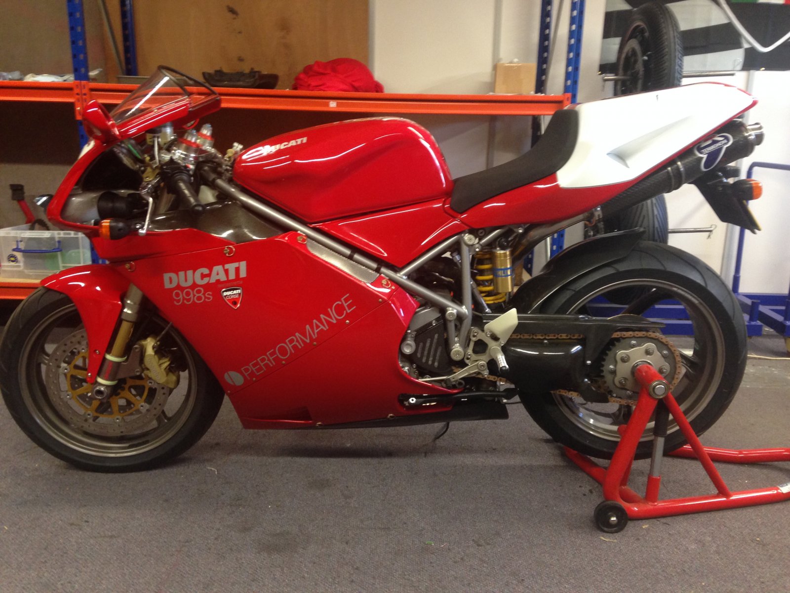

  15. And just about finished. Picked up the monoposto seat unit from the painters this morning. :)
  16. Looking good matey.:upyeah:
  17. Yep, nearly as nice as my Yellow one :Wideyed:
  18. Very nice. Front sprocket cover looking good.[emoji106]
