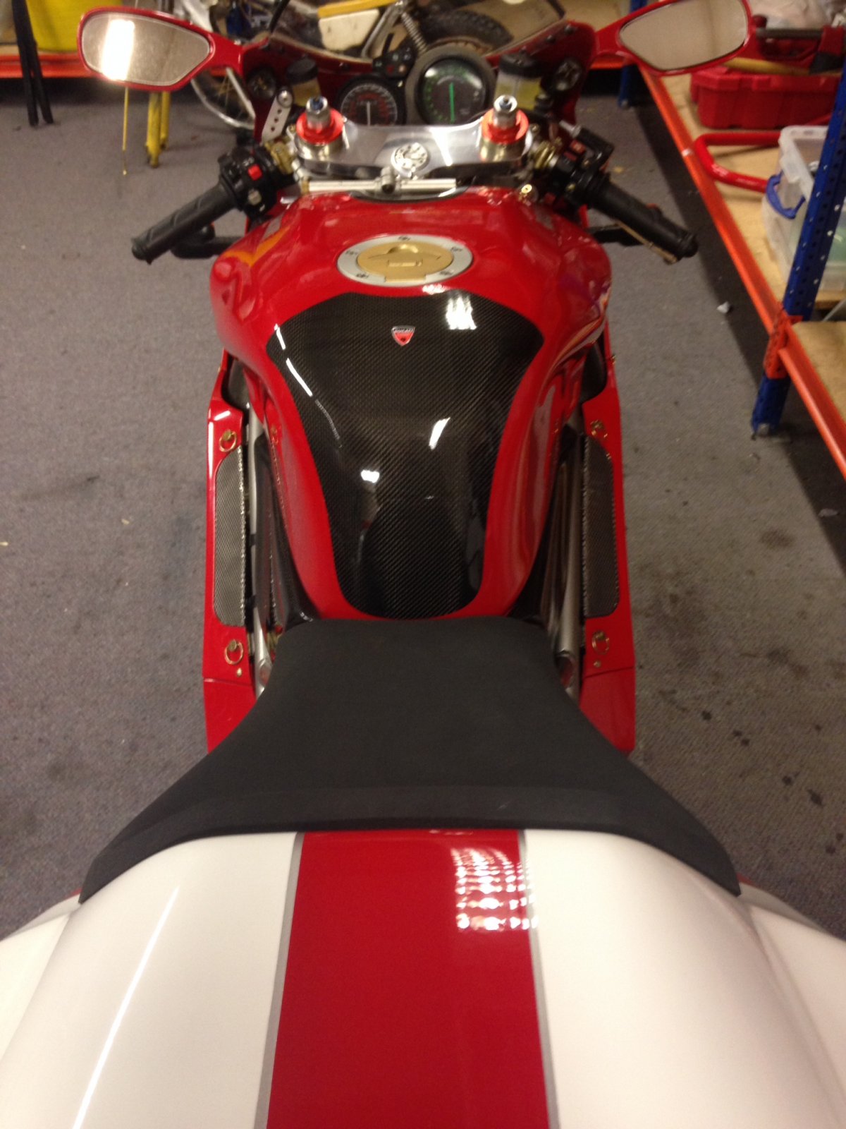

  4. And the work continues...
    Fuel filter changed and while at it, a CF air box.
    Thanks again, Clive. :upyeah:

  6. Was that cookie's airbox?
  7. No mate. Bought it off a bloke in hull. Italia moto or something.
    I think @Tobytyke got cookie's.

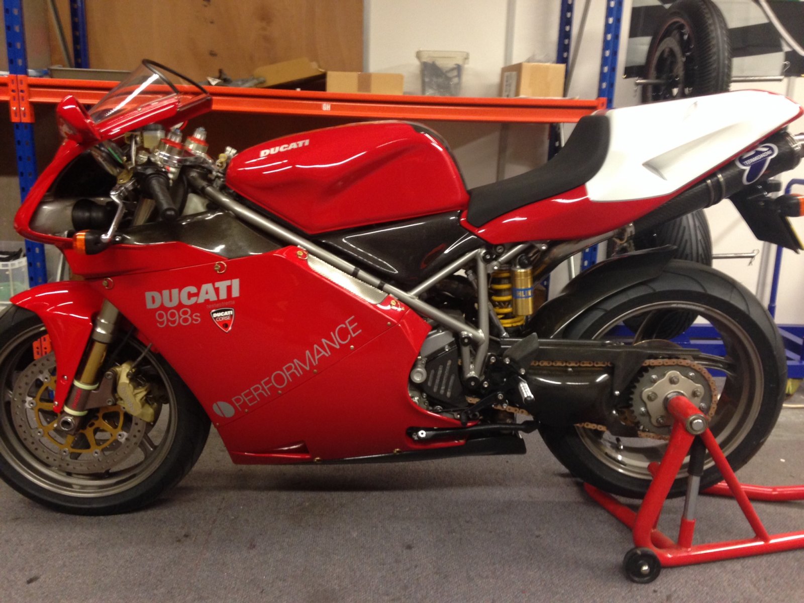

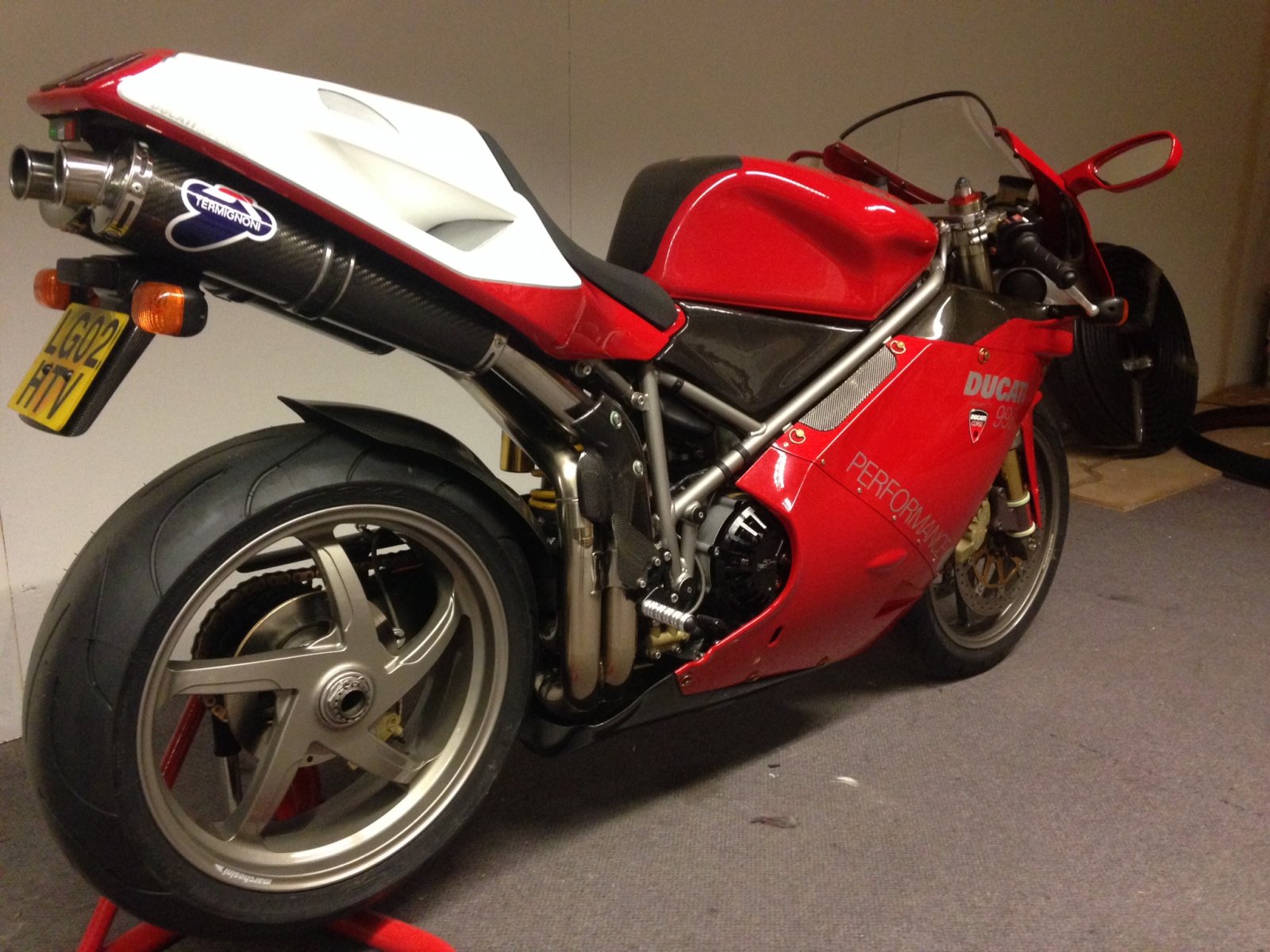

  9. Looks great, what seat pad or foam is that? I like the carbon swing arm cover too!
    Craig
  10. Hi Craig. Thanks for the comments...
    Seat is a tecnosel job. Got a good deal on a new one from a bloke down London, Rosso corse. The swing arm cover is an MS production one I got cheap because the bloke who had it before, binned his 916 and the rear set holed the cover. Fixed it with some resin, re lacquered it and it's difficult to notice where the hole is.
    I got the Harris rear sets off the same bloke's 916. One was a slightly bent. I just put it in a vice and twated it back in line then re painted it.

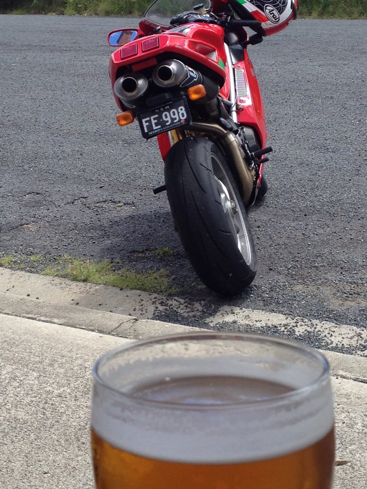

    Like the your reg number!
    Ian
