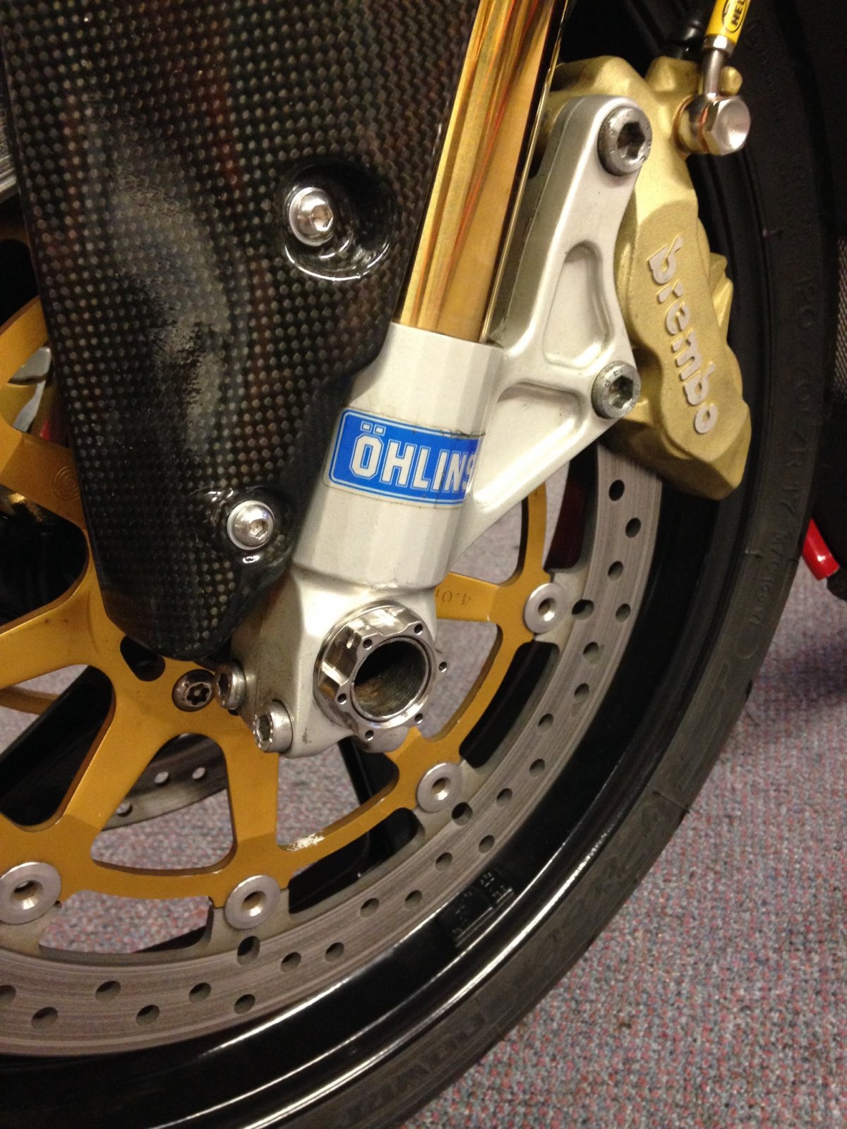

  7. Are those 4 pad calipers on the front brakes? I am considering the upgrade on my 998 and have heard I would need different brake lines.
  8. Hi mate. Yes 4 pad. P4 34 65mm centres. I think they are interchangeable but not sure about the brake lines. And they are good. :upyeah:
    Ian
  9. I fitted them to my 916, they need new brake lines.
  10. Do you remember what you went with?
  11. New brake lines are required as the P4\34 calipers have cranked ends at the caliper end. You could use the 748R\998S crossover style line but any non standard kit will have two separate lines which is said to be better and required for racing I believe.
    I used HEL lines when I fitted them to my 748R engined 748S but found that the unions at the top (master cylinder) are angled at 90 degrees which is a bit odd and they tend to slightly block the view of the temperature gauge. They work perfectly though and the conversion is worthwhile.
    Do not use cheap pads though as they can fade even with moderately hard braking. I had brand new Goldfren pads supplied with my calipers when I bought mine and they were diabolic.

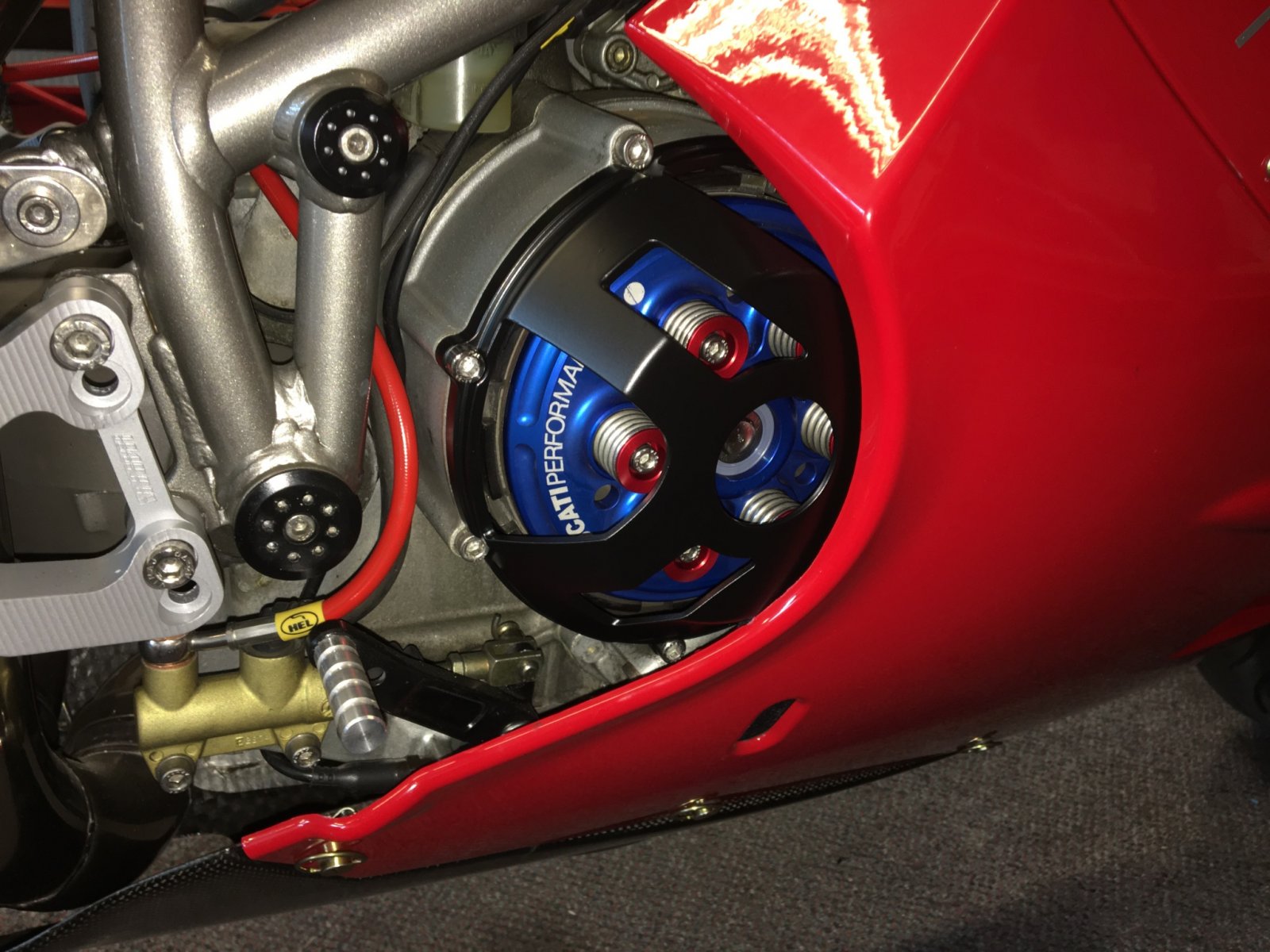

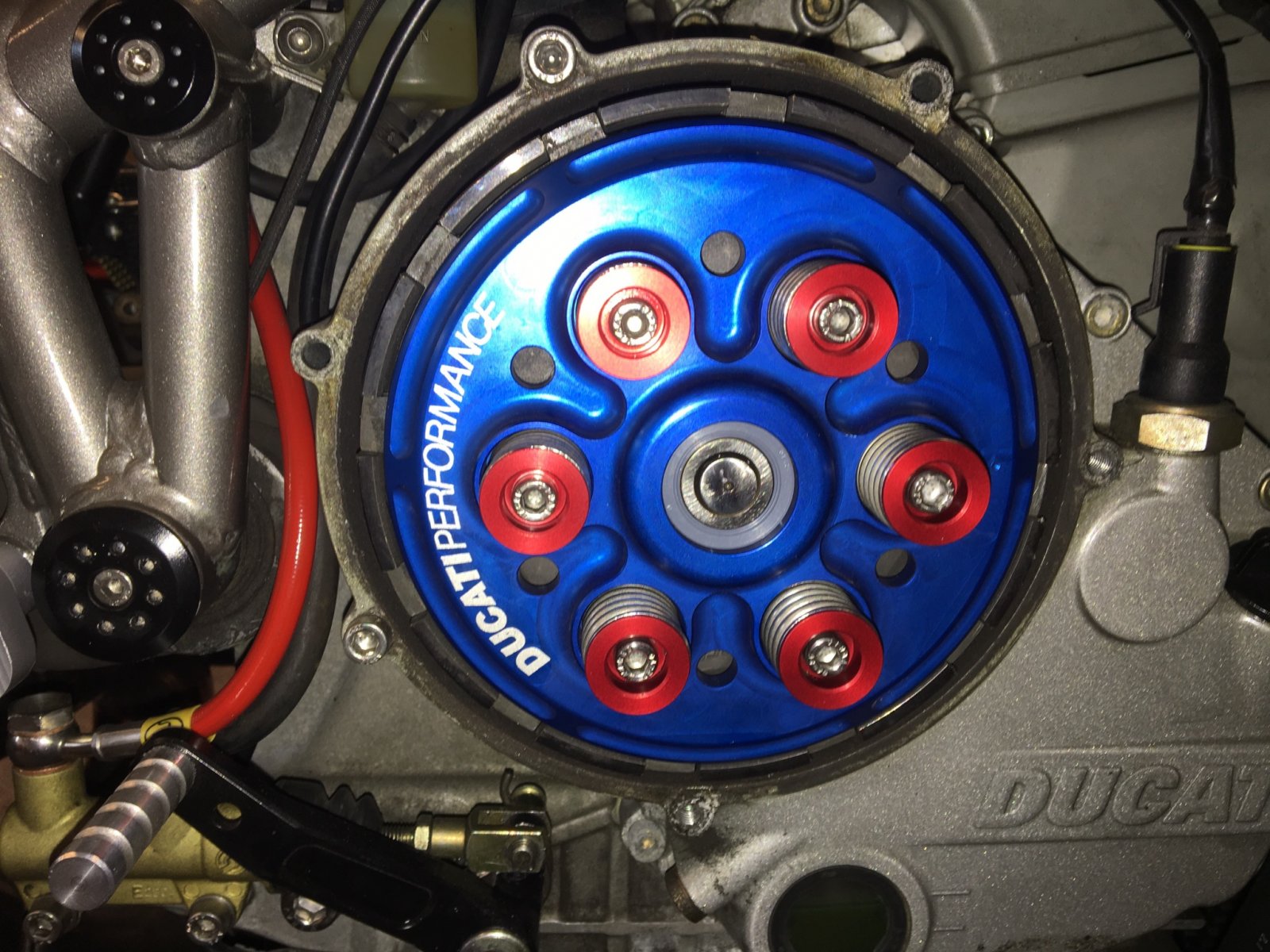

    Clutch sorted.

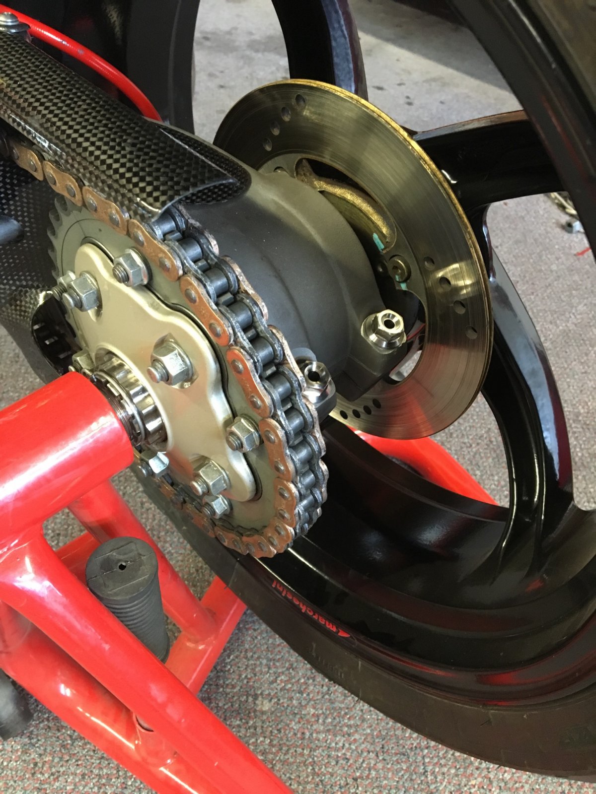

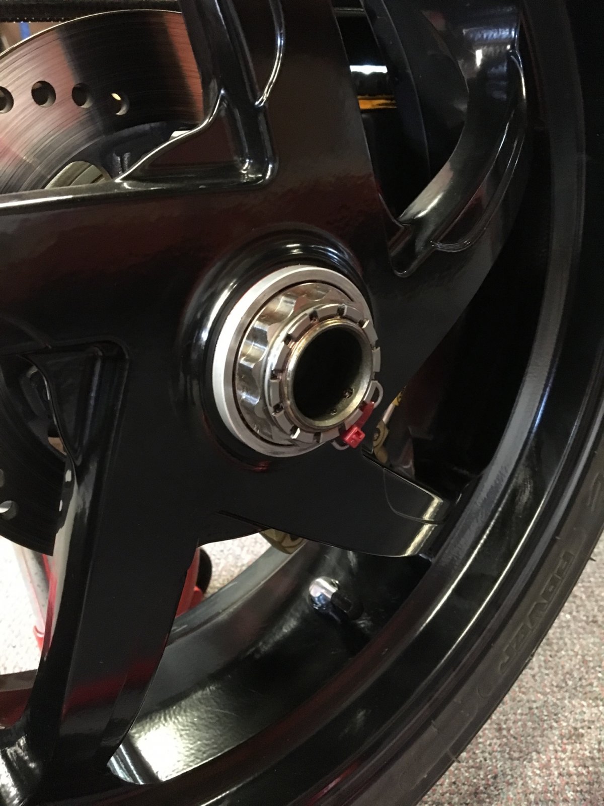

  13. And a few Ti bolts...
  14. Im sure i saw a bit of dirt :upyeah:
  15. That's tomorrow's job while at work. :upyeah:
  16. Great looking bike.
  17. Hi Andy. The front pinch bolts are just polished stainless. I got the rear hub pinch bolts off fleabay for a tenner. Got the axle nuts from podium racing in the states. Works out cheaper than buying them over here and no duty taxes to pay. Just ordered the sprocket carrier and sprocket flange nuts of them too.
  18. Sound. Been thinking about replacing front axle pinch bolts. Hesitant to swap out calliper mounting bolts due to the shear stress involved. Rear hub pinch bolts look great, I got my rear sets from podium, pretty fast delivery from them.
