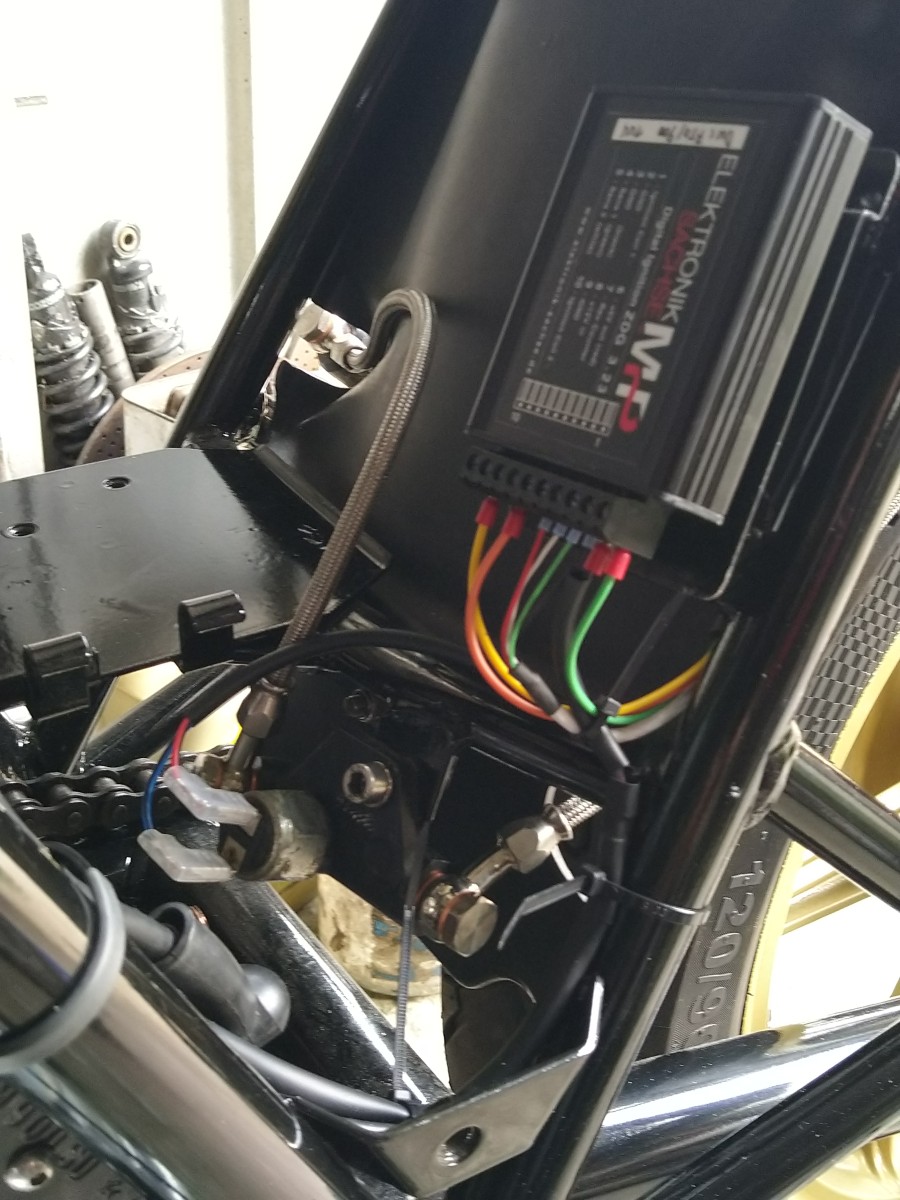

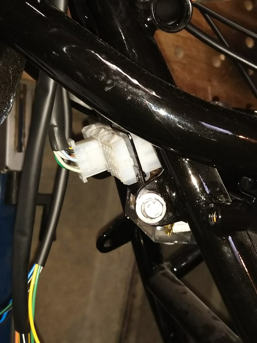

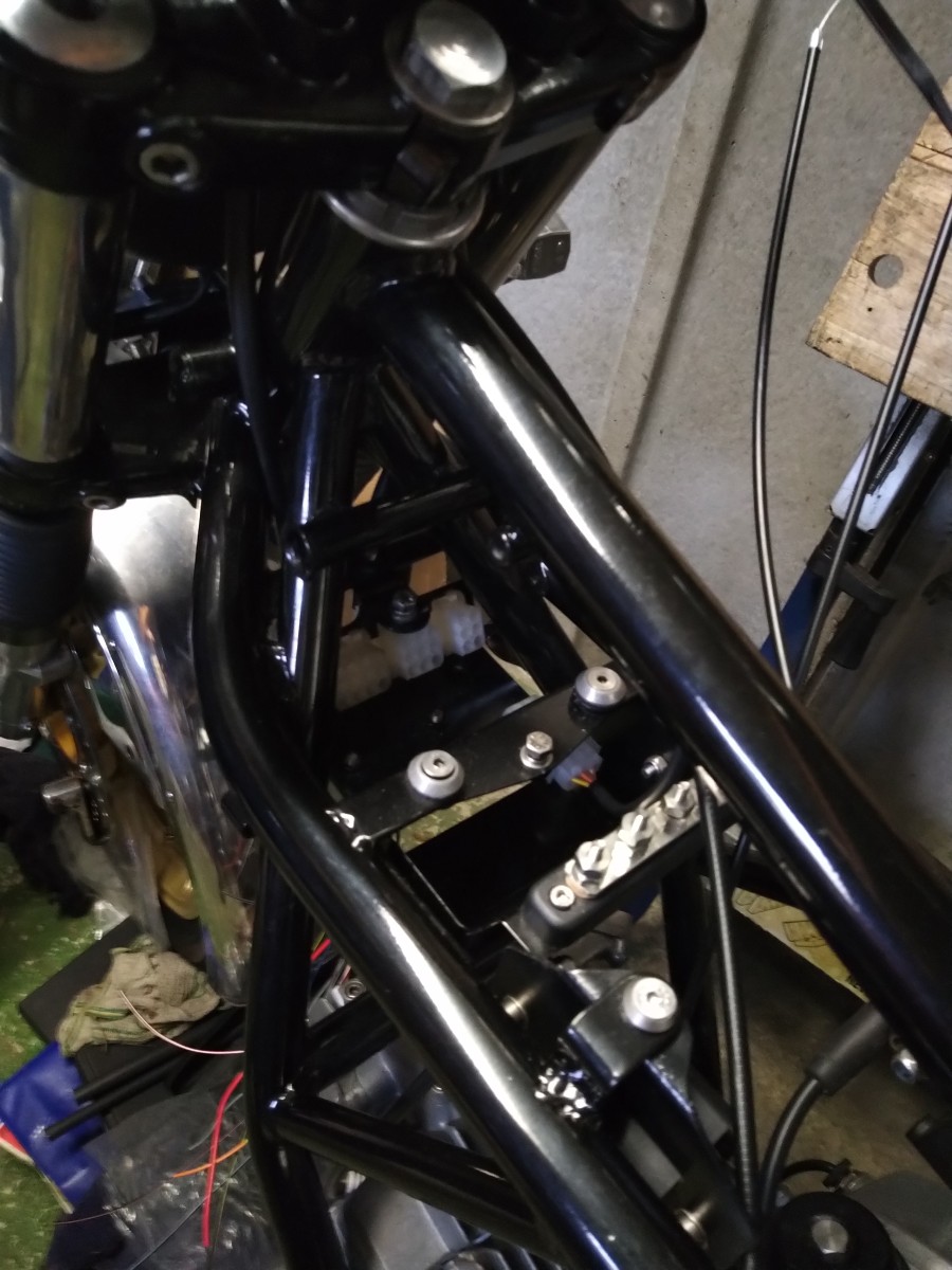

    As mentioned I completely rewired the bike because the standard loom was awful with it all been crammed into the small space behind the headstock. I kept the loom placement pretty much the same but gave it a lot more space by junking the air filter boxes.

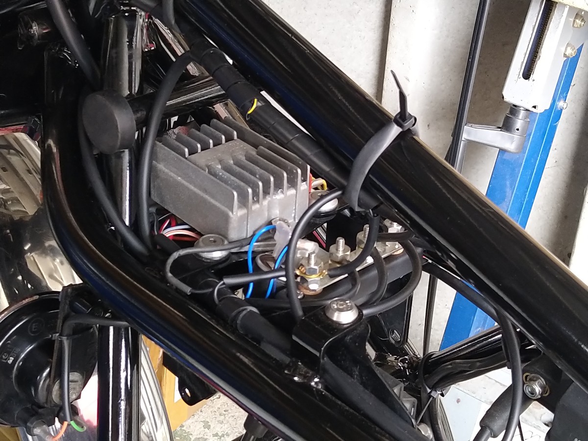

    I fashioned a new block connector plate (and kept the same number & type of blocks) and in the extra space fashioned another metal box for holding the wire slack, flasher unit etc plus you may also notice a bus bar. I used this for the bikes earth and ran all earths back to this as it saves having to scratch frames etc to get a decent earth.
    The loss of the air filter box allowed it's mounting lugs to be used for the coils
    And I'm not sure what ignition system your engine builder is thinking of using but I installed an Electronik Sachse unit was mounted on the rear air filter brackets

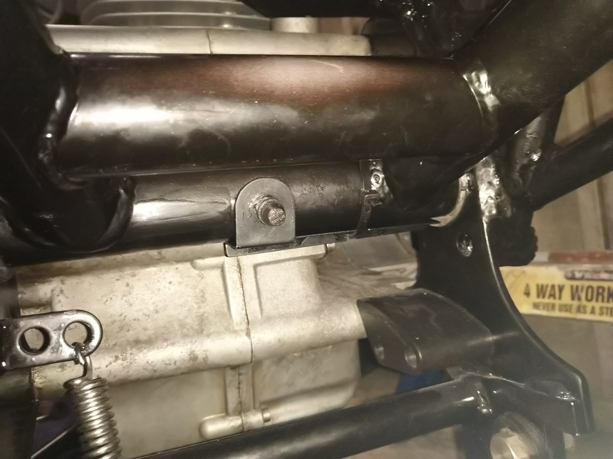

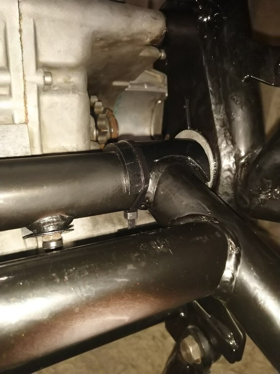

  5. One other issue I can think of is the drive chain cutting into the swingarm & engine casing. There are mounting points in the frame for an off the shelf protector that sits underneath the swingarm and protects the casing but there is none available for protecting the swingarm. There is one available for the SS swingarm but as this differs from the Darmah I made my own up from a bought tube of some sort of tough plastic - I forgot what it was.
    To lessen this it is wise to have the swingarm pivot on the eccentric at the bottom as this drops the top of the swingarm out of the way of the chain.
