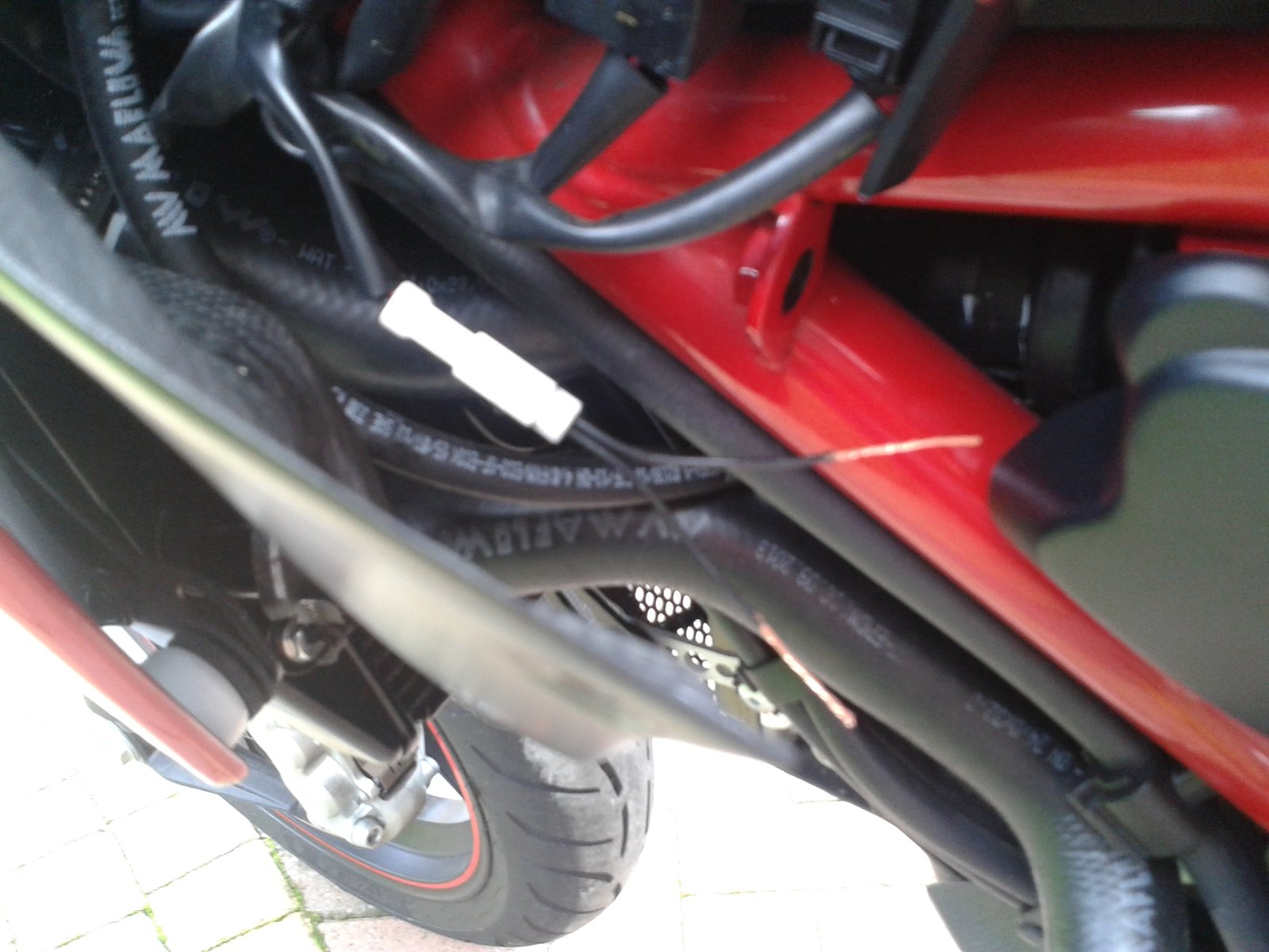

    Or, you could just wire it to the official Ducati accessory plug? ;)

  4. Well I have decided now to put it in the accessory plug as the advice has been said (when am not working) but I did say that what ive done on my 749 (directed to the battery) and its been like that for the pass 5-6 years or so with no problems...

  8. Chargers contain things like transformers, that create a small draw even when not charging. Manufacturers have been told to get this draw lower that 1 watt for "green" purposes. That's still a drain on the battery though. That's why we wire to switched live.

  14. Well thanks to JH... Just waiting on the 12v USB adapter like suggested

  16. I think you should start this thread again. How do i connect sat nav, Oh theres a little white plug to the left under fairing panel that Ducati kindly put there. Oh thanks for that. End. By the way the Garmin zumo, when you sw off ignition goes to sleep after 15 seconds. Let it or if you switch it off yourself you may loose the destination. When you put ign back on just agree to terms on screen & ride off. Back to destination. My mate kept switching his off & lost everything each time.
