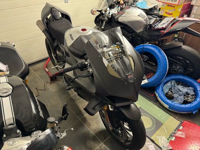

  4. Finally got the new bike ready for track. Most this weekend for 3 days and then Brno a couple of weeks later for 3 days. 6 other 3-day events through the year to look forward to.
    I’m going to try V02 slicks and have them on the mag wheels ready to go but I’ll probably just use the SP tyres on OEM wheels for the first day. It’s intensive tuition - all day every day - and they usually want you to ride at 80-90% so you can concentrate on technique. I’ll try the slicks if the instructor reckons I’ll be ok on them.
    The garage needs a tidy up but that can wait.
    I tried to fit Extreme Components 15mm clip-ons but there wasn’t enough slack on the OEM brake lines. I’ll order some with more offset and hopefully they will be ok. I want them a bit wider and I’ve also got Jetprime switches and QA throttle to go on, along with a CNC 19x18 master cylinder that I want to try based on many recommendations (if it’s no good then it will be perfect on the build I’m doing on my SportClassic Monoposto.

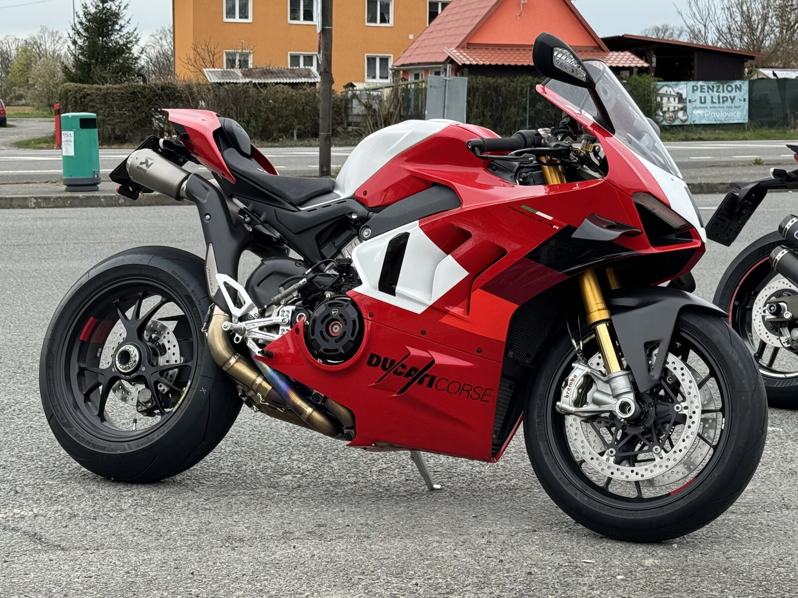

  5. Just finished a great weekend at Most. It’s such a fun circuit.
    First time on track with the R and I’m so glad I got it. I had checked the coolant (as the dealer didn’t bother when they did the first service) and set it to the low marker. Three days on track and it’s still exactly on the low marker.
    8 seconds better than the first time I went to Most but I don’t see any problem getting a few more seconds off that with a clear track and I understand where to improve further and how to do it - all I have to do is actually do it, but I’m happy with small steps. I feel like I’m starting to make progress in terms of technique and the last session was great fun. No dramas or issues and no scary moments. It feels like there’s plenty of time to come off the laps before I’ll start to be pushing past my comfort zone, but I’m happy to make consistent small steps to let me focus on technique rather than pushing too hard before my technique is good enough.

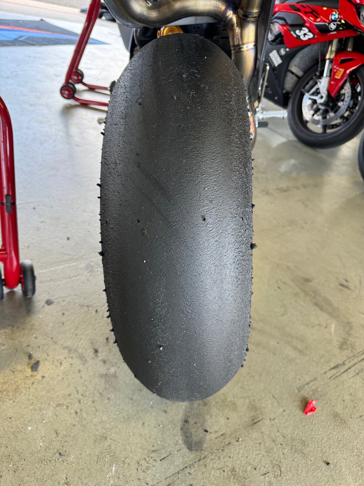

    First time on slicks as well and I went with V02. Really glad I tried them and I won’t be going back.
    If any tyre whisperers (with actual experience) want to read the tyre wear then feel free. I don’t think it was too bad. It looked smoother all over the tyre before the last session, where I got held up in the corners during the last couple of laps or so.
    Absolutely loving this bike and being on track. Brno in a couple of weeks. :upyeah:

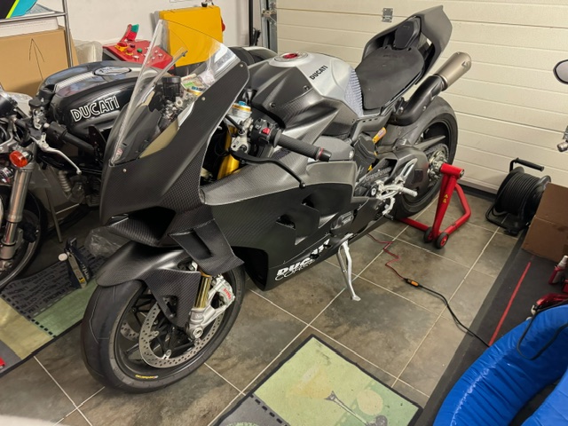

    Pierobon rear subframe fitted. I like the look and it’s nice to see more of the engine.

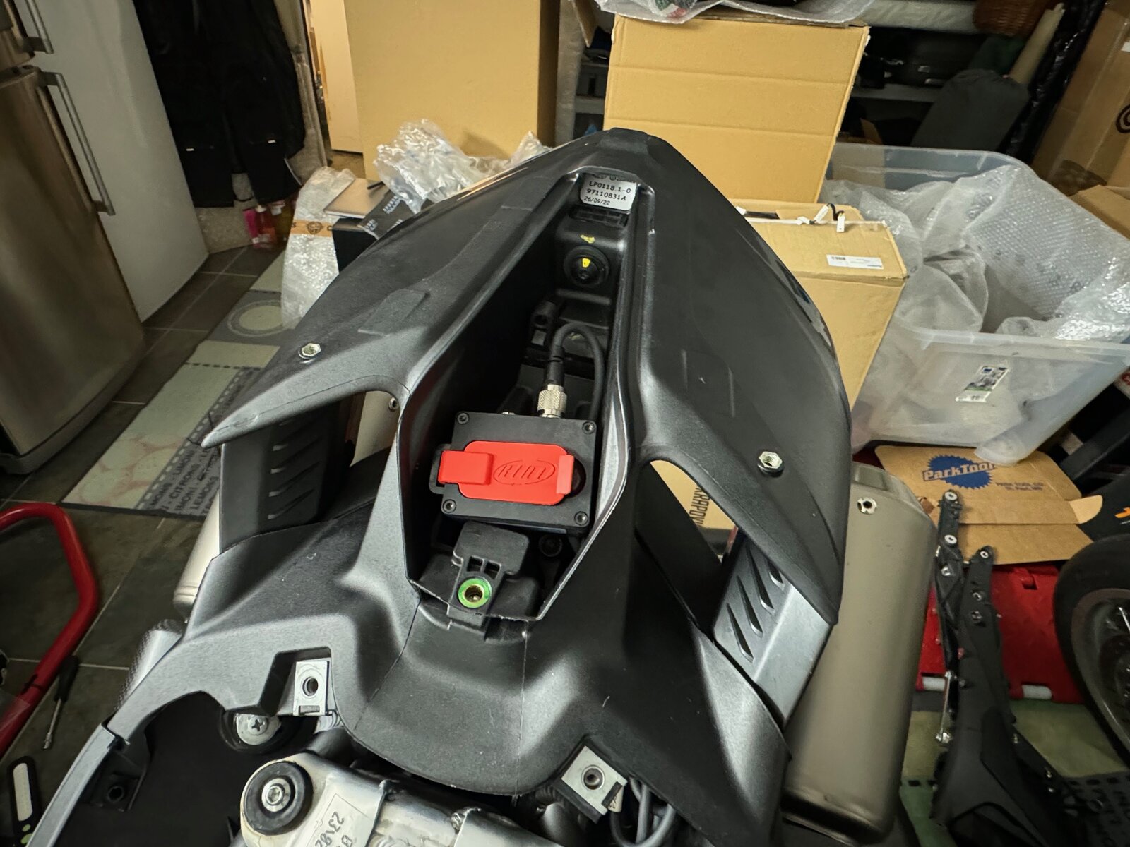

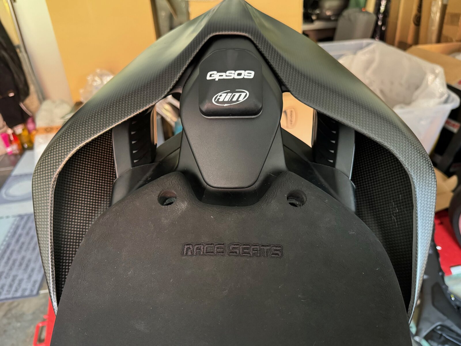

    The new AiM ECU-L data logger has been installed - basically like a Solo 2 DL without the screen. It fits very neatly into the tail unit. I used a roof-mount GPS and incorporated it into the cover. Easy to access, aside from the key being a pain to get into the lock in the lower tail unit due to the Akrapovic…
