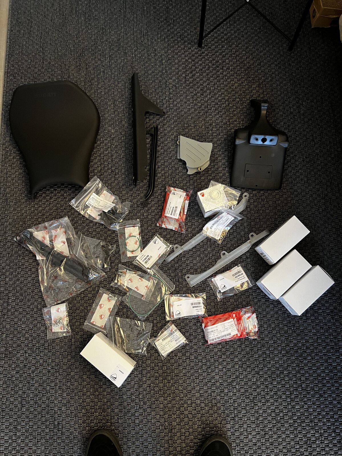

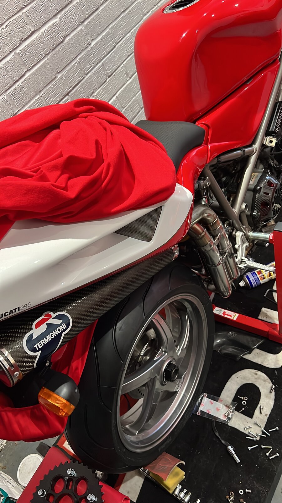

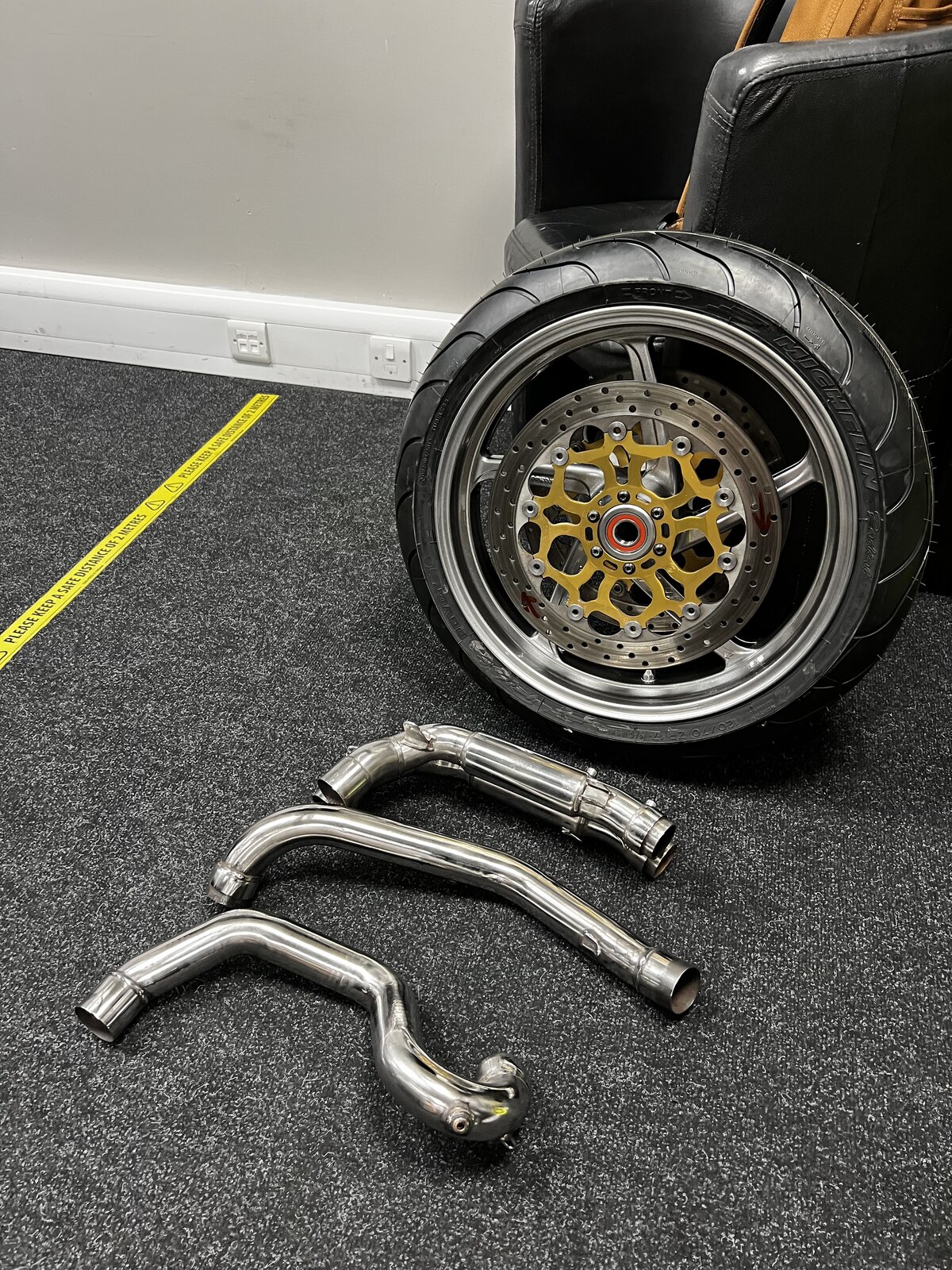

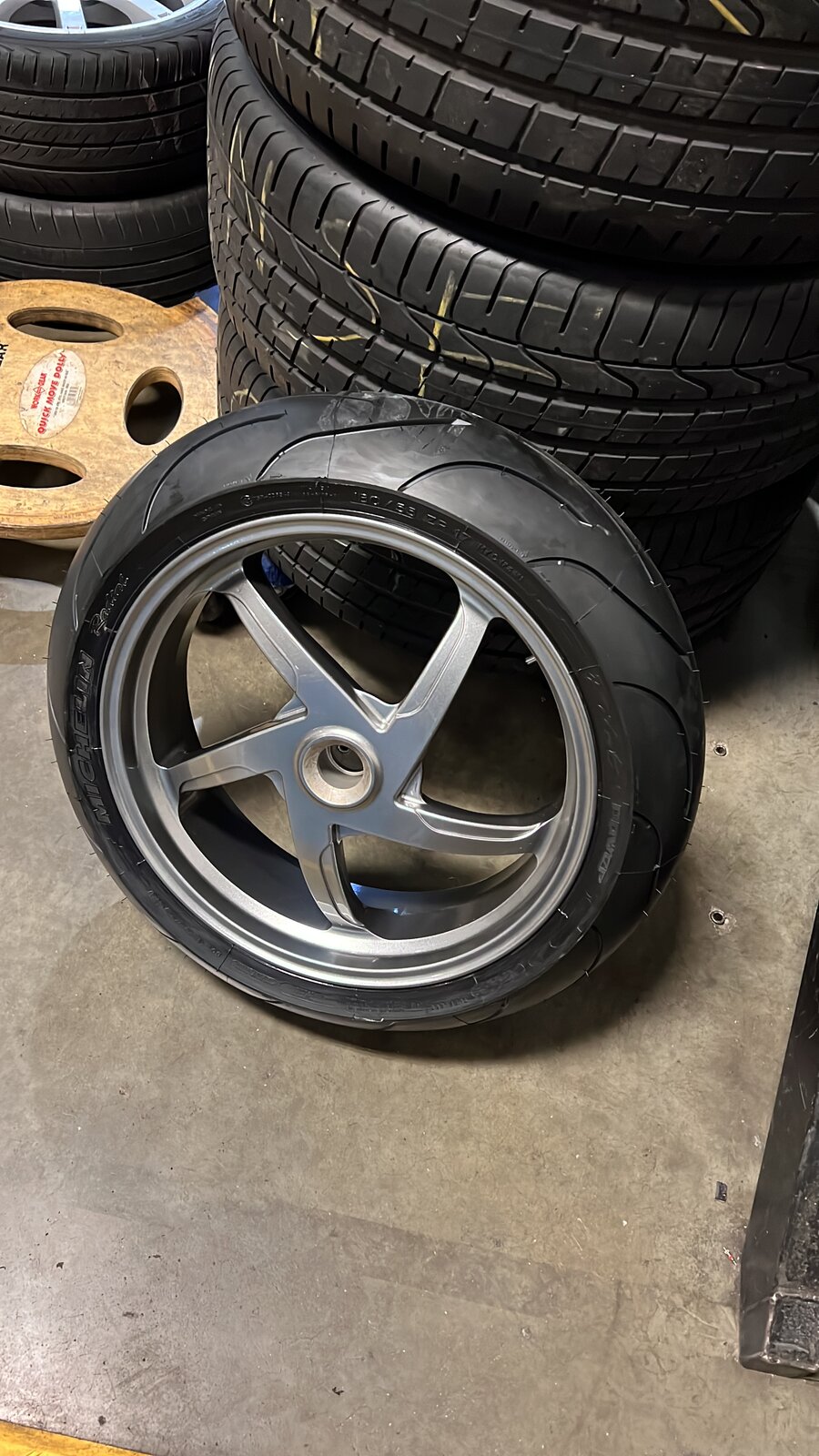

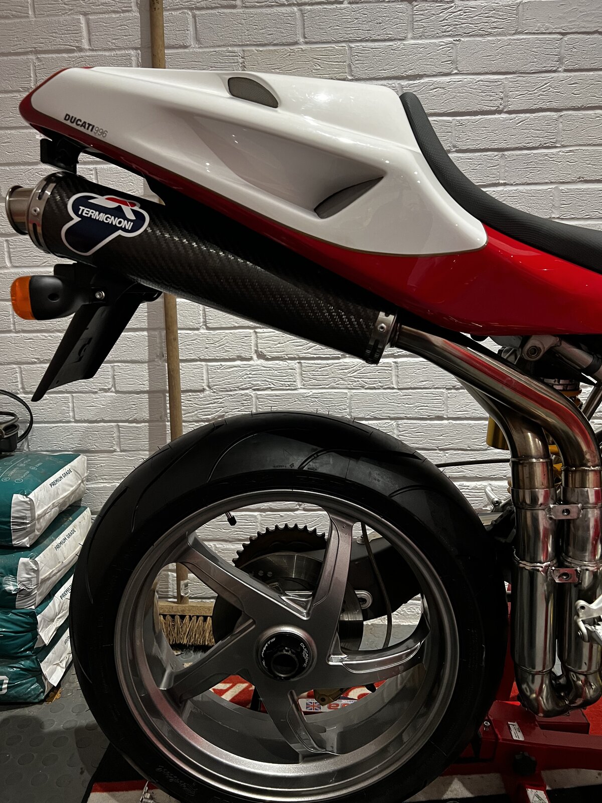

  1. Parts arrived yesterday from the guys at motorapido, rear wheel fitted up with new tyre and valve, rear shock due back Monday. Time to get cracking!
    Do need to re pack my termi’s which I can only imagine to be a delight

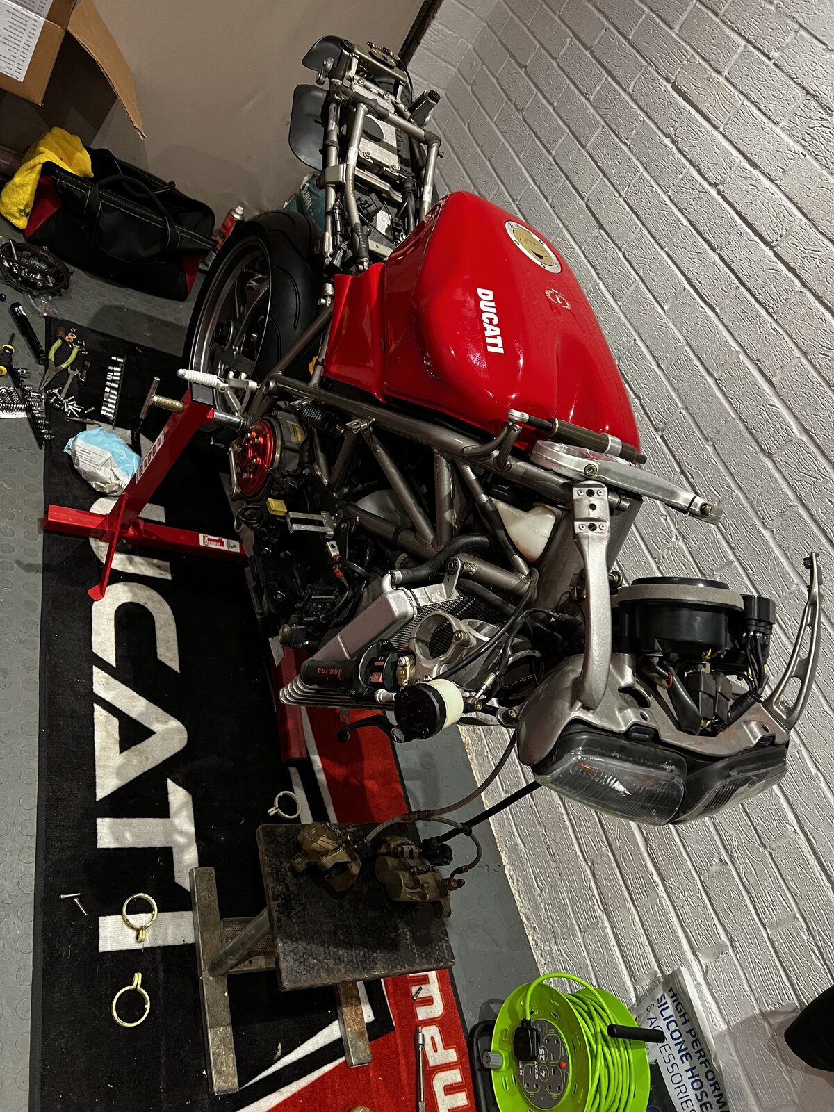

  3. Sorry been slacking, few small updates

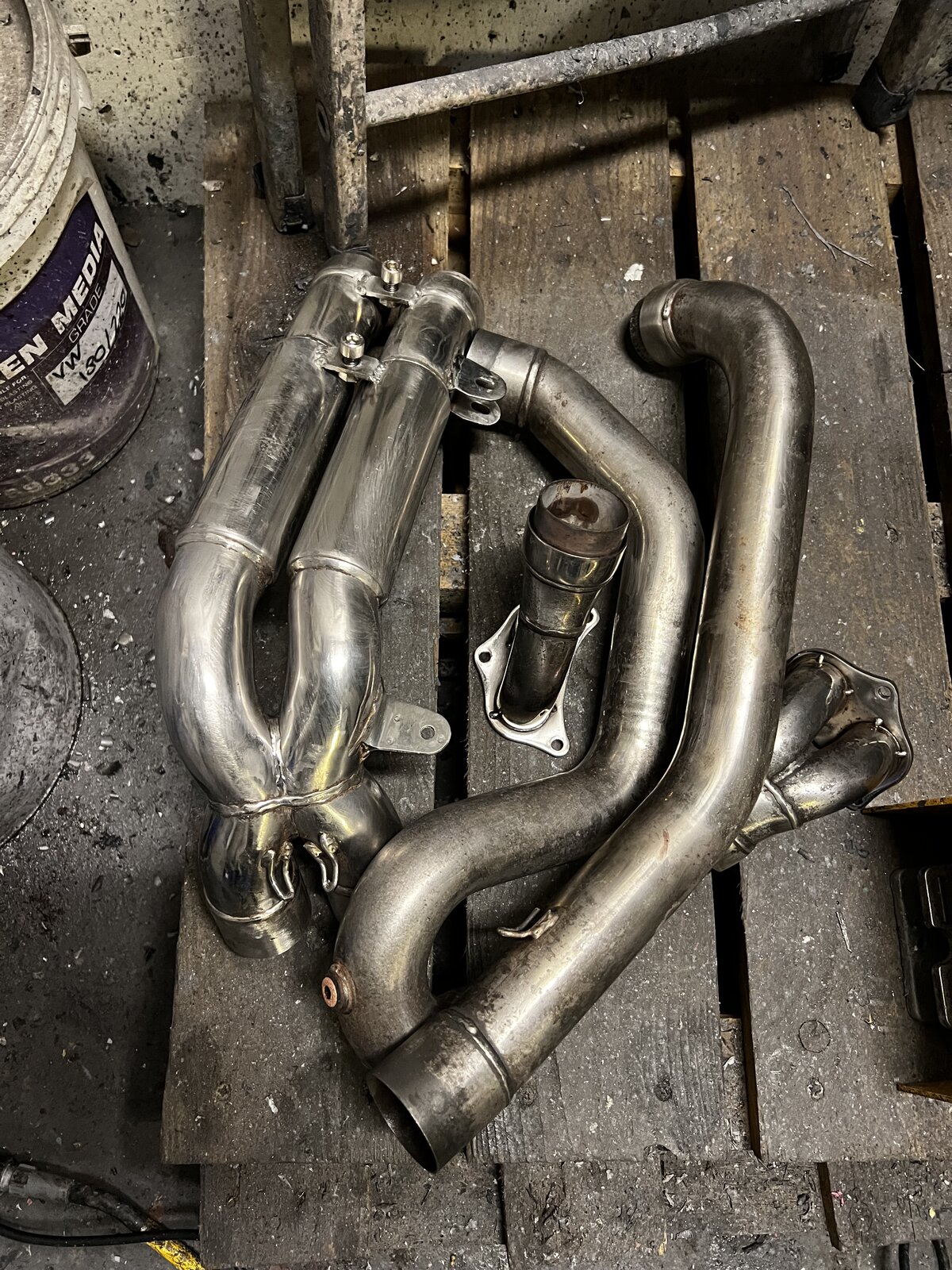

    exhaust needed a birthday so gave it the harpic treatment and a little buff,
    I’m taking the forks up to a place in Solihull this weekend to get them sorted and re plated. All service work is done Clutch back in tonight and wheels/forks out.

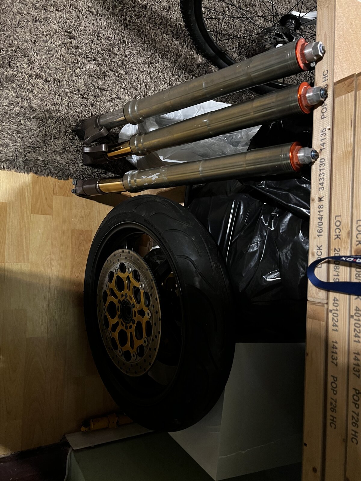

  5. Just about to travel up to Birmingham to drop the forks for refinishing, front wheel finished up last night so just a case of get these sorted and back together and it’s nearly sorted mechanically and ready for a good clean.
  6. No huge updates as of yet, forks delivered to Birmingham last weekend,

    stripped my spare termis and re packed them yesterday, what a delight that was… but think the carbon looks nice with the red

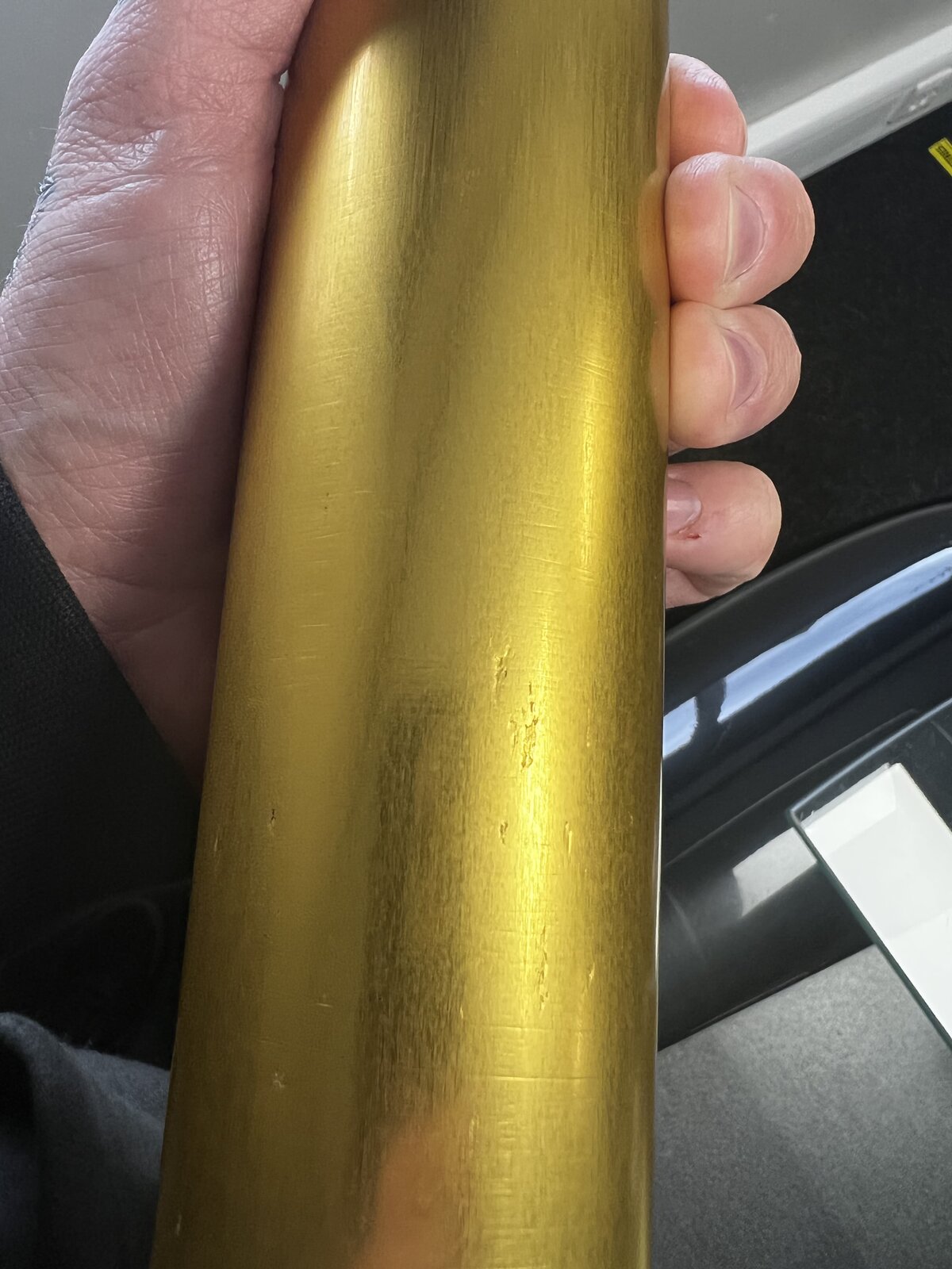

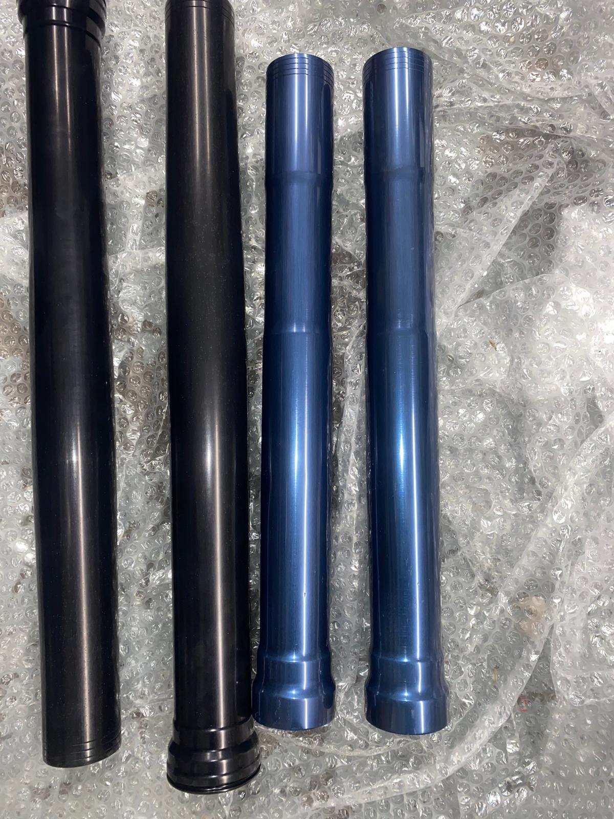

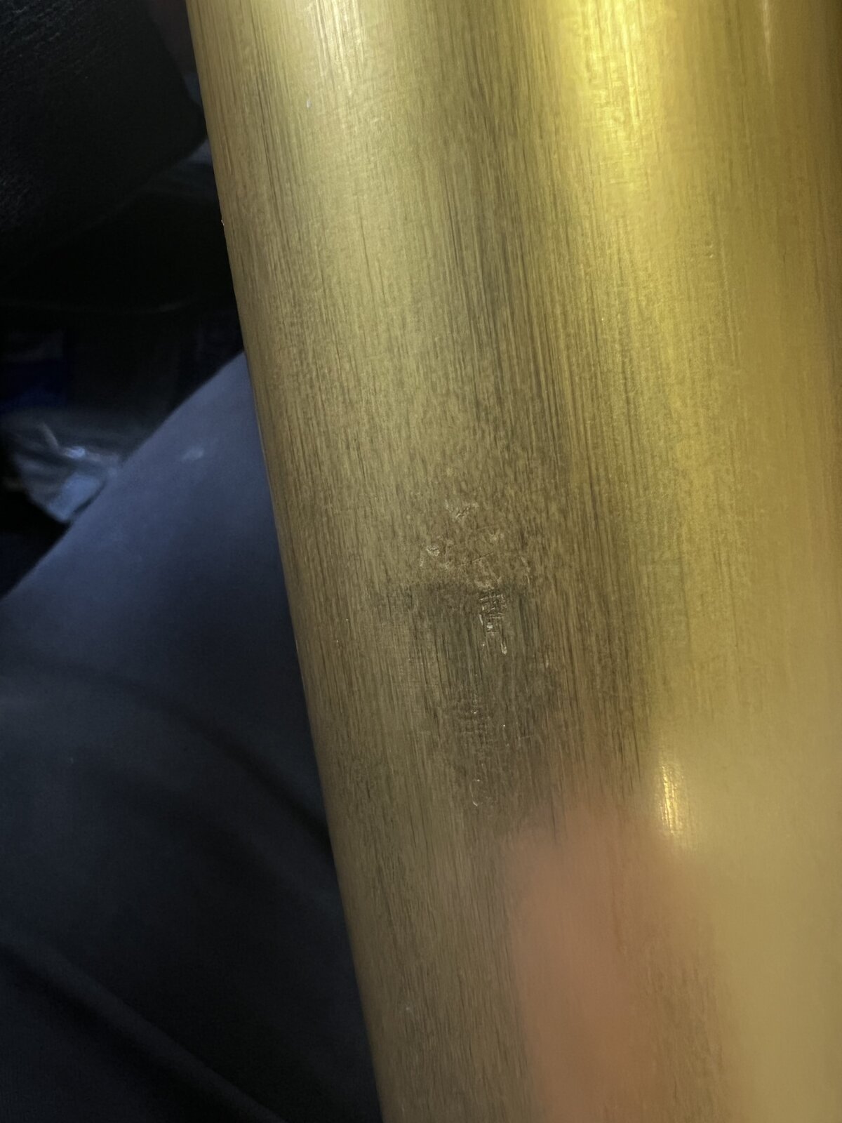

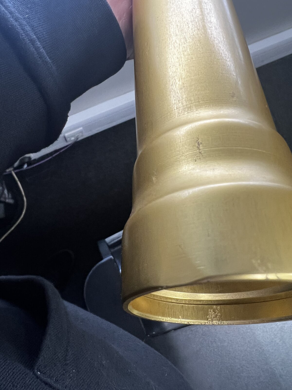

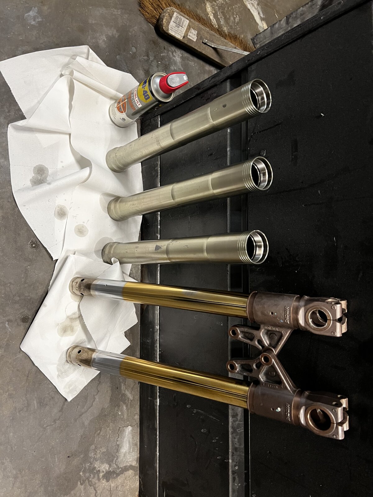

  10. Forks are back... what a complete shit show. disappointed to say the least. what are my options? can I use the upper tubes and my lowers with another bike?
    Firstly he did them blue, don't ask me why... then said he couldn't do the original colour which he said he could do. and now I have them gold but they just look terrible. :(
  11. Pictures
  12. Firstly the originals are hard anodize. The colour is what it is with hard anodize, it's not something you can chose and it is notoriously difficult to reproduce. Different tanks and different grade aluminium give a different colour. I recently had a few bits re-anodized in hard which were all the same colour when they went in the tank. Half came out much darker than before and half were much lighter.
    What you have looks like cosmetic anodize which comes in all sorts of colours but again, can't really match it and I've never seen standard anodize that looks like hard.
    The Ti- nitride on your lowers seems to be nearly worn off in places too. It is a extremely hard coating which gives less friction than hard chrome. It's a lot thinner than hard chrome though so when it's worn away it leaves the much softer base metal exposed. It can be redone but it's quite expensive.

  14. All stuff the expert who told me it would be no problem maybe could have mentioned.
    still they will work il prob end up putting them in the track bike as I have sourced a good set from the states finger crossed, just a bit disappointing.

  16. I bet you are disappointed. I don't get why people promise the world when they know they can't deliver.

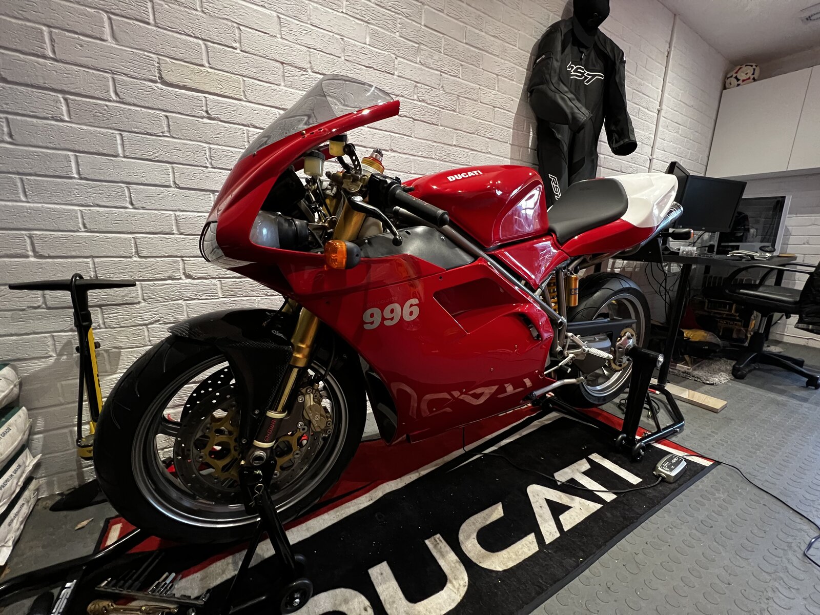

    #237 Olly snow, Mar 5, 2022

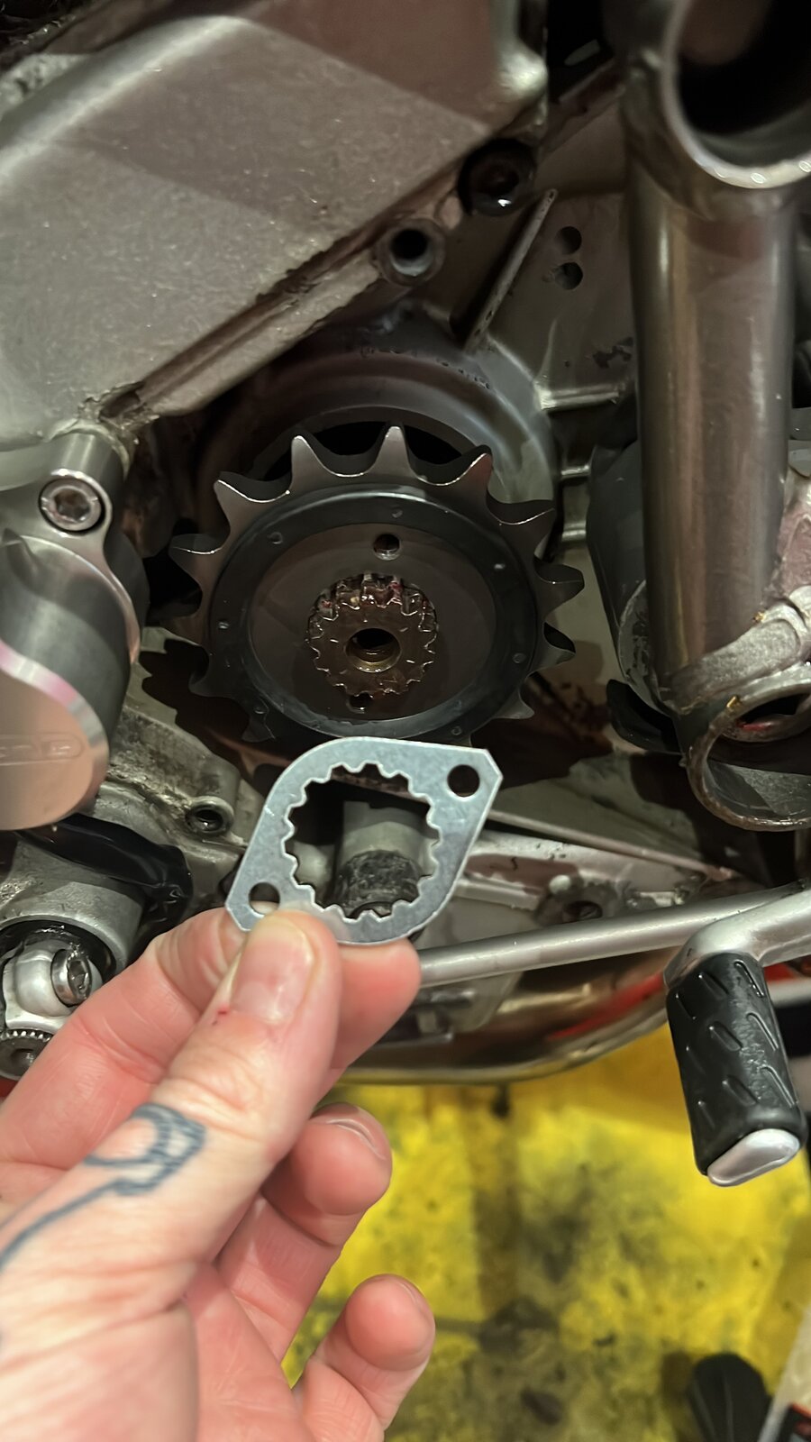

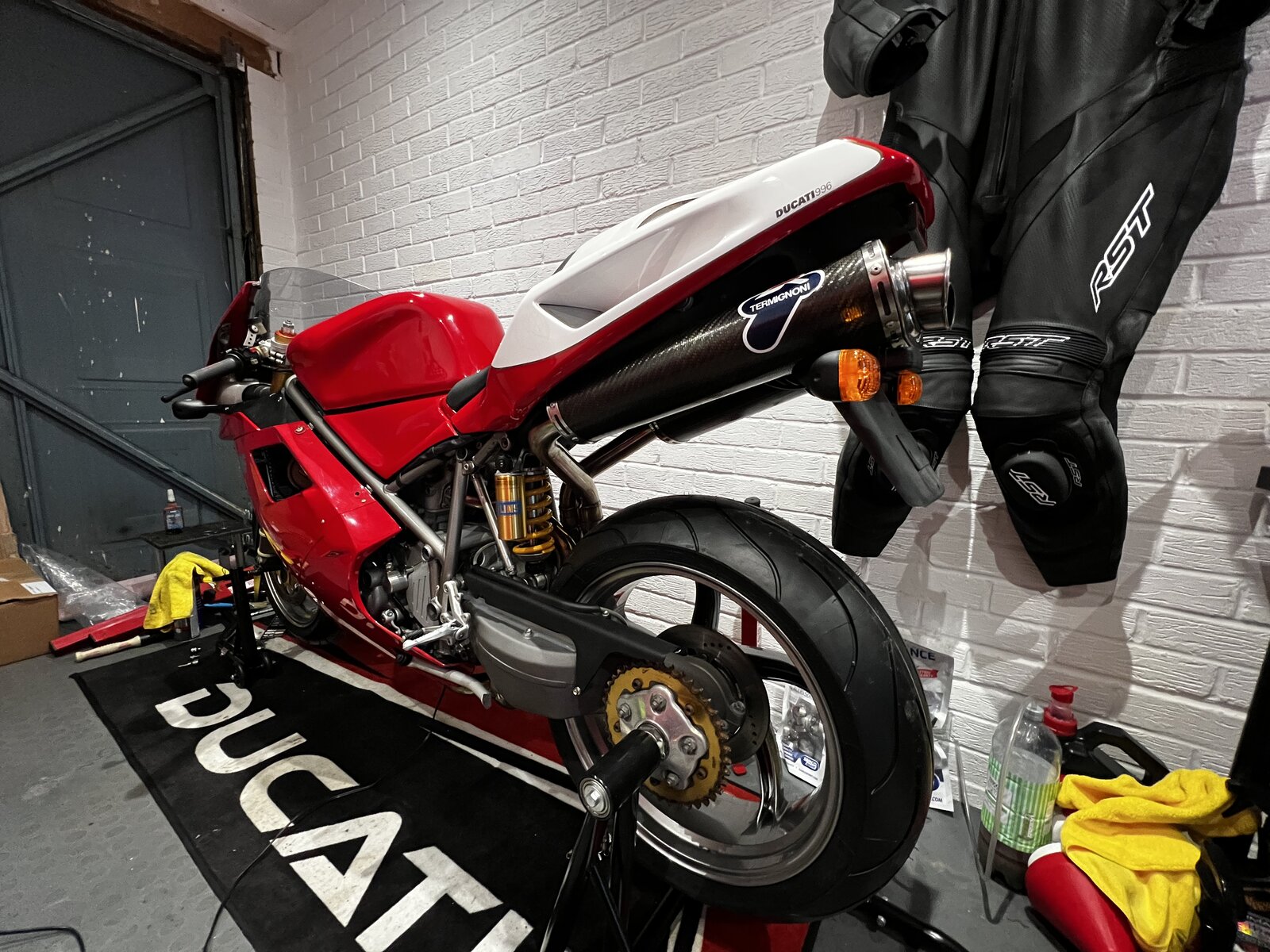

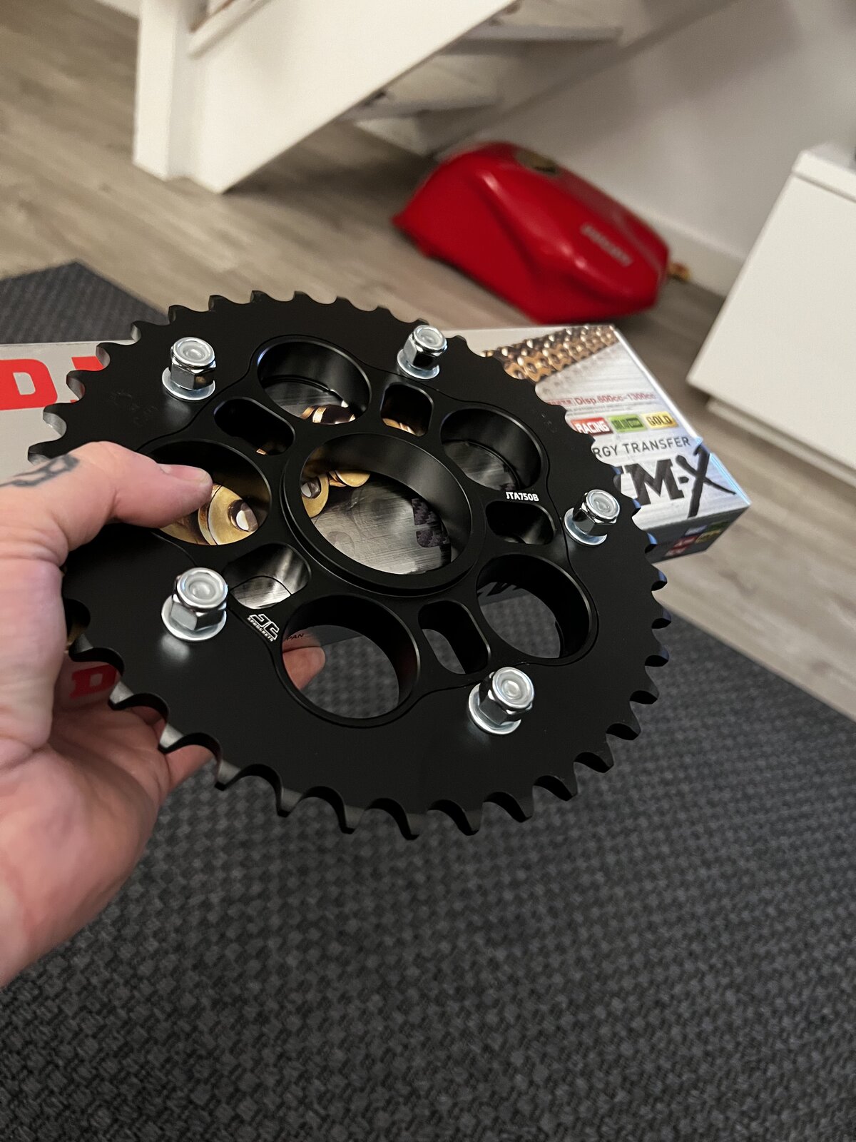

  19. Nice little day of cleaning and tinkering today, new airbox seal on, changed out some more of the awful non genuine Bolts, new front sprocket on, cleaned around that area too. Hopefully get the rear sprocket and chain on this week!
