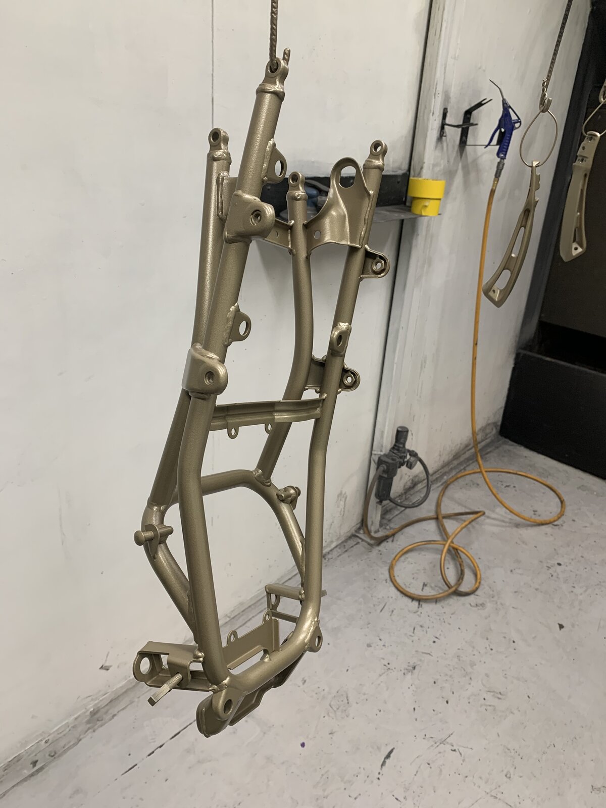

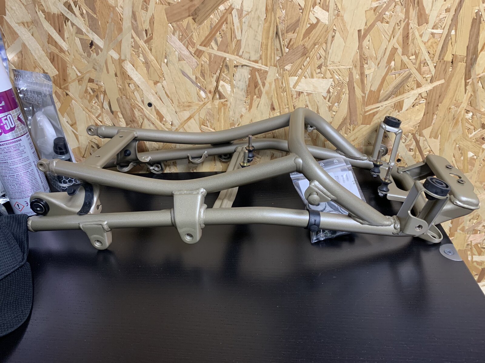

  5. Slow updates but nice bunch of bits from the guys at Moto Rapido, and subframe stripped and blasted, really happy with the colour match will get some bits into colour next week, just waiting on some clearcoat

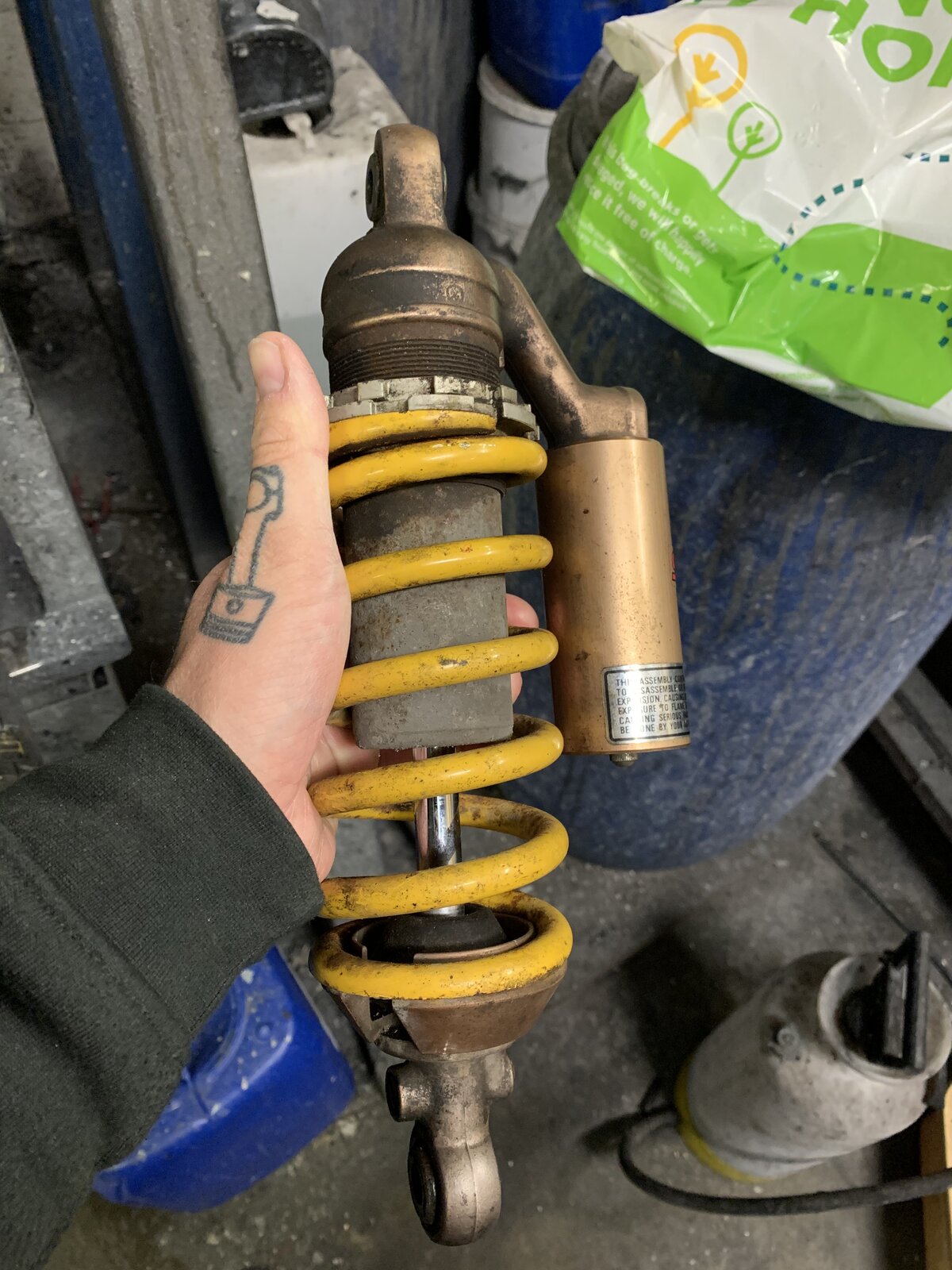

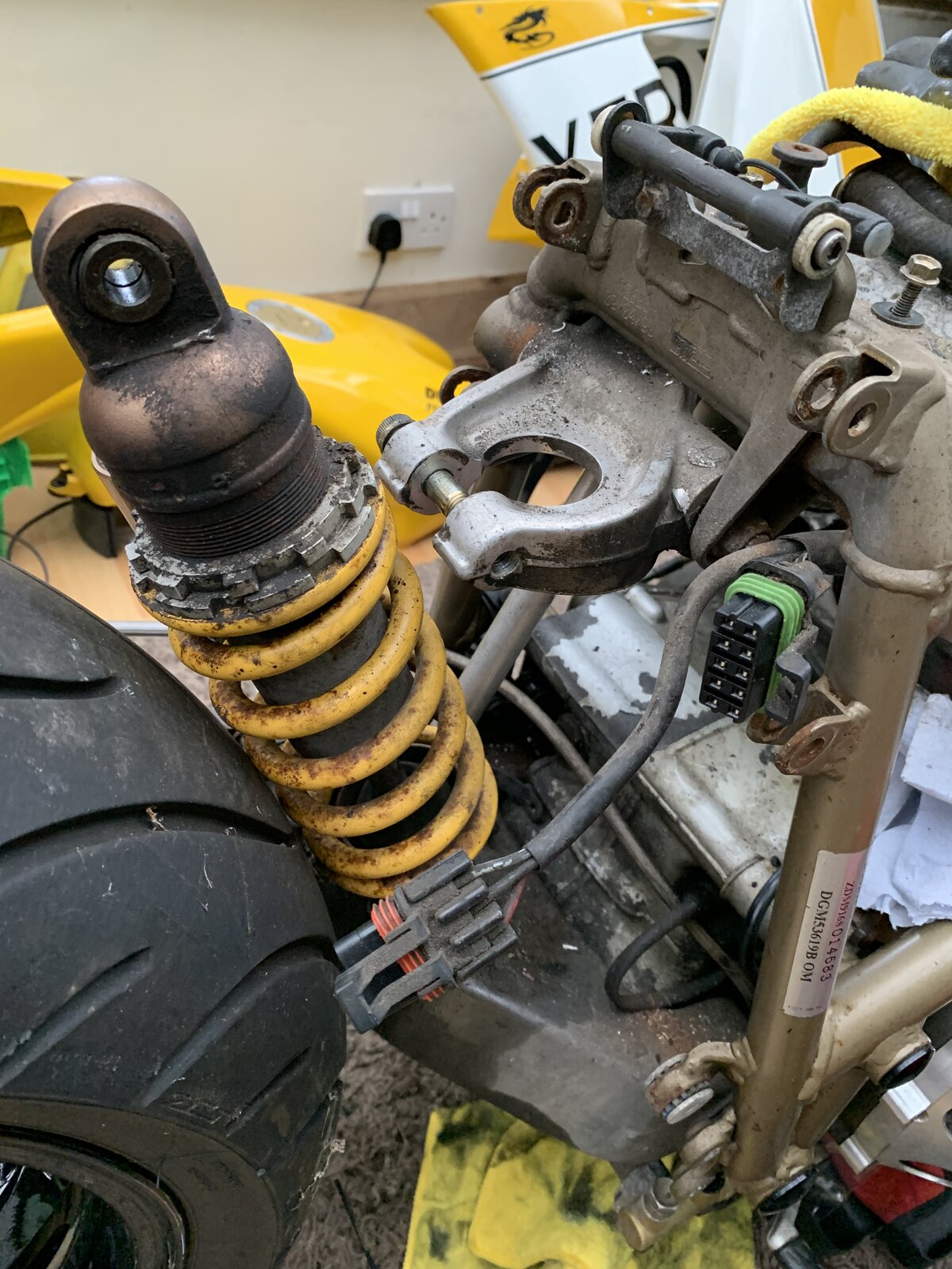

  13. Slow Sunday but a few bits off and prep for shock removal also, can see that bottom shock bolt being a pain, have soaked it in a motorex rust penetrator that I’ve used on other projects so fingers crossed
  14. Good progress today!

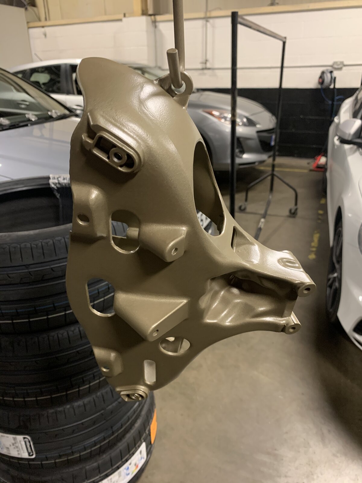

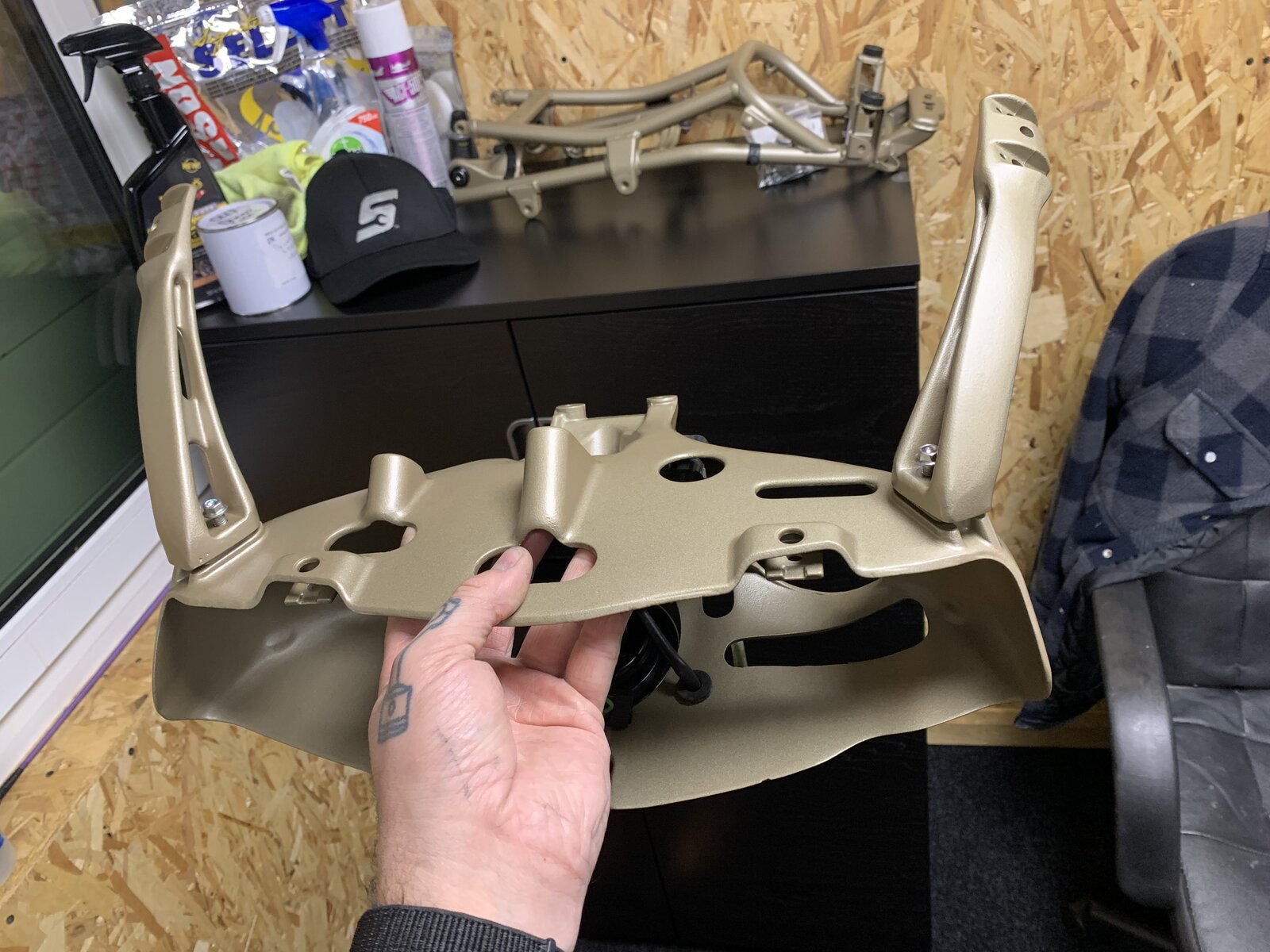

    First lot coated, really happy with the match! Also just Managed to get the rear shock out, little bit of heat on the rose joint and put it came

  16. Small progress but progress none the less, is there a go to for the rear shock? I can do the spring etc? My old mans love deal with k-tech? Didn’t know if anyone had any help at all? I want to strip it and re-zinc the threaded part really.
    Cheers
    Olly
  17. I have one here in pieces. I can send you some pictures and guide you through the process of stripping it down if you want. I can do the same for rebuilding it but you would be well advised to have it checked on a Dyno after a rebuild. Seal kit for the damper is about 28 quid. Only tricky bit is re-gassing as you need some special kit to do that. I have a home made version for that too.
  18. sounds really helpful would love some pictures of the strip down!
  19. When I get a minute I get the bits out and start taking some photos.
