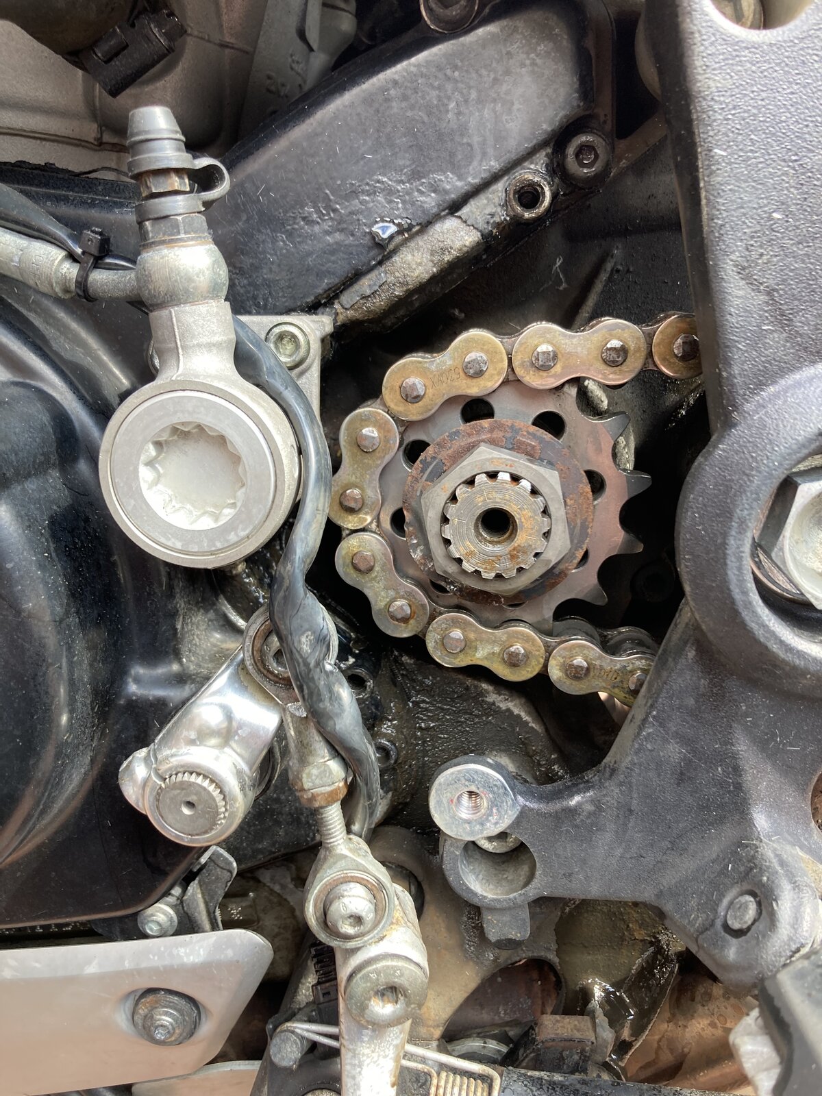

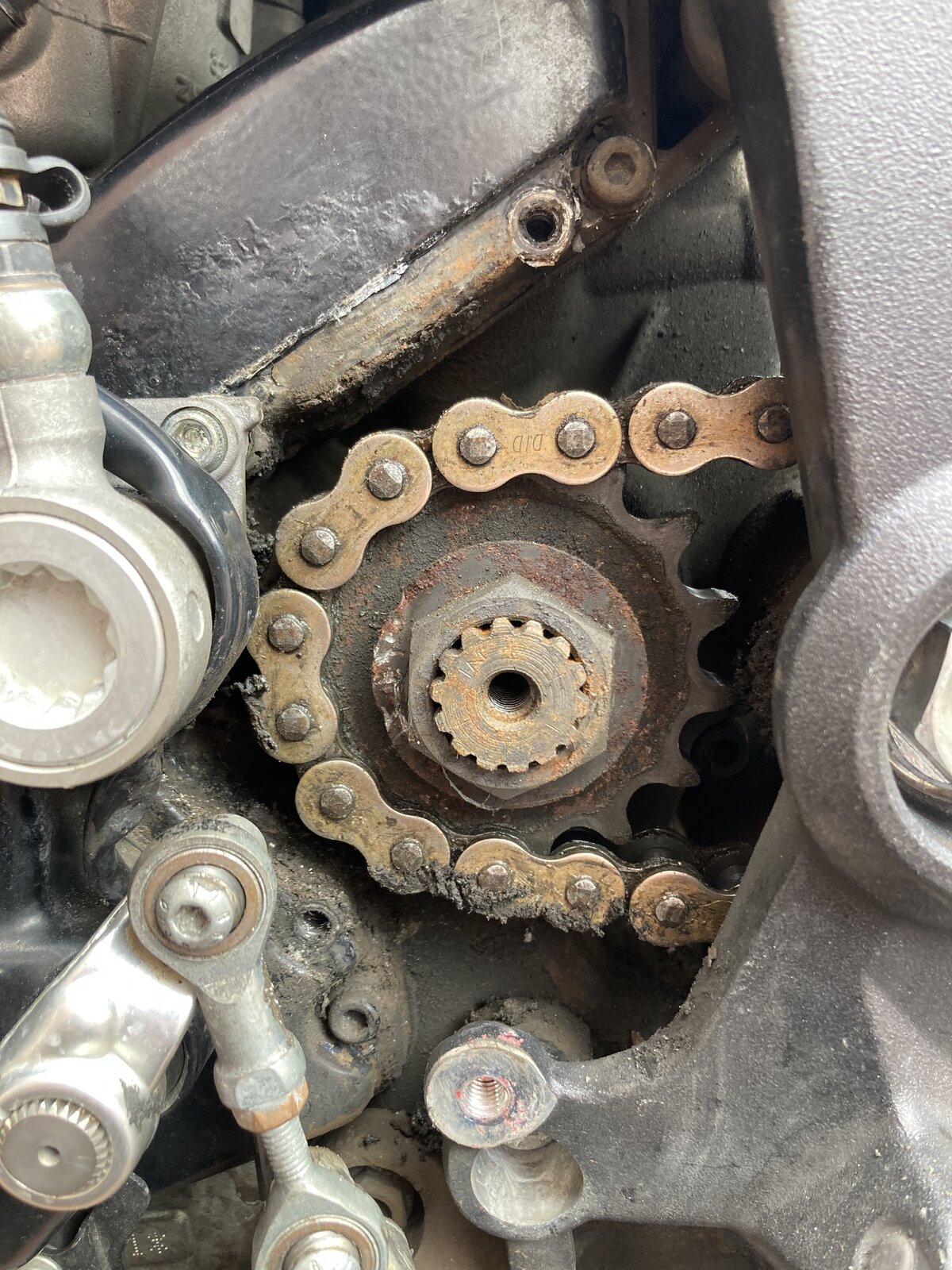

  7. I did it on my own but what a nightmare getting the old chain off was a fine art
    All done and back together see what the results are
  8. You’ll be happy.
  9. Looks like a bit of lube on the chain would not go amiss!
  10. The chain was really manky this was after trying to clean it up with everything apart all good now

  15. Looks well manky and in need of some serious TLC.
    What’s that wire routed perilously close to the sprocket?
  16. Looks like wiring to the side stand on the sprocket cover there is tags for the wires to sit in
