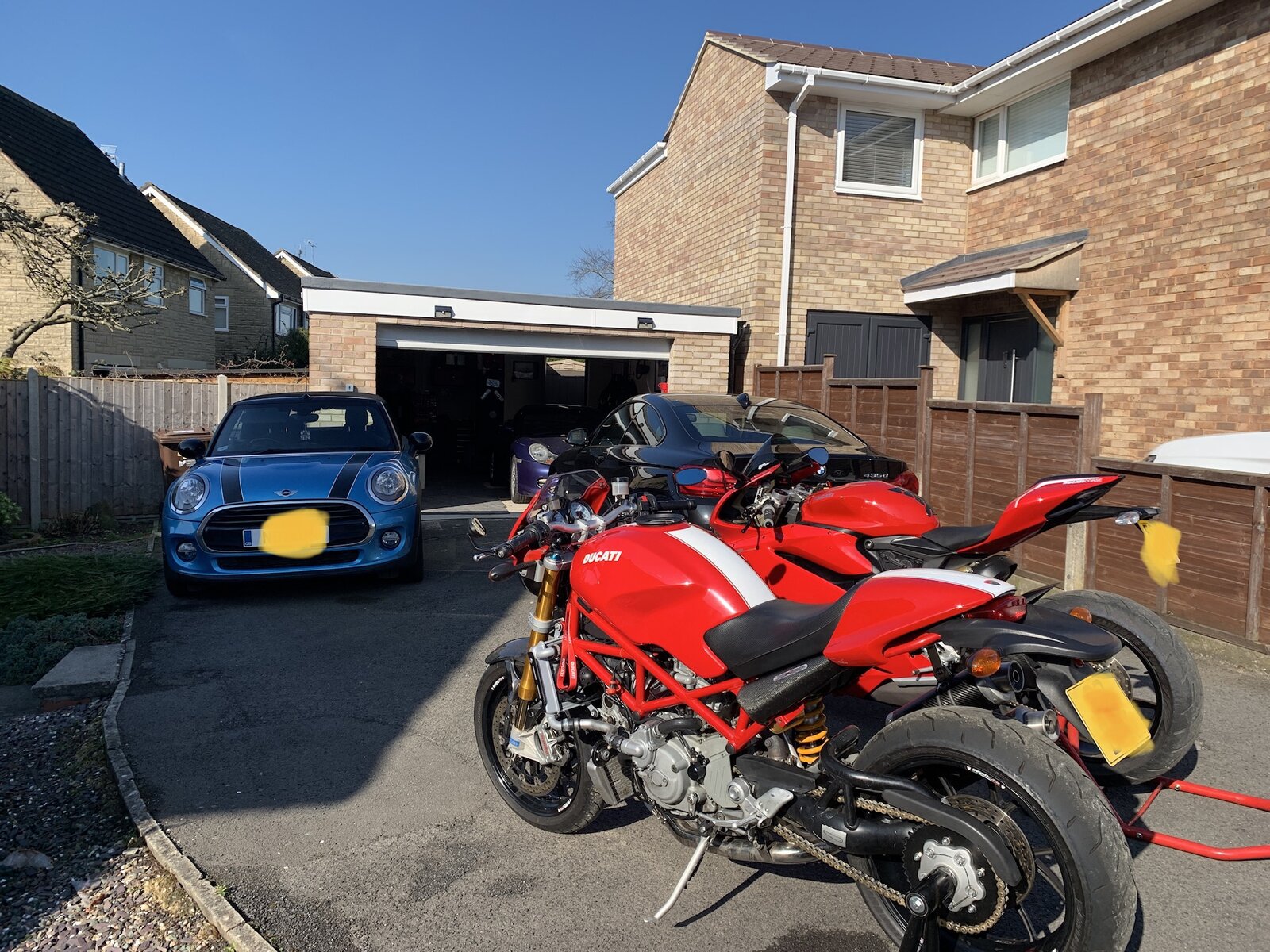

  9. Pic coz I can. And Jesus the panigale is loud compared to the monster!
