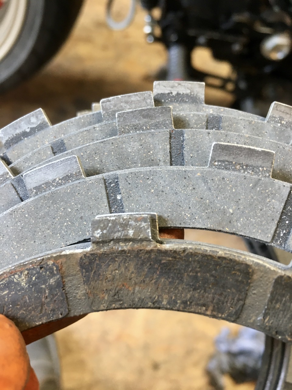

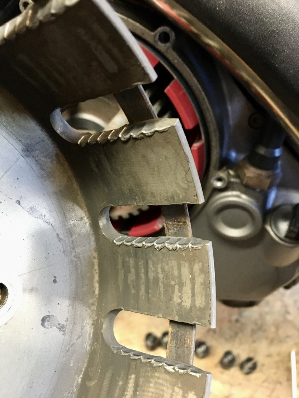

  11. In my experience ‘noisy’ clutchs are due to excessive wear in the clutch specifically in the clutch basket. The friction plates slide up and down the slots in the clutch basket and as a consequence their edges wear away and they wear grooves into the sides of the clutch basket slots. The maximum space/gap between the edge of the clutch basket and the tab on the friction plate is 0.6mm anymore and it’s recommended to get new friction plates and/or clutch basket.
    The photos below show the clutch basket and old and new friction plates from my Monster. The clutch on my Monster was really really noisy, even when in gear. When I serviced the bike recently I discovered the wear on the basket & friction plate tabs (the plates were down to the minimum recommend thickness 2.6mm as well). The plain plates were still well within tolerance. I put in a new basket and new friction plates and now you would hardly now it’s a Ducati dry clutch it’s so quiet.
    In stating the above I’m not dismissing OR’s suggestion for quietening the clutch at all I’m just suggesting you should perhaps check the wear in your clutch pack as well.
