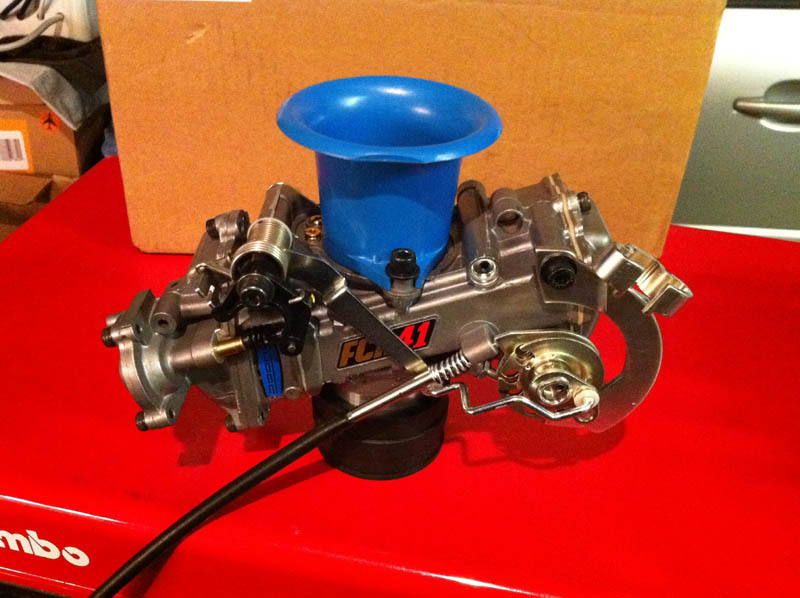

    I cut a 'screwdriver' style slot in the end of the throttle shaft
    ...and made a short spindle to go between the throttle shaft and the TPS.
    I then mounted the TPS on a 1.6mm aluminium plate mounted to carb via stand offs.
    Turned out simpler to do than I thought it was going to be.

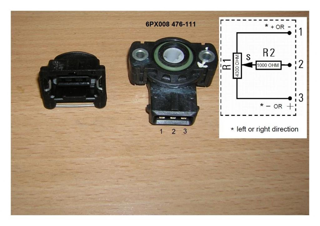

    Pic of the Hella TPS I used above.

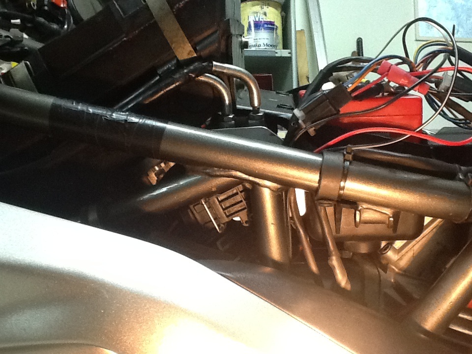

  16. Sounds good, are yours a pair of 'racked' carbs? because looking at the throttle shaft setup on my single carbs it doesn't look too easy to fit into or bolt onto - Pics would be good. :upyeah:

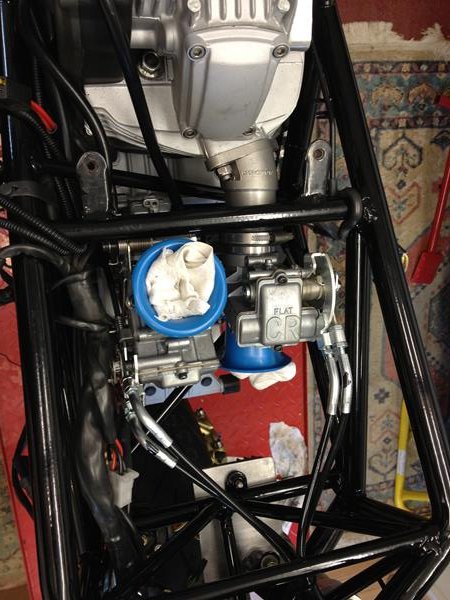

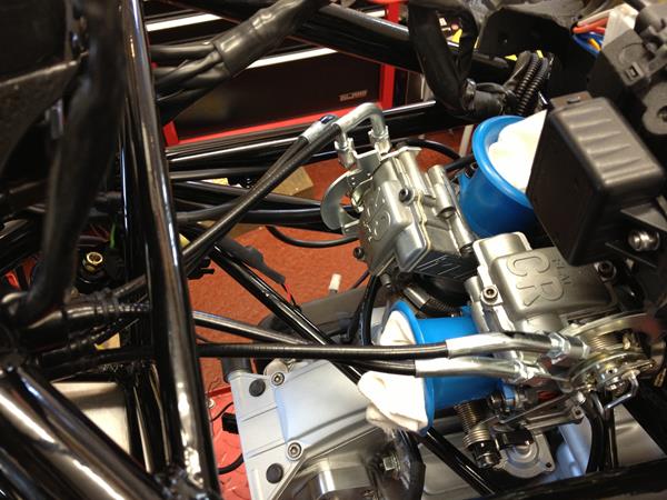

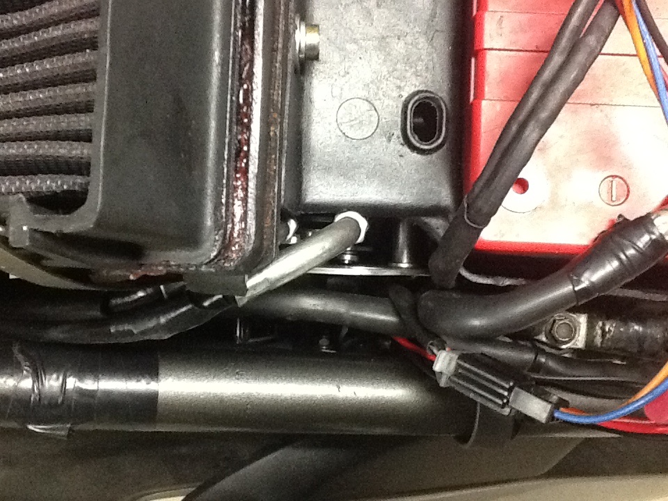

  17. I have attached some pics below. Next time I have my carbs off I will take some better pictures of my set up so if people want they can copy it. You can also see the tiny Ultrabatt600 (with inbuilt BMS) I am using. I have relocated my coils to either side of the frame in the same location as on the later bikes to get better cooling to them and get them away from the pick up wires and IGNITECH unit which now sits in the battery box. I still need to tidy up the wiring you can see in the photo!
    Mine are a racked pair ( why does that sound so wrong!)
    Can you see the end of the throttle shaft as you can in the picture below of the singles?
    and if you can see the end of it you can cut a slot in it to drive off?
    Do you have pic of the end of your throttle shaft?
    #39 FastBikeGear, Mar 25, 2013
  18. Basically looks the same although that part of the shaft sits close to (right behind) the frame rail so would need to see how thick the overall TPS/shaft/bracket is.
