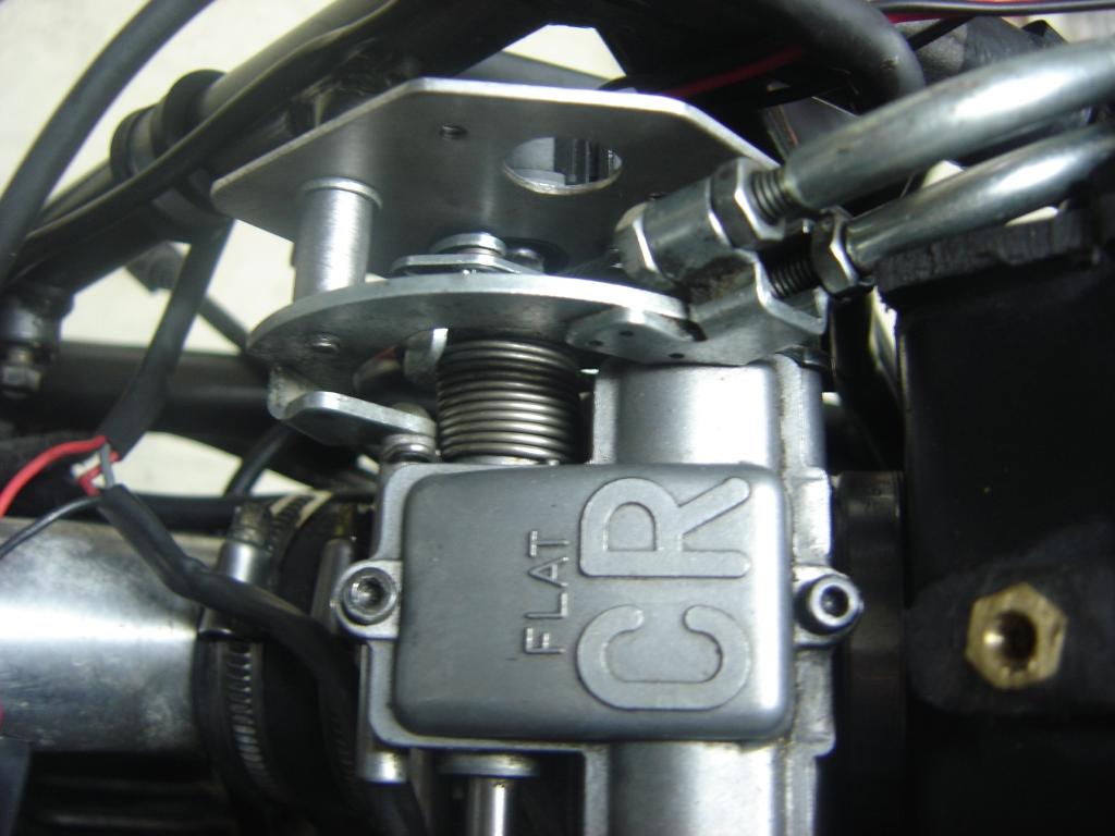

    On my bike it is a very close fit and required that the stand offs I used for mounting the TPS mounting plate were the minimal length that gave me 0.5mm clearance on the throttle mechanism. Further I had to used thin 1.6mm plate for the the TPS mounting plate instead of the 3mm plate I originally planned to use. But it all fits and works very smoothly.
  2. Ok, I need to take a closer look then. Would be good to see a pic of your TPS/mounting plate setup if you could get one. :upyeah:
  3. No problem. I will take some and post them next time I have the carbs out.

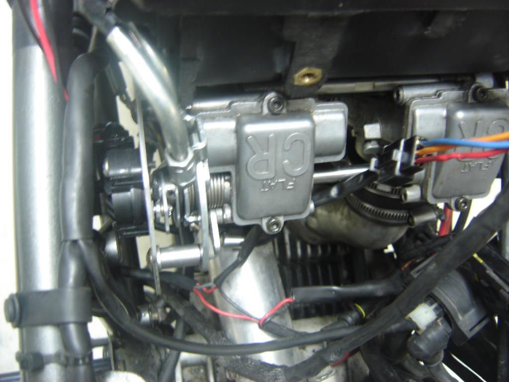

  5. As requested some better photos.
  6. Looks good, definitely something I will look into. :upyeah:
