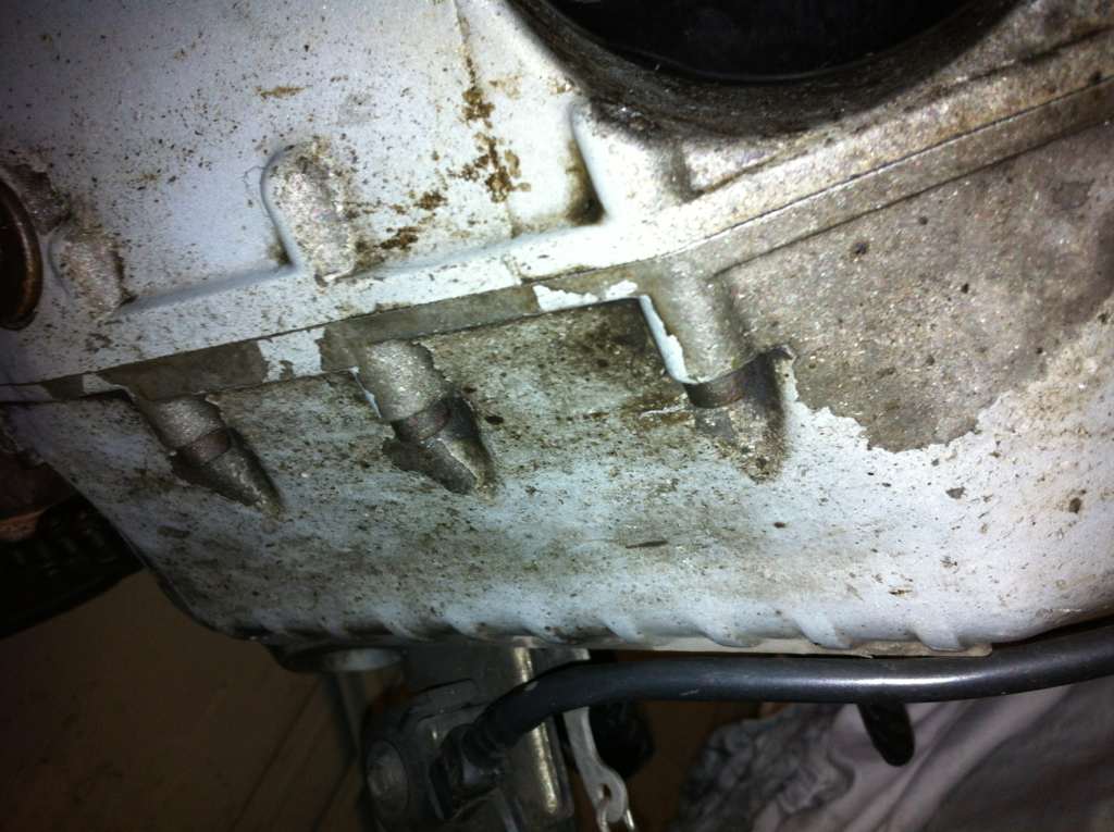

  1. Any update Stu...............anyone else with corrosion/quality of finish issues?......just curious ;-)
  2. Wow, that's appallling. The attitude from Ducati UK about that is very poor too. That's just not good enough.
  3. Yep. Almost Everyone since about 1990 has the odd bolt, paint Mismatch, powder coating or casing issue!
    Afraid it's almost always been on a one for one basis with D-Uk. Especially on engine casings with Nakeds, monsters, streetfighters, hypermotards are especially vulnerable.
    My '07 hyper gone around front cylinder head an generally underneath. My '05 monster, '08 848 (was also two Different colours left and right hand side!) all had it and my '95 748sp (seat unit and tank different yellows!) was one the worst I ever seen..
    Flash in dark garage does Tend to make it look worse.....

  4. Christ! that looks like melted plastic thats awful. My old Monster 600 was ridden in all weathers and didnt look that bad and you would have thought that paint technology would have moved on.
    On another note the Marchesinis on my 996 flaked like buggery when the bike only had 8500 miles ion the clock, turns out there was no primer (which should have been etch primer) used on the bare alloy. Obviously not Ducati's fault per se but it doesnt do their reputation any good.
    In my book they are still trying to build their reputation from the days of flaking chrome and poor electrics in the 70's - 80's.

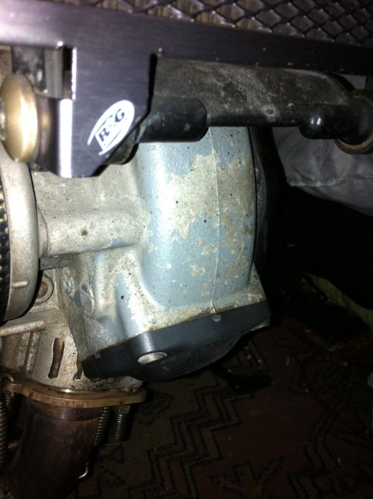

  6. On closer inspection I've got paint going on the water pump and cover...but only in a small area (lower side of water pump, and the area on the case where it meets)
    The rest of the engine is totally unaffected (first load of ammo right there!), a few scruffy fasteners here and there but the bike still scrubs up like new.
    I've got to pop down to the dealers this week so I'll raise the issue then.

  9. I went to RS Paints to get the engine paint matched up for my fuglystrada. They analysed the paint flakes I gave them and said it was a very thin, poor quality powder coat with no sign of any kind of primer. Bad workmanship, in other words. Sounds like not much has changed.

    The start of problems with engine cases is often the tiniest of stone chips, water/road salt etc will soon start the corrosion process from a pin prick break in the paint finish (and of course that will be the get out clause for Ducati regardless) but corrosion starting from the mating faces of cases is purely and simply down to the manufacturer imho.......the joining faces of the cases being untreated/coated and a poor sealing gasket and/or poor application of sealant imho.......worthy of a warranty claim!

    The dealer has said they'll address the cover corrosion at service time, which is at least vaguely promising. Will be sorting the crap paint on the panels and wheels this winter. Fancy a new set of wheels but fear anything lighter than existing is going to see me in the hedge within 10 seconds - not sure I need it to steer any faster than it already does!

  18. Just heard from SMC that they have had the go ahead from Tony Cowley who I think is an area manager to replace my engine casing under warranty :)
  19. I recall that Ducati stated that casing corrosion would no longer be covered under warranty about 4 years ago,because it was costing them a fortune on the air cooled motors, so if you are getting yours done, well done! that sets a president for others to claim also. It may well end up costing them a fortune.
