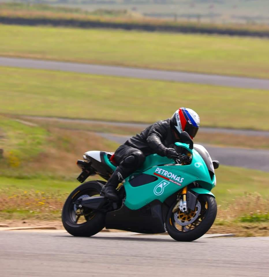

  2. thought i would share these though
    0 miles - first outing at Anglesey. Managed 5 sessions at a very sedate and slow pace to help bed it in a bit.
    It did highlight a few small niggles and thing that needed sorting though as you would expect after being sat for 18 years.
    Then a few road rides, before another outing to Donington last weekend for the CBT
    I had never ridden Donington before so it was a baptism of fire really.
    It also highlighted a slipping clutch when hot - result of a Ducati slave cylinder ironically.
    To work on its not that bad, access to the battery is a bit of a pain, but the engineering in the bike is astonishing even for its day, it all seems to work, all seems quiet reliable so far except for some small niggles.
    Bit extreme for a daily, but as with all my bikes it will be used, enjoyed thrashed, maintained and looked after.
    For the investor types, there are worse things to be putting your hard earned into. but then again - lifes to short to just sit and look at stuff like this and not actually get out and enjoy them as intended.

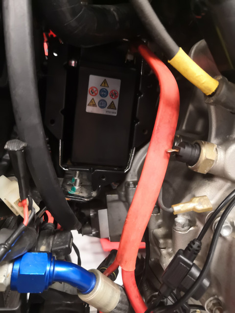

  3. Good to hear of a member on here who has one, next time you have the fairings off could you put a few photos up on here,

  5. Thanks, the dash looks very retro compared to today’s bikes, looks like you have had the spanners out on it,

  7. No. mine came from the horses mouth so to speak.
    Yes done quite a bit on it so far, all the usual stuff you would expect for a bike sat for 18 years.
    Fork seals, clutch slave, fluids, battery, the OEM Michelin pilots were like plastic.
    Reg reg failed instantly, gene has dropped a winding and is a bit low on charge with lights on at low RPM, however it fuels wonderfully and is silky smooth and easy to ride. it fuels better than lots of bikes i could name of similar age (749R, R7, most early Honda injection bikes) and is really a very nice bike to ride.
