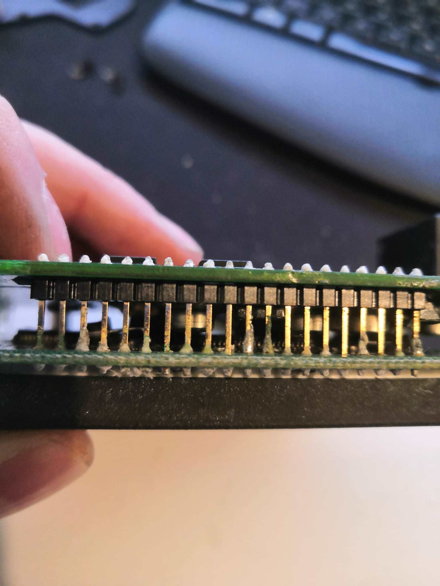

    I recently send my LCD clocks away to a pal on the PB forum. The screen bleed was becoming an issue also after being sat in my garage it was starting to show more lines than an old Mk1 Audi TT dashboard. so it needed looking at.

    I watched the wheeler dealer car program and they had an early Audi with a dash with the same problem its good that there is company's who can do these kind of repairs.
