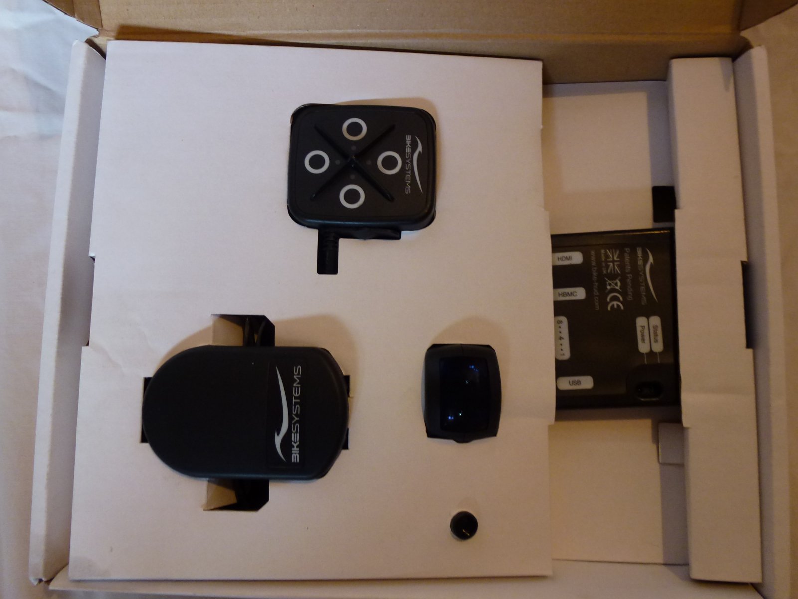

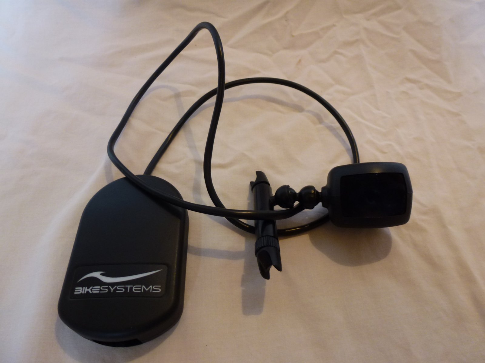

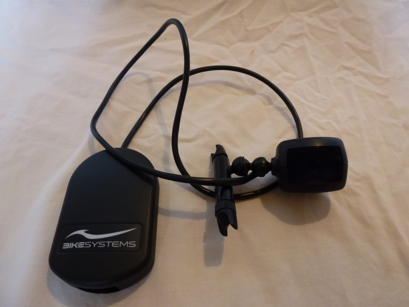

  1. I'd be tempted, but I wouldn't want to cut into any Ducati wires.
    Does this work with CAN BUS?
    What bike did you have it on?
    I can't seem to find a technical manual as to what sources it picks up on.

  3. Why, are you selling both?

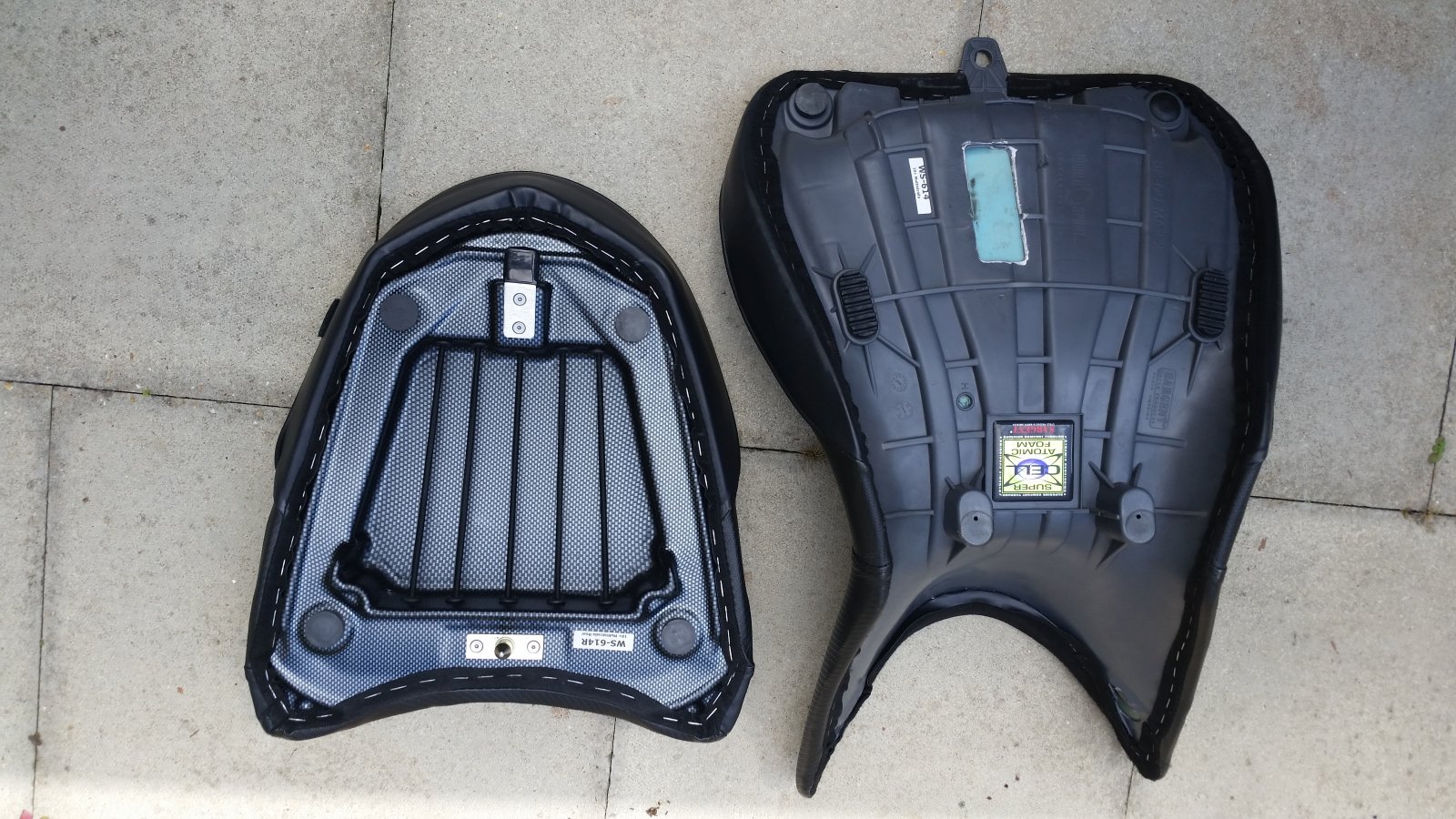

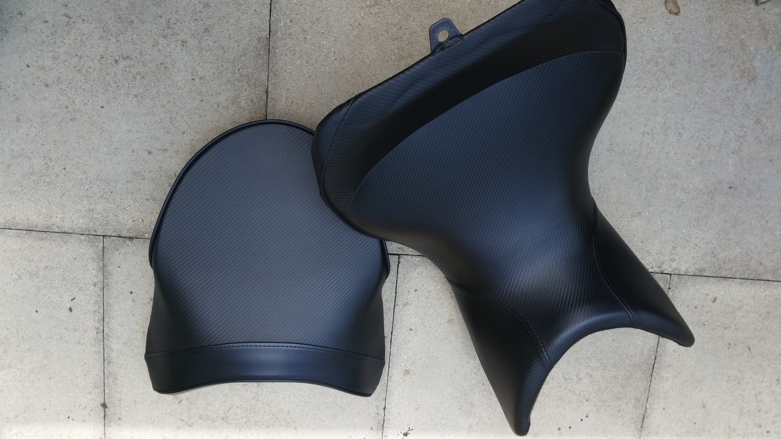

  4. Hi, what colour is the Sargent seat? any photos?
  5. Black with black piping.

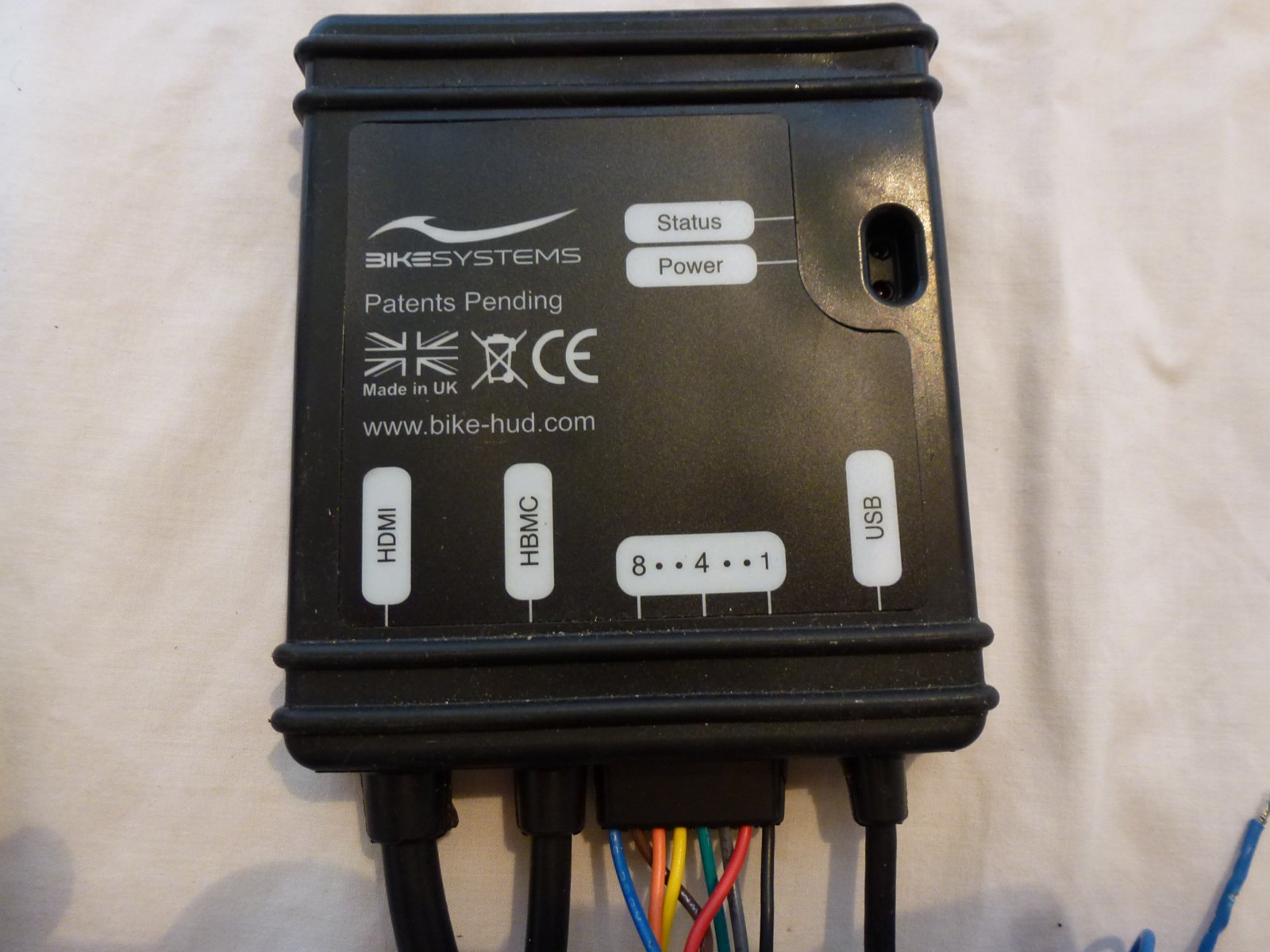

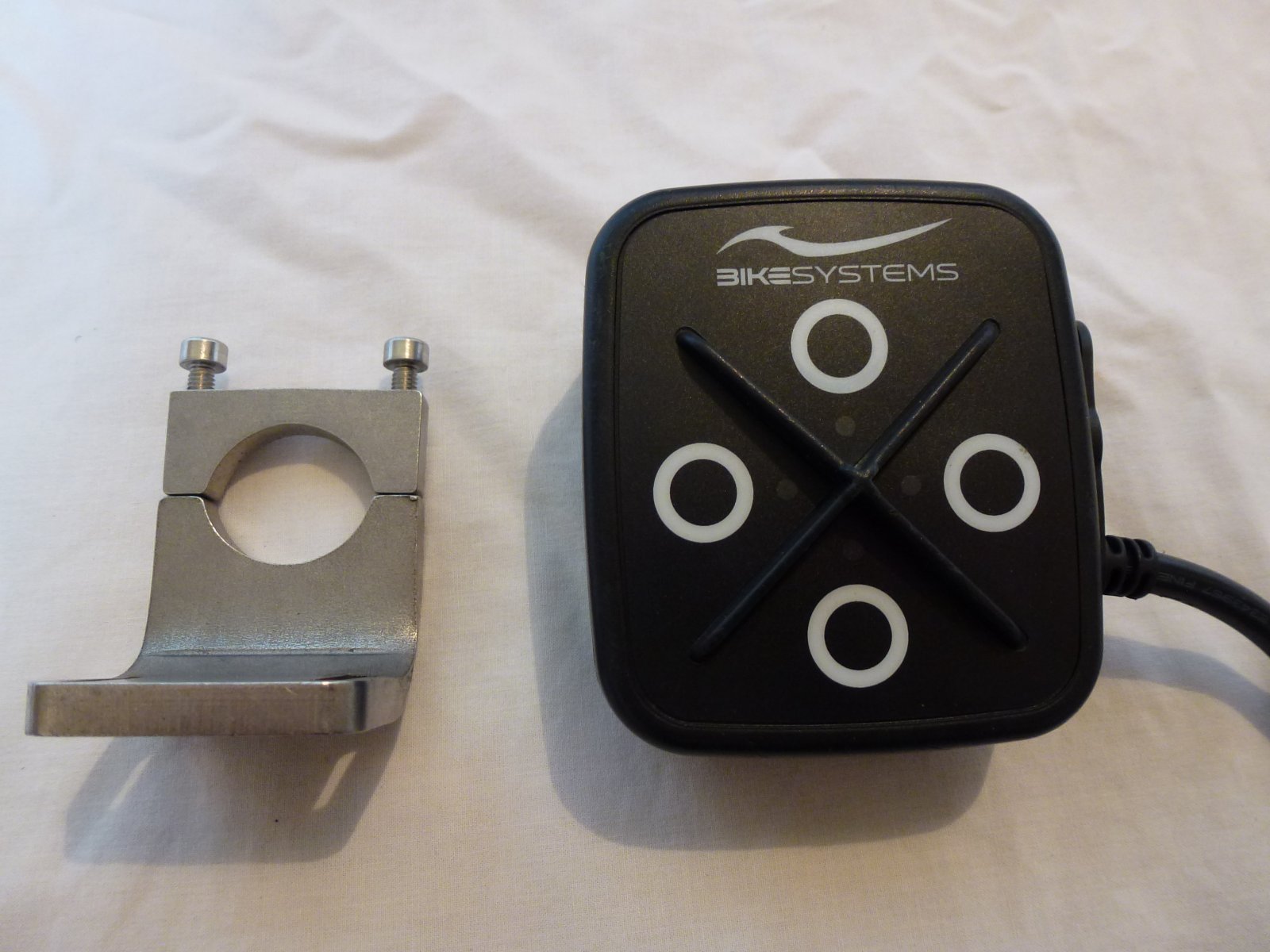

  8. I have a full technical manual for it as a pdf and can email it to you if you want to have a look.
    I had it installed on my Multi GT 13
    This is the basics of the connections to the bike from the main unit. I'm pretty sure that I managed the installation without cutting into any wires or even using 'Scottish-lock' connectors - I just 'piggybacked' into connectors.
    1. Black - Earth - Typically wire to a known earth wire, Frame mounting or Battery negative
    2. Red - PowerNote the 1 Amp in-line slow blow fuse that MUST be used. Connect to a 'switched' live off the ignition switch. Alternatively connect to the rear light positive wire. IMPORTANT: - bike HUD draws around 1.4mA. If you connect to an existing circuit such as rear light check with your Dealer that this does NOT cause issues with the CanBus sensing Bike HUD as an over- load on the circuit and triggering a fault.
    3. Grey - Side stand
    4. Green - Right Indicator
    5. Yellow - Left Indicator
    6. Orange - Neutral Light
    7. Brown- Main Beam
    8. Blue - Engine Sensor - Depending on the ignition type there are two ways of
    fastening the sensor.1.) Traditional HT lead and separate coil - identified by a thick wire ending in a small cap that is a press- fit onto thespark plug. Cable-tie the sensor around 100mm length along the lead starting at the edge of the spark plug cap. 2.) Coil on Plug identified by two thin wires connected to a larger plug -cap that is usually fastened to the top of the engine. Wrap the sensor wire 4 times around the base of the spark plug cap
  9. Hi,do you still have the topbox, does it come with the rack?
  10. please pm me the installation manual.
    How does it know the speed and gear?

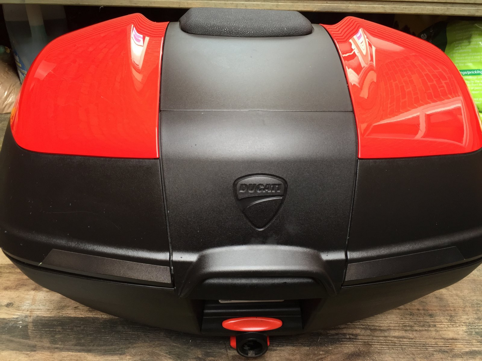

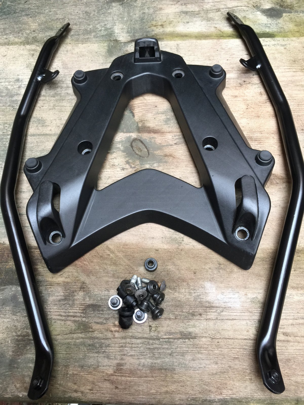

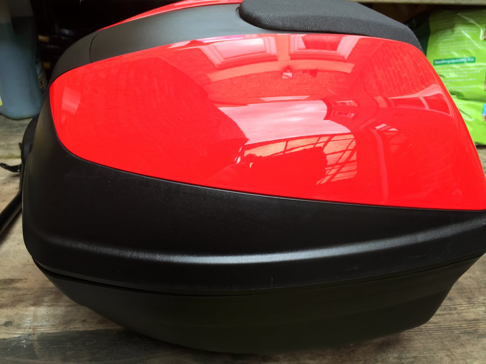

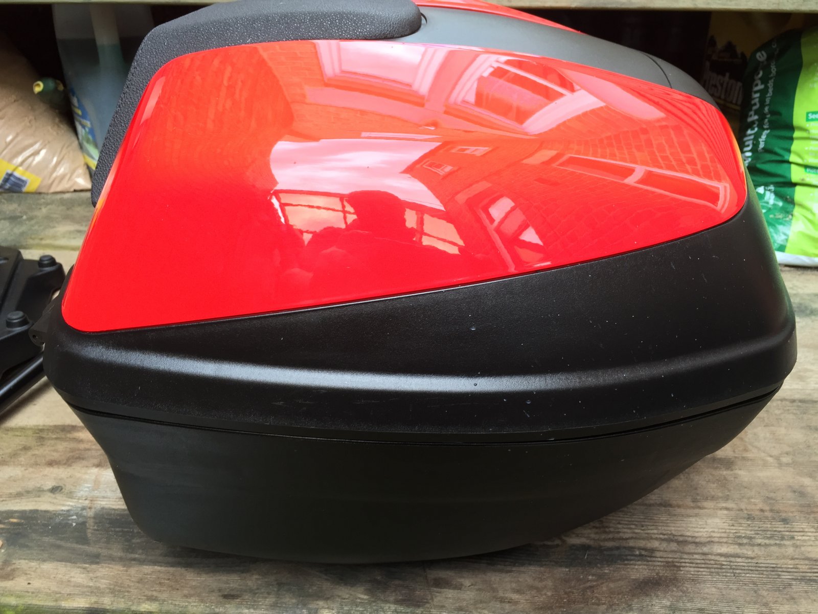

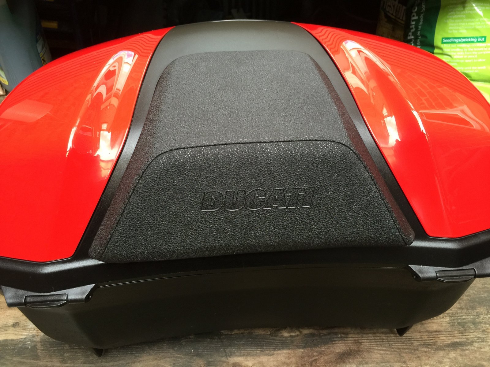

  15. Top Box for 2010-2014 red complete with fitting kit and all attachments, all you have to do is add your barrel.
    There are a couple of minor scuffs on the paintwork very hard to see in the photos.
    The support legs had some light corrosion which I removed and gave a fresh spray of paint.
    £250 delivered, collection or delivery on Tyneside preferred.
