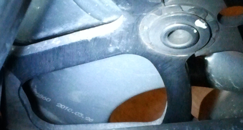

  1. FG8603 "No Problem":wink:
  2. Good spot!.............does that actually matter??....is the paint mark not just to show that both parts checked as present?
  3. Have looked at my r/h/s f/leg; buggered if I can see a number. It's going in end of month for new clocks so will get the mech droid to have a peek :upyeah:
  4. No, it is FG860
  5. mine are FG8650 2012
    i presume thats a good thing :)
  6. just checked mine, 2012 on a 62 plate it reads FG8063 2011.05.13 will still get it checked by Snells next service
  7. Mine is a 2011 model, FG8063, 24.03.2011, not affected by the recall (dixit my dealer).
  8. thanks for info, will check, bugs.

  12. Just checked mine and I have one of the codes in question FG8602, do they change only the right leg ? and if so does anybody know how much it would cost if I paid to get the left side changed as well. Long story, but I got the disk bolts changed to SS ones and an impact hammer was used to change them over as they were tight as hell and marked the ohlins fork leg end. We didn't even notice until my dealer pointed out the marks. I managed to get the marks out used a fine grade wet and dry . I managed to get both sides to look the same but now if they change just 1 side they will look slightly different ..... I know it might be a bad case of OCD but think I would still like both changing anyway for piece of mind to
