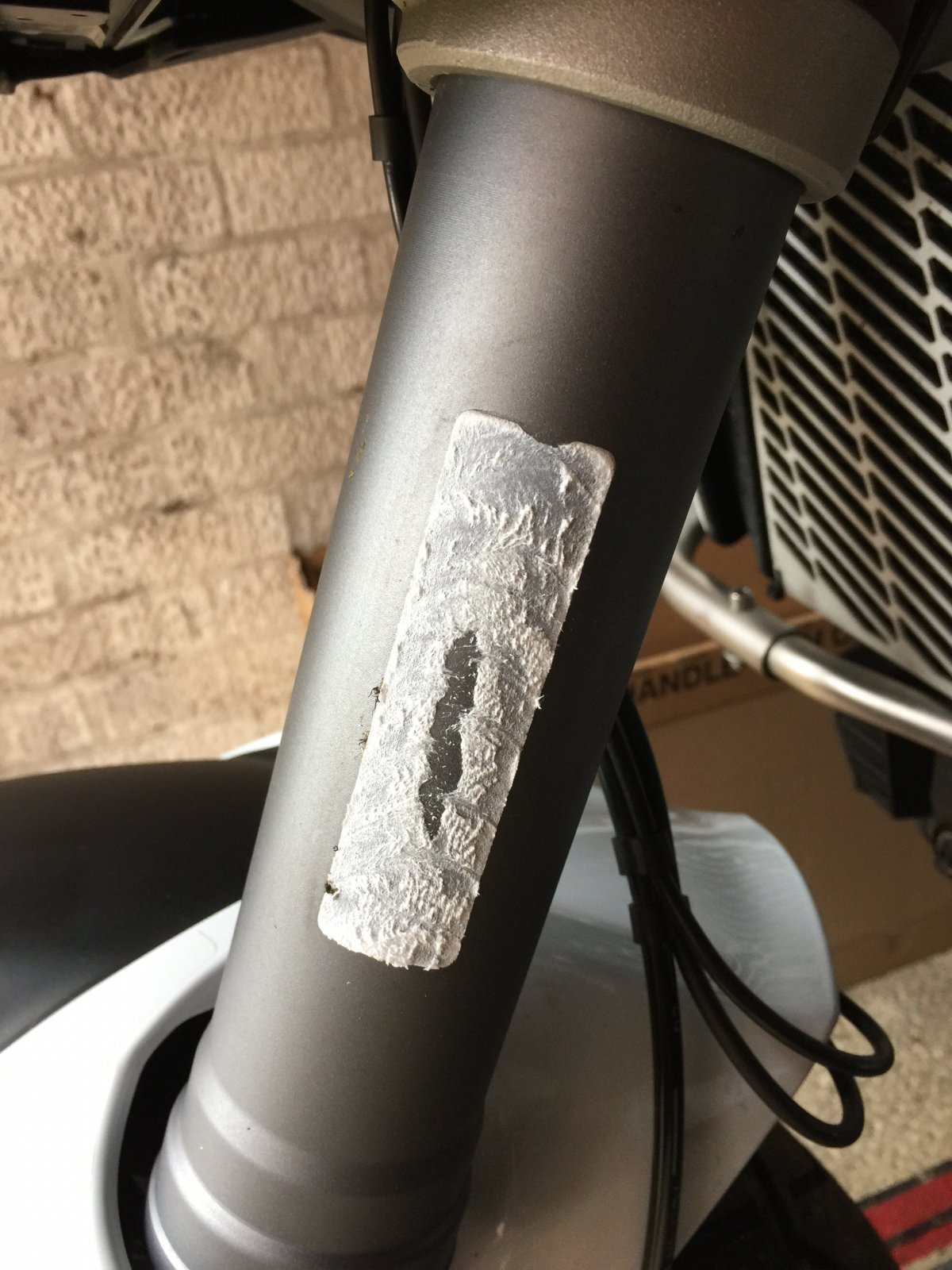

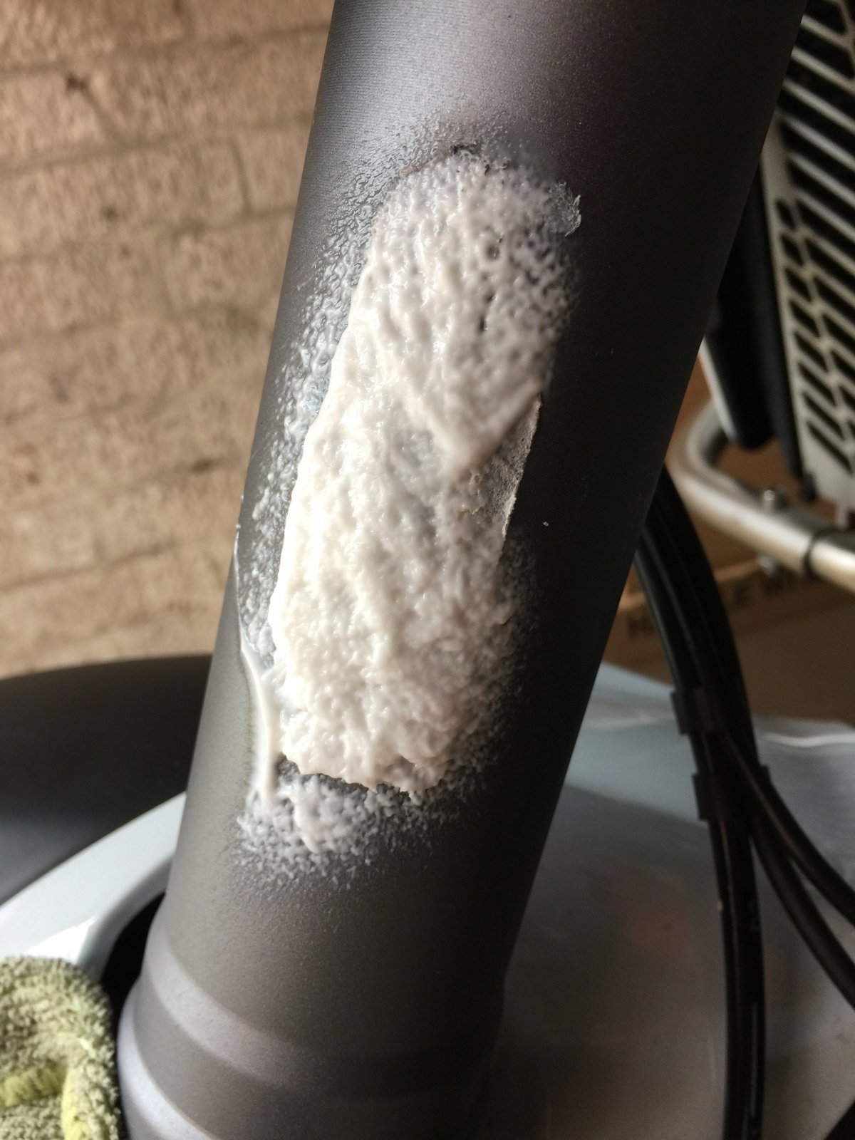

  1. Hi. i did removed mine with pulling zip tie between fork reflector, and removed the glue residue by using Kent brake parts cleaner 2
  2. i used a tooth flossing thing and WD40 it come off easy but then removing the glue was a difficult part
  3. Hi
    I also tried with WD40, but too much work :) so kent brake parts cleaner 2 is better, also paint safe. also you can clean your chain with it..

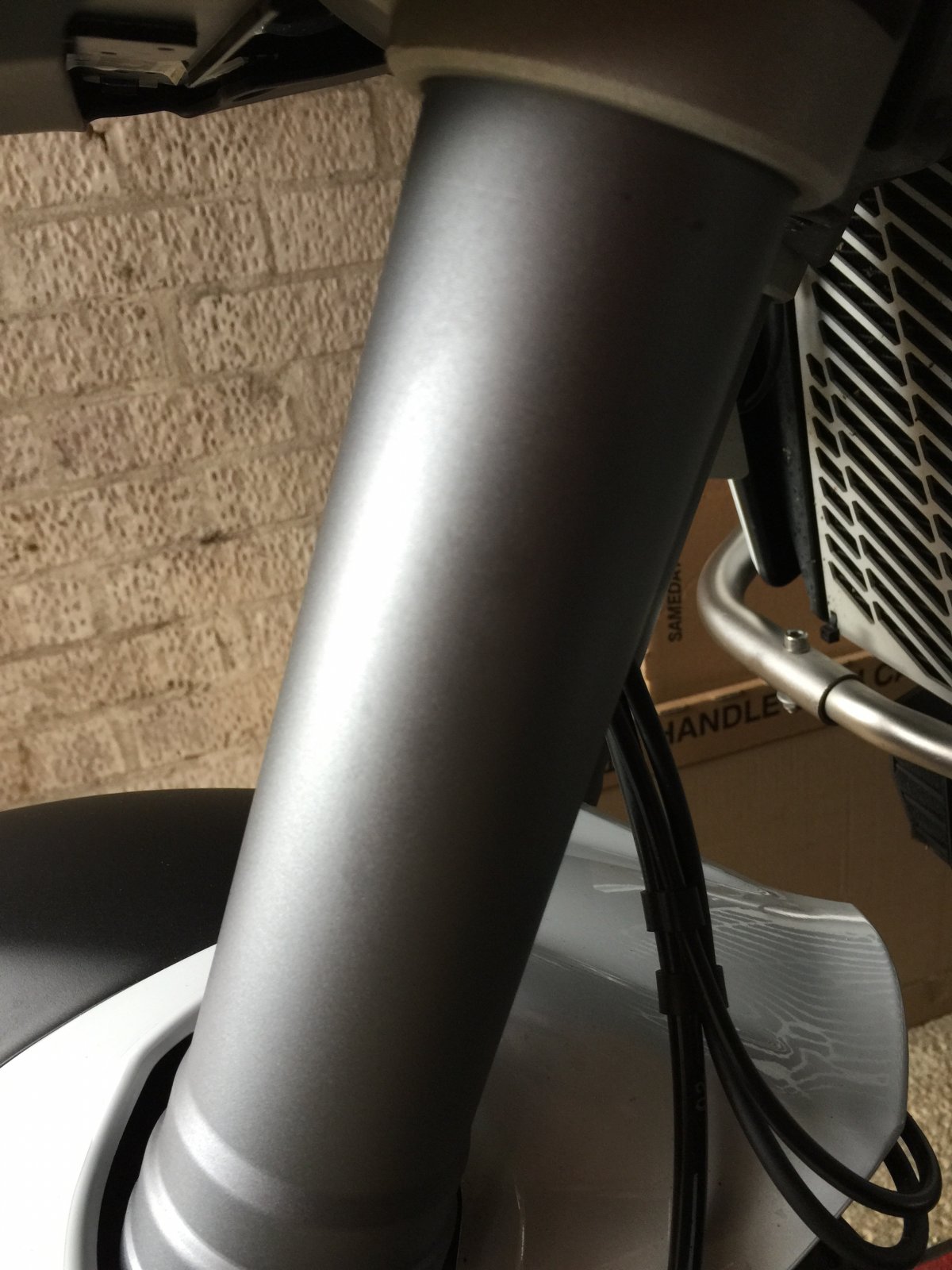

  4. Done mine as I think the reflectors are crap, took 5 secs to remove the reflector using fishing line and then coated the sticky leftovers in Pledge cleaner, left it for 5 mins wipe excess off and then used my thumbs to rub it off. Took about 15 mins then finally a clean with WD40 and Pledge cleaner. Smells nice too lol
  5. Jimvee, that bit of the fork leg is now to shinney :) When you doing the rest of it :)
  6. One day ;)
  7. That's better! [emoji106]

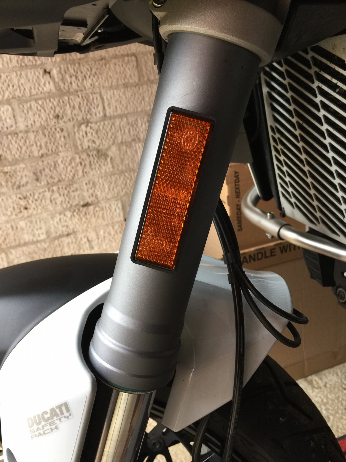

  8. This week I did the Ducati factory tour and the DVTs that were ready for final testing and inspection had these reflectors held on with tie wraps so i asked why and the technician told the tour guide its because the "glue" was still wet. That being the case, its more than double sided tape with contact adhesive.
  9. I like the fishing line technique. I was originally intending to use a Stihl saw/fire combination
  10. Didn't look like that to me. mines was held on with double sided tape, the stuff which is a couple of mm thick foam material. I've used that type of tape before, the glue melts in an acetone solvent, I used nail varnish remover.
