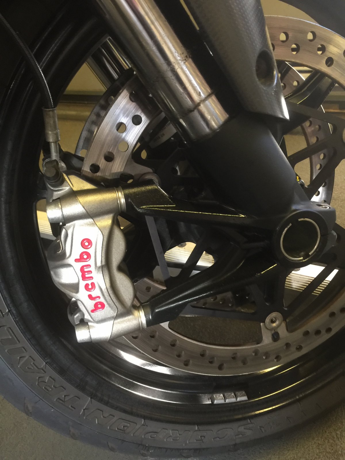

  3. Cant believe it, 500 miles after having the fork seals replaced, the right hand one has blown agian, ordinarily this would only mildly piss me off but I only noticed it on the Eurotunnel tonight so now in Amiens hoping to do a tour of the Somme sites but looks like I may have to find a dealer to sort this out.
    Come on Ducati, sort your frigging subbies out and get some quality parts. Spent best part of £20k+ on a bike and factory accessories to find a £2 part is bolloxed...AGAIN...not frigging happy

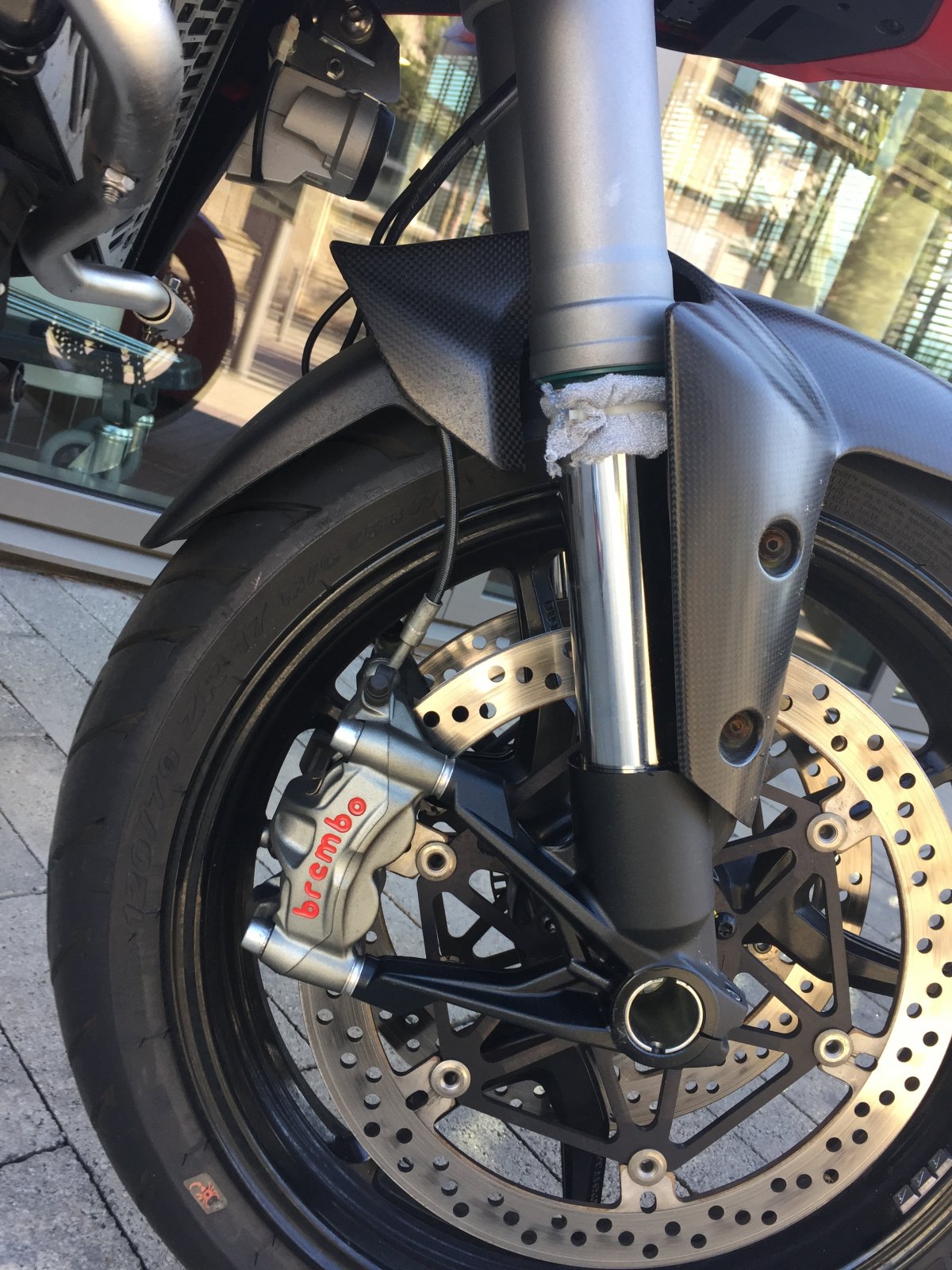

  5. Since you have no option but to keep riding until at least you can get it fixed, tie a piece of rag round the bottom of the fork leg to absorb any fork oil and keep it from running down into the brake calliper. It might look shite but it could save your life.
  6. It's the same on my pals XR , same manufacturer...
    despite it being fixed twice
  7. Cheers Derek, never thought of that, works a treat
