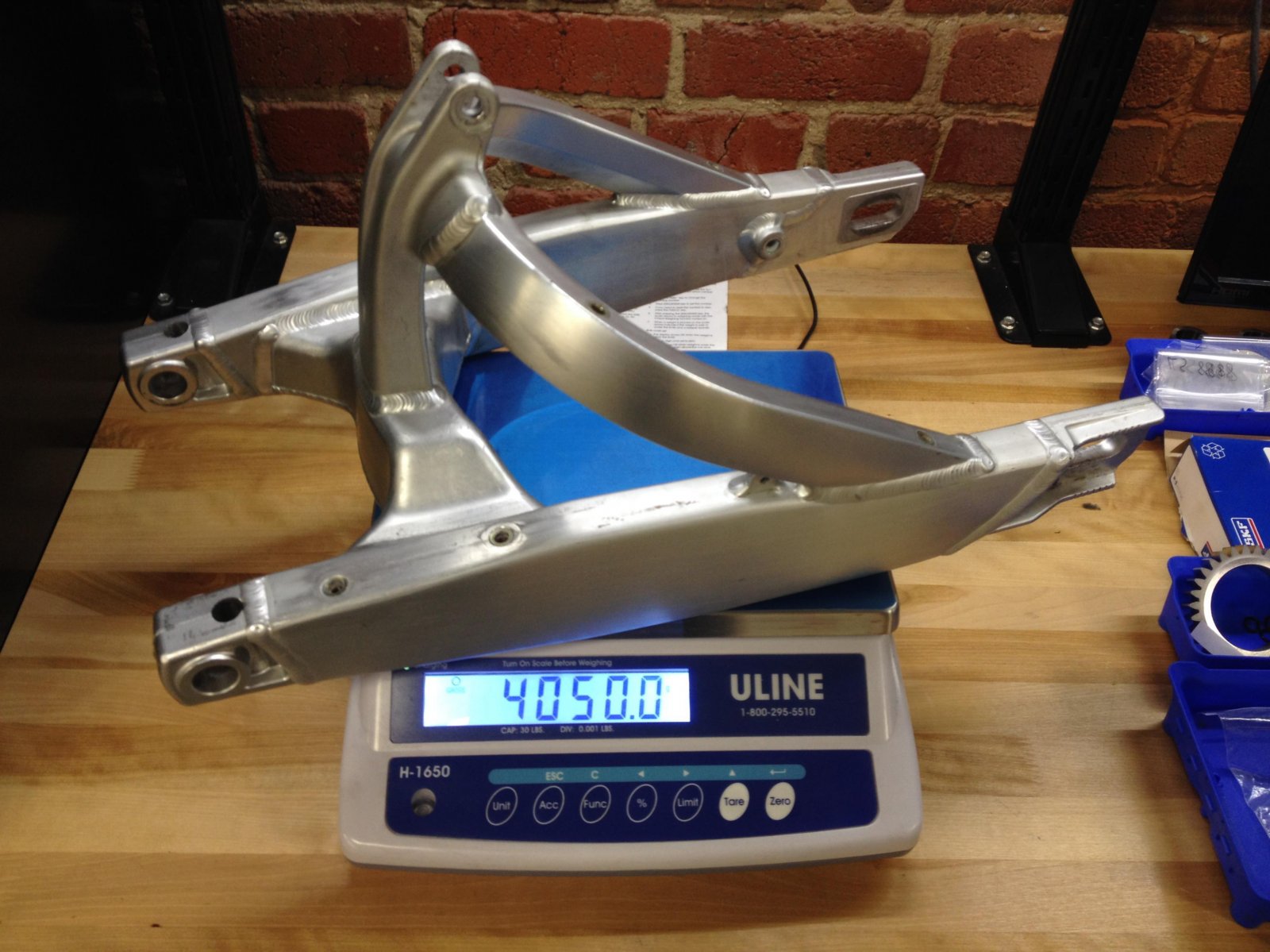

    Strong, stronger, strongest:

    I have the original swingarm and he mentioned the one on was slightly different so I'd assumed it was a stronger newer one.
