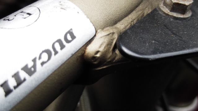

  2. Another victim of SS frame cracks here :( - Had a real close look at mine after a ride out at the weekend '97 900 @ 22K - Almost imperceptible cracks only just visible propagating from the ends of the weld on the tank clip mounting which is acting as the stress raiser. I will try and get a picture as it's really early stages it may be a good visual tool for others to compare with. The way it is cracking I don't see any cross bracing across the top of the frame helping much as I suspect its caused purely by the vertical movement of the headstock. Hard shock settings heavy riders / pillion riding are probably what bring on the cracks faster than anything else. I think the best fix would be the "X" fix mentioned above by 470 four which is what I will do - "eventually" dont use the bike enough and too many other projects on currently - For the moment I will stick a 2mm drill hole at the end of each crack and monitor for the rest of the season.

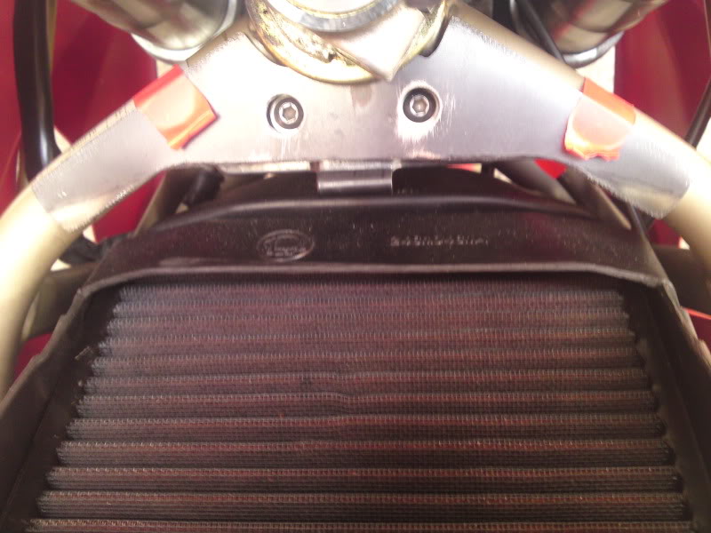

  5. Yet to get this welded on... early photo of my infamous "Space Invader" plate - allows removal of the tank clamp thingy & also svelte enough to allow airbox removal.
    Now the house move is done I'd better add this to my to-do list!

    Cracks - what they look like and what to look out for.
