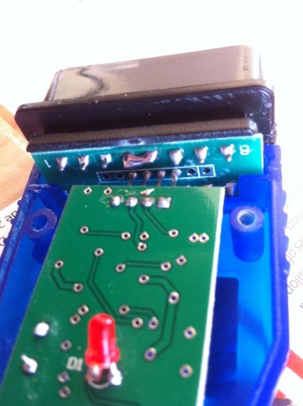

    If anyone does find that they have the Winchiphead lead then you need to do a modifiation by making a solder bridge between pins 4 and 5. The picture below shows how

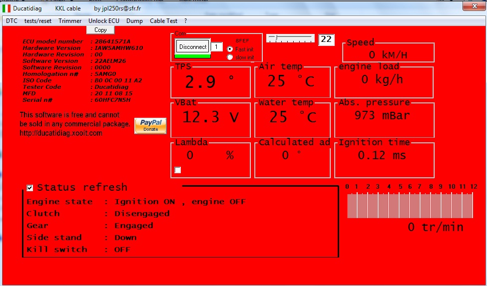

  5. That's an IAW59M so JPDiag will fully function for you without the need for a licence. Once you connect JPDiag to your bike it will display the ECU information. (The below is for an IAW5AM. The IAW59M will show Pas de No de Serie as it does not have a serial number)
    As a rule of thumb, IAW59M's were used 2001 to 2004 and IAW5AM used after 2004 (but an IAW5AM will work on a pre-2004 bike)
    Use the 'Slow Init' setting for the IAW59M

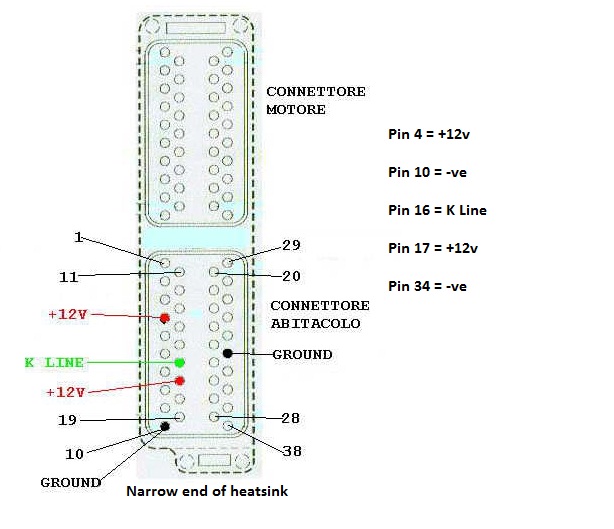

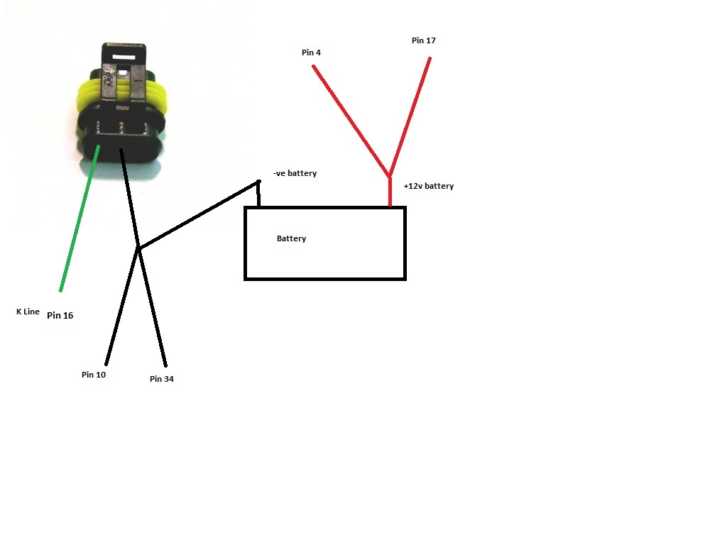

  7. I'm assuming you have built the 'simple' connector. Apologies for the picture, but it should resemble this
    The pins you need to connect to are
    Pin 4 = +12v
    Pin 10 = -ve
    Pin 16 = K Line
    Pin 17 = +12v
    Pin 34 = -ve

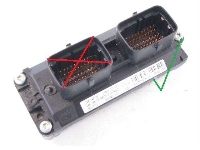

    The side you connect to is where the heatsink screws are closest together
    Connection technique also plays a part. Do not connect +12v until you have pressed 'Connect' in the software. Then connect +12v.
    For IAW59M use 'slow init' and IAW5AM 'fast init'
    If this doesn't work PM me.
