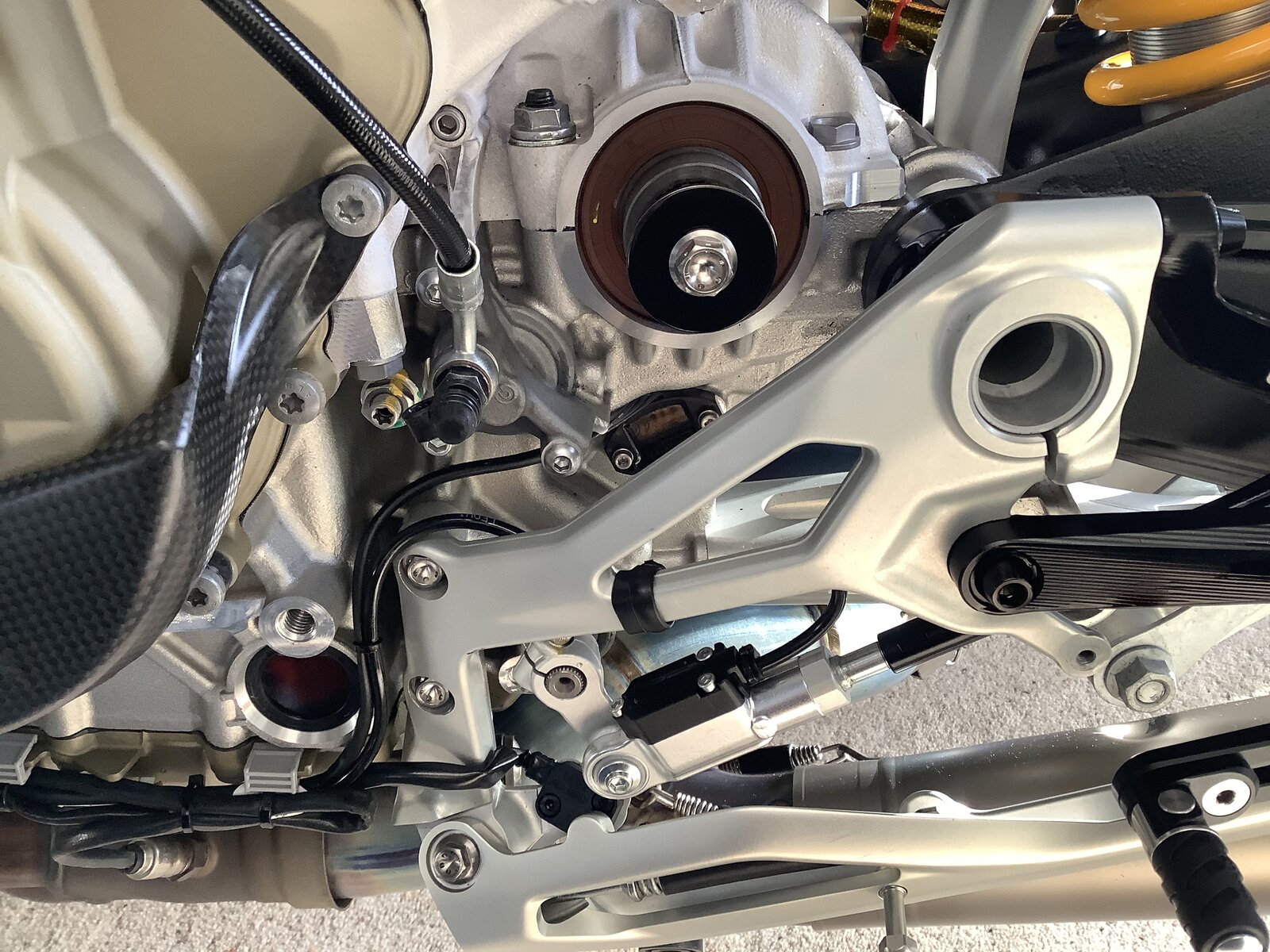

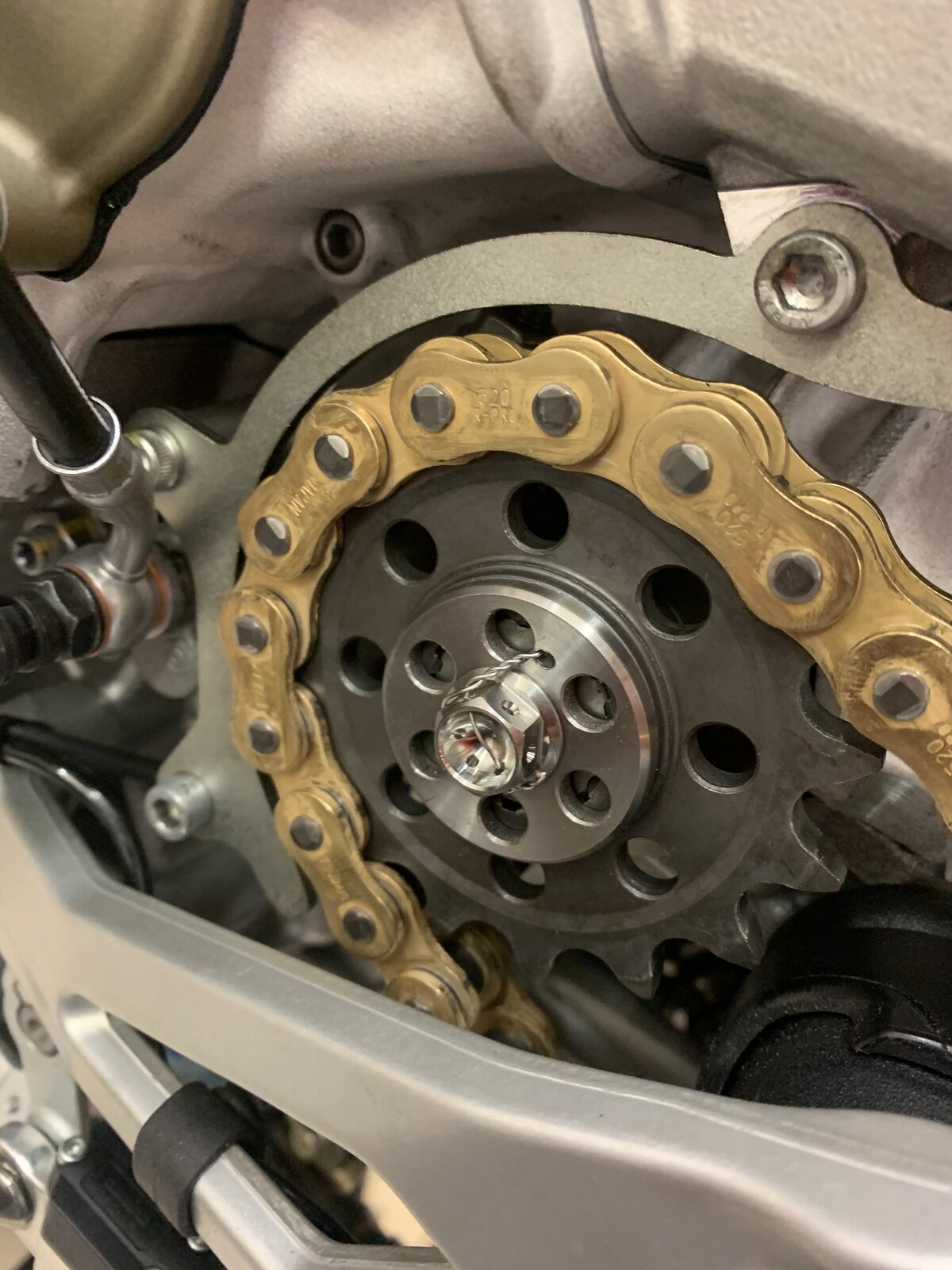

  2. People who live in glass houses shouldn't throw stones. My apprentice master would have had a fit with that wire locking, it's atrocious. Andy

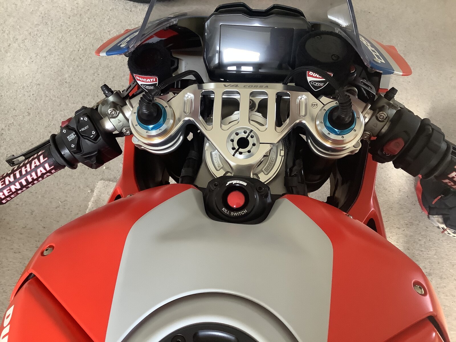

  3. The top yoke is a work of art:upyeah: by far the most beautifully engineered part at a reasonable price....

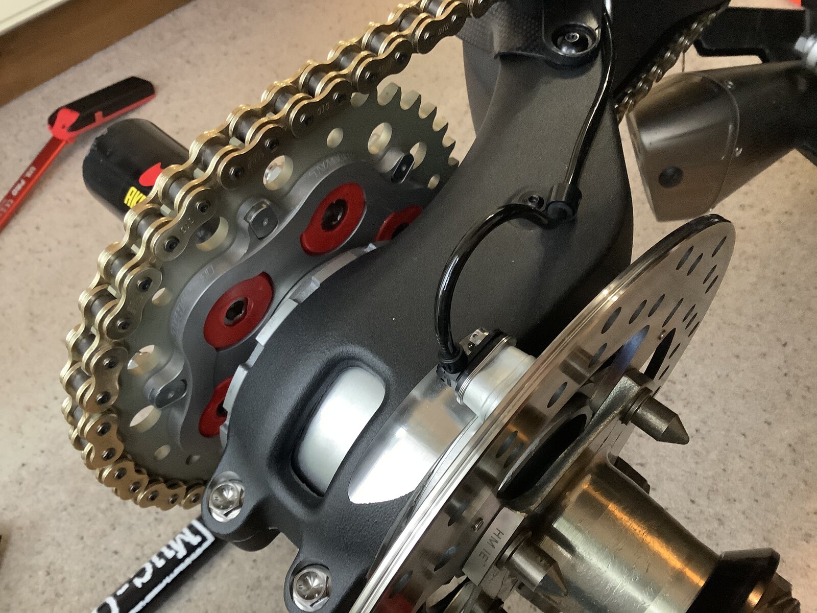

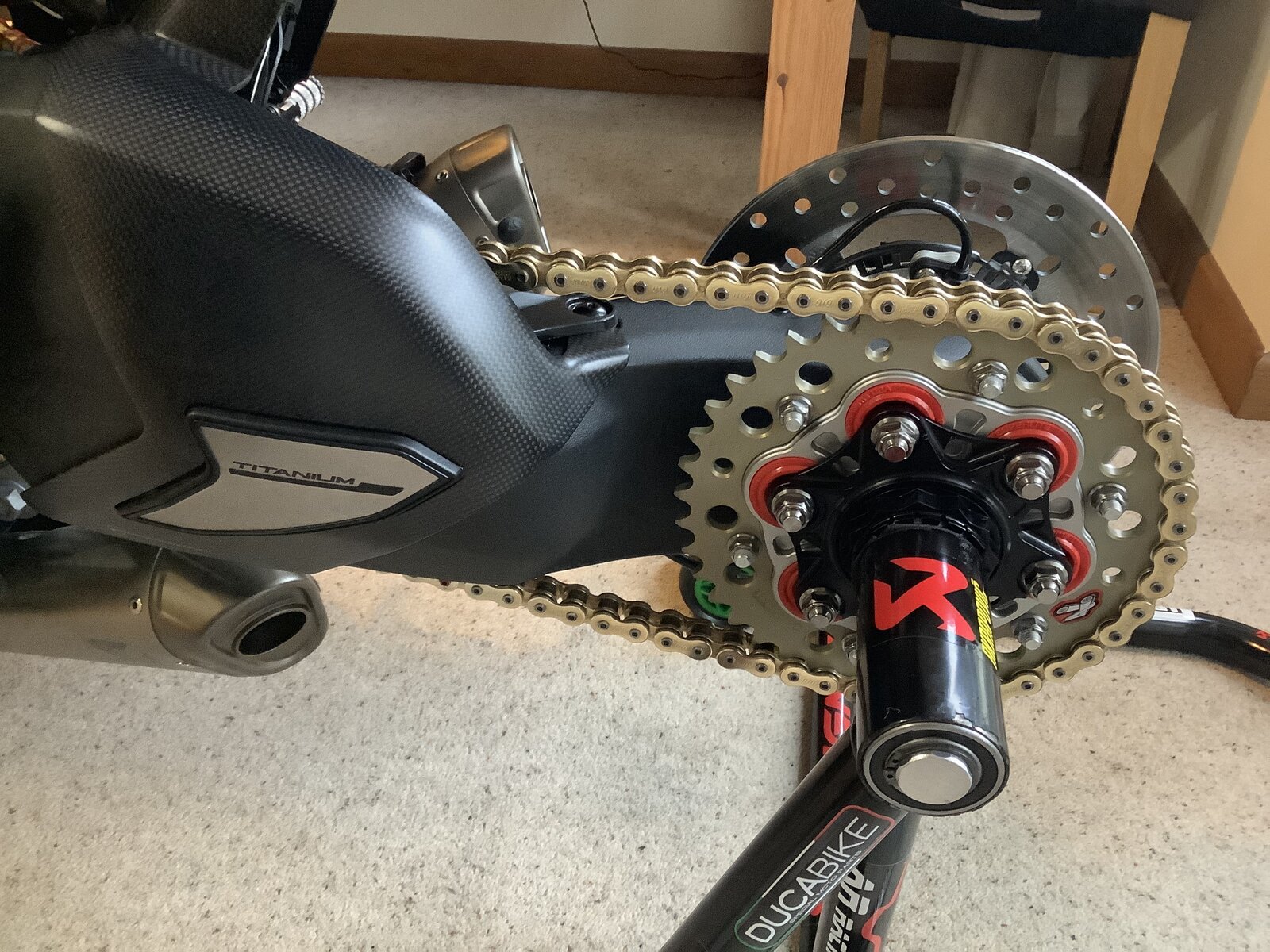

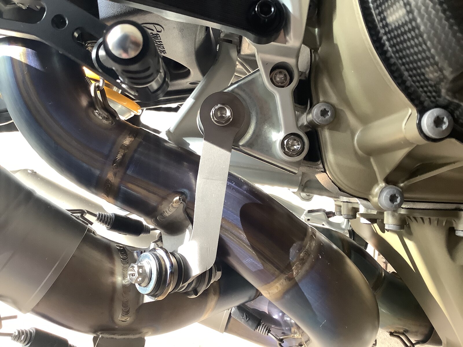

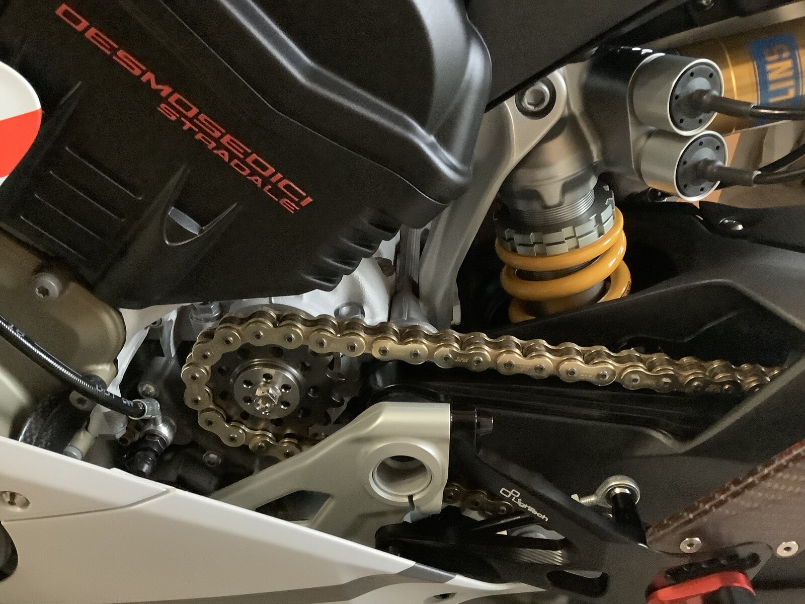

  4. The weight saving from the drivetrain is quite remarkable:eek: especially with 520 conversion. Also replaced all the larger fixing bolts with Ti items, including exhaust bolts...

  5. What are you actually getting from a 4 -500 quid investment in that top yoke other than it looks pretty......i know the offset is already at 30mm std but i would and will look to pay a bit more and get a set of yokes with the adjustable inserts...IMA for example
  6. Does look nice. And I like that ejector seat button. Fuck! I’m gonna crash! Whooooophhh!!!
  7. Nothing other than pure indulgence! It is obviously lighter.... I wouldn’t have paid that amount! Think it worked out just over 300 sheets.... I got a couple of hundred back on my old Ducabike one from the 959 so it had to be done:punch:
  8. I'm not professional rider to try and feel differences in offset, why would i pay even more for something that i don't aim too?
    I'm only looking for different and pretty look with this top yoke. For 330£ it does the job very nice and enjoy what i have :upyeah:
  9. It looks awesome and that kill switch match very well!!:upyeah::upyeah:

  11. From memory with the drive train... so DID ERV3 520 race chain, Renthal lightweight front and rear sprockets, Front sprocket - one tooth less... Renthal lightweight carrier, CNC flange, plus both hub and rear wheel nuts, lightweight Polly Cush drive with Ti pins, Grade 5 sprocket nuts plus Ti flange nuts, and 2 Ti lock clip rings for wheel nuts, 1 TI front sprocket bolt and washer. Almost equated to half the weight of all the OE a components removed.... Significant reduction in moving mass.....
