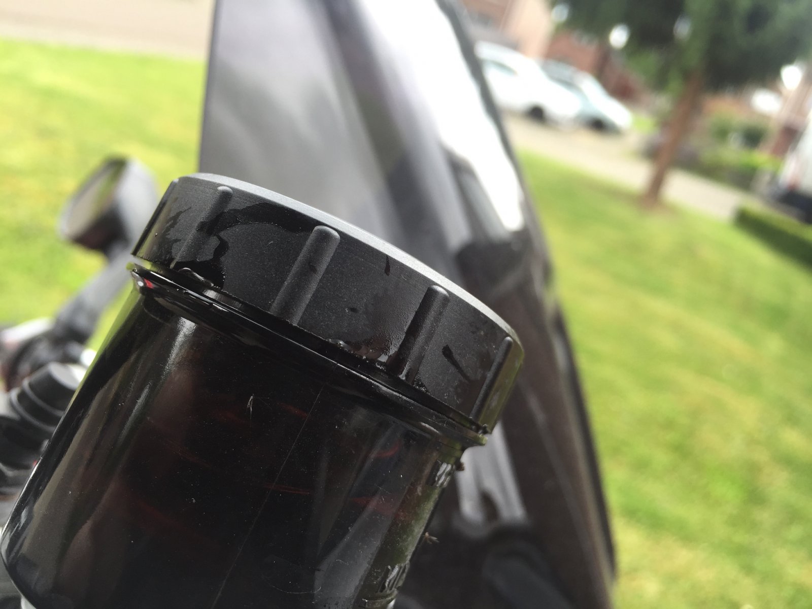

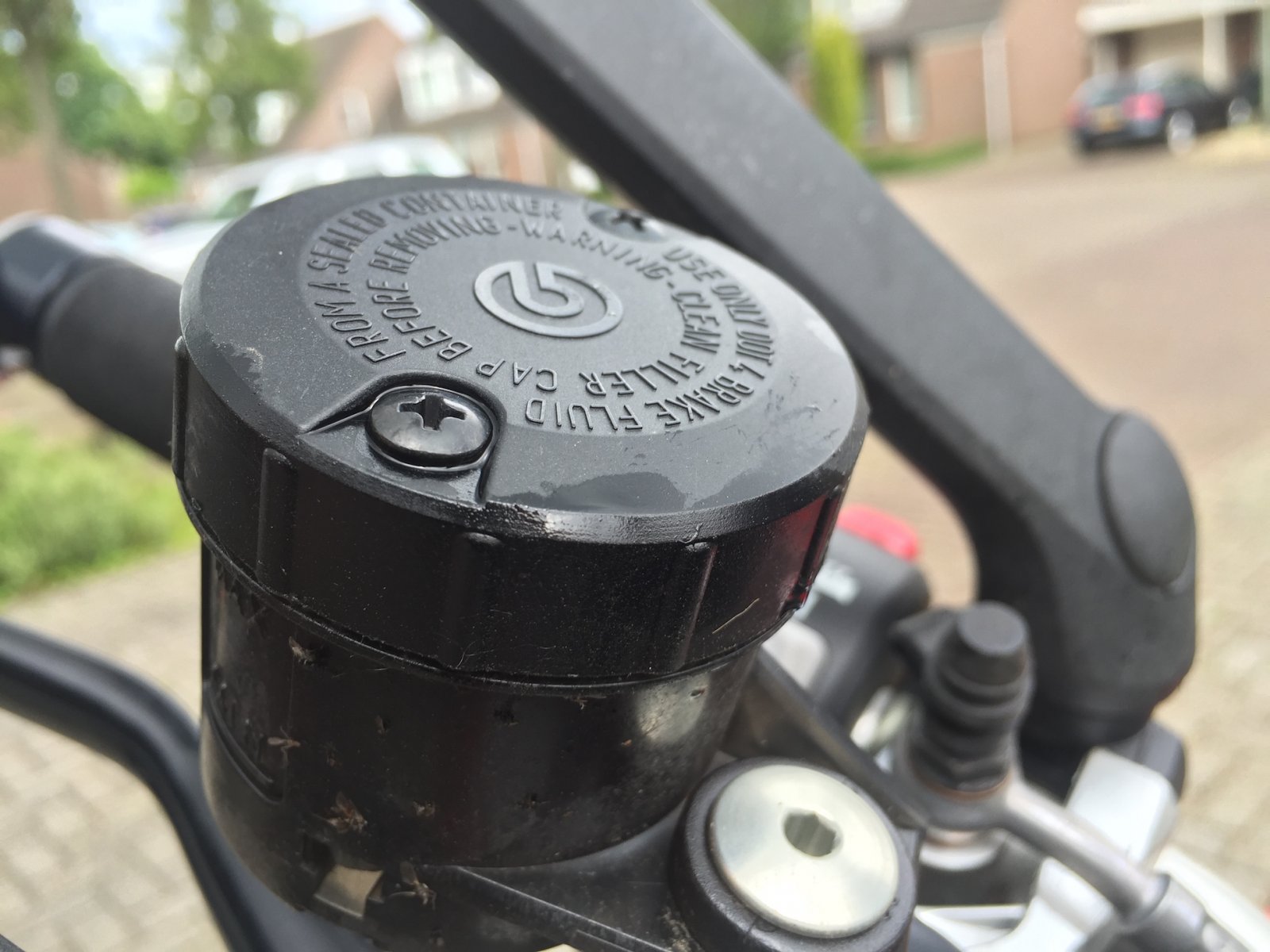

  3. same problem over here.
    have emailed my dealer, lets wait what and see what they think of this.
