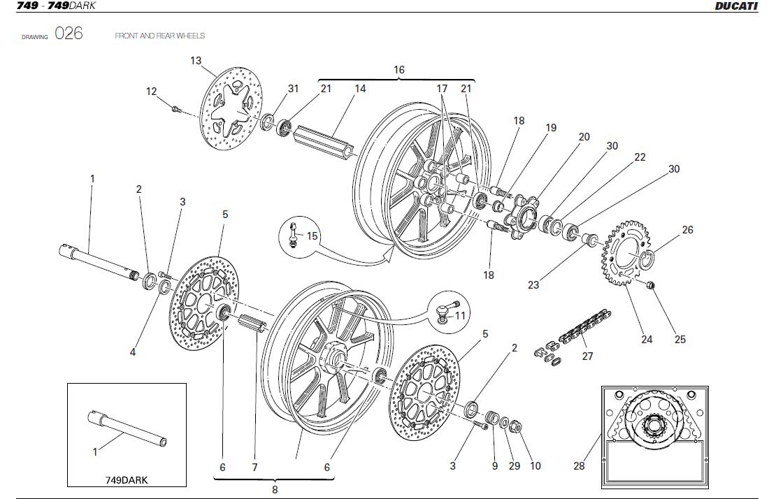

  1. The spacer goes over the spindle!
  2. Yes there are spacers...done that myself ;)
    Quick google, its a 749 but cant imagine its that different most ducatis the same
