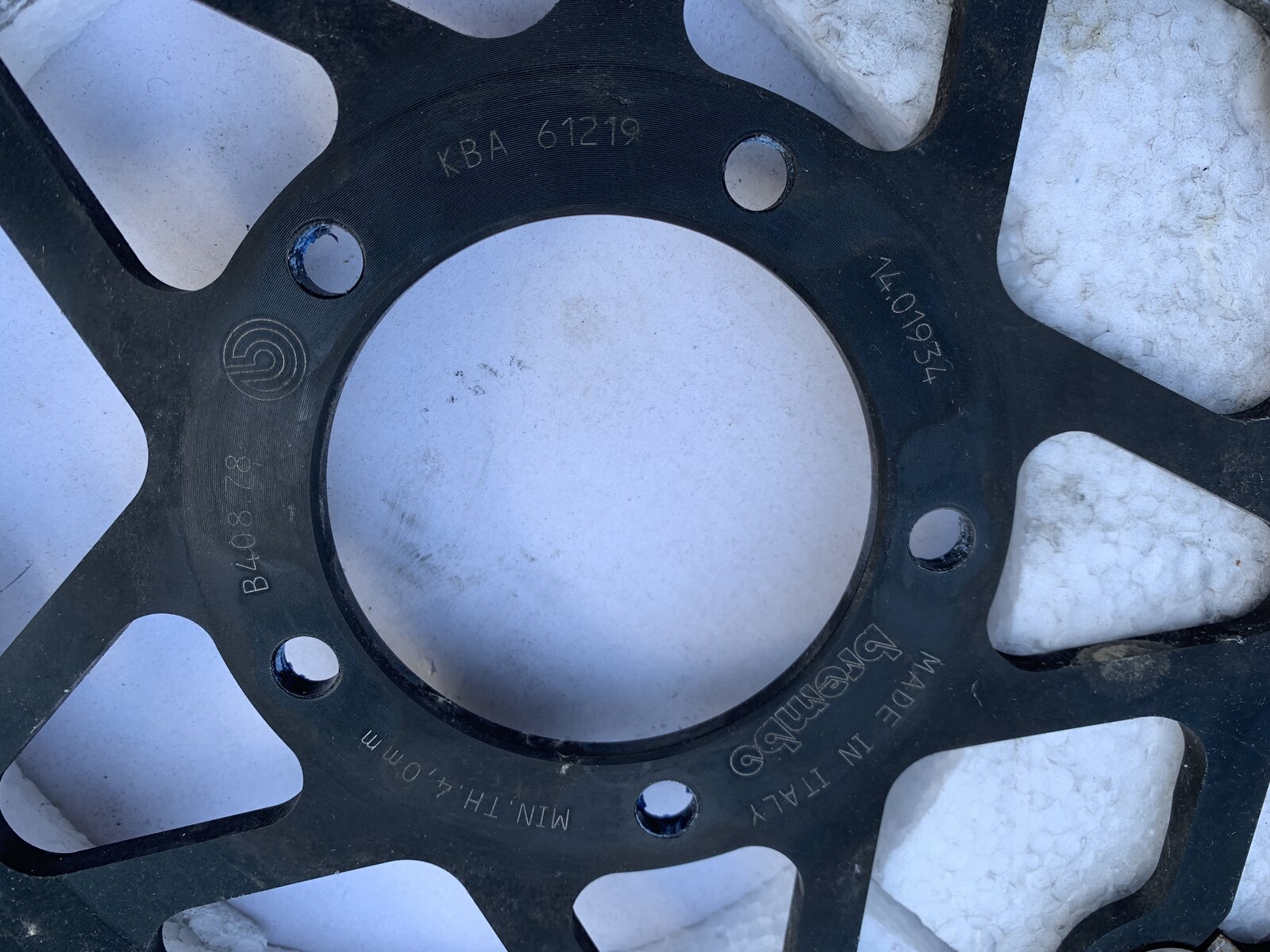

  9. Ok, I received the reply from Brembo, the correct code is the one I wrote, the 78B408A4 , the other one in the link was the 320mm one, 4,5mm thick.
    I confirm, it is the 330mm x 5mm thickness.

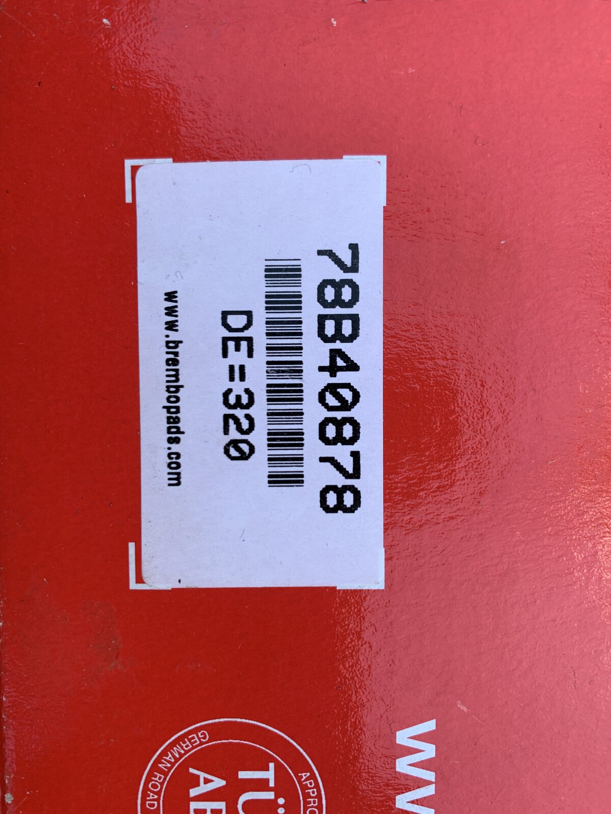

  10. Awesome, thanks for that.
    The 320mm discs I purchased fit perfectly, the product code is 78B40878 5.5mm thick
  11. Brembo told me it was 4.5mm thick, their papers are a bit confused sometimes :D

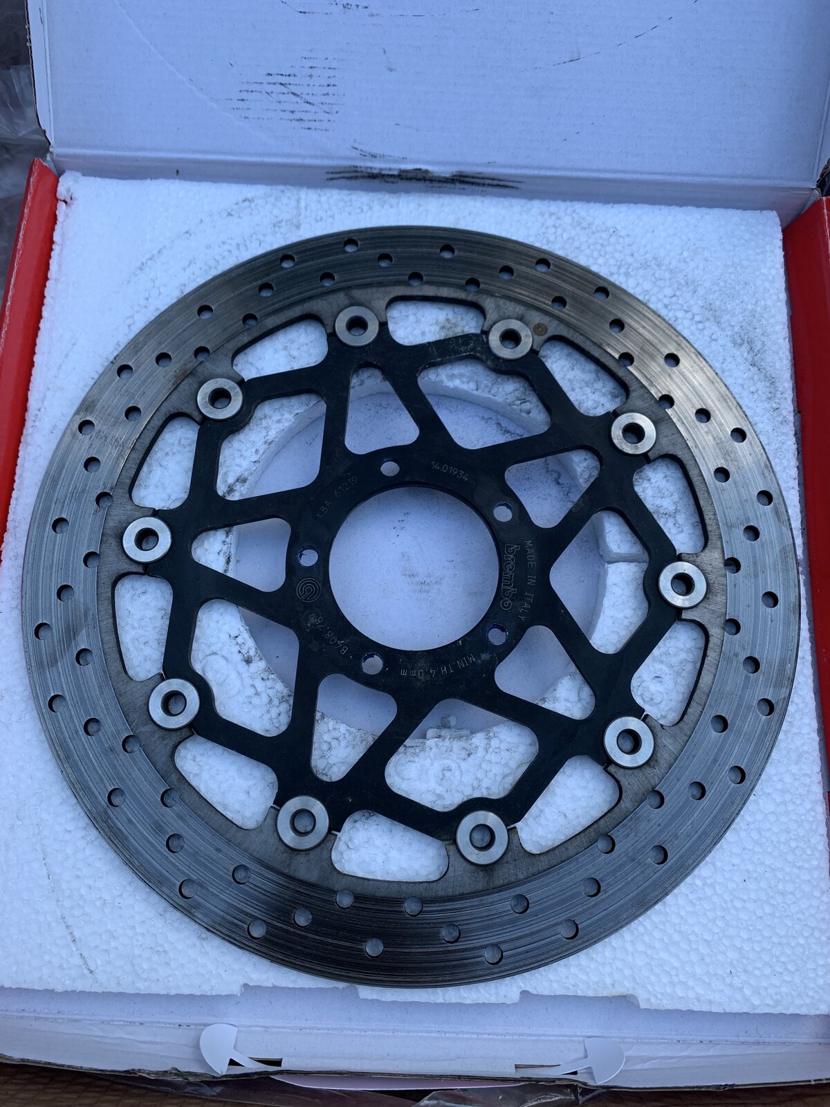

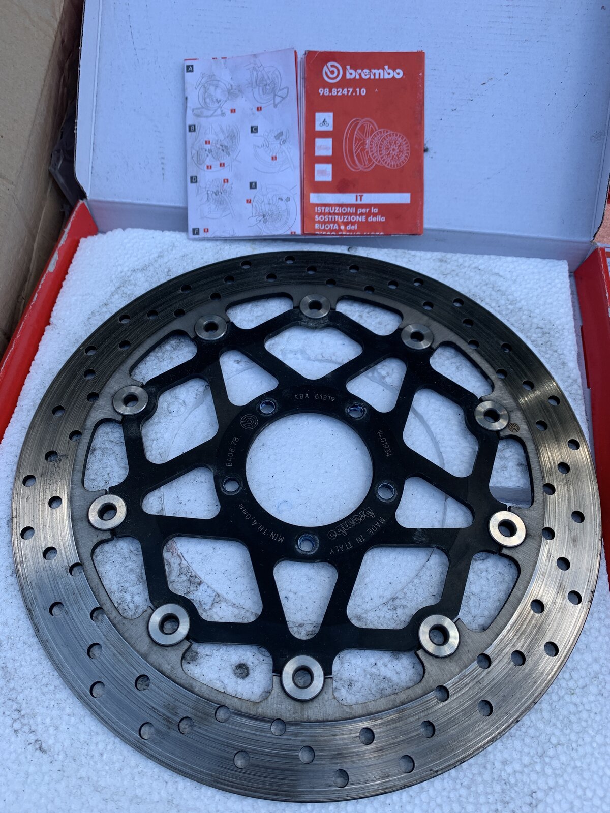

    317C3553-6A3B-4955-A46D-9FF84E496241.jpeg 516080A7-68A7-45D1-91AA-B5E02975DF9B.jpeg 1685952B-6851-40CD-B765-2ACA273D7621.jpeg 1F3FFC78-CEE4-42FE-AEC7-4DDB60099C09.jpeg 71459E84-19DD-47C0-9041-67CD992ECD8E.jpeg
  16. what’s this about upgrading the rear brakes on a multi? I’ve got a 2017 S touring, is there a disc and calliper upgrade available for that?
    So it’s looking like I too am going to have a set of used serie oro 320mm discs for sale, I’ve got my MOT booked in for tomorrow, so they will have about 10miles wear on them.
