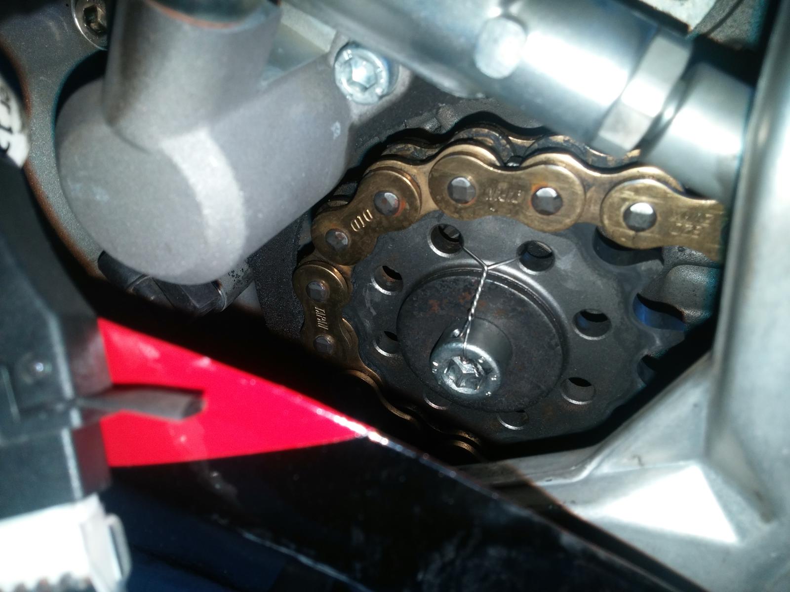

  4. I would NOT recommend using a "permanent" Loctite grade of threadlock. They are designed for one thing....a permanent fixture. Some allow removal with the application of a lot of heat, but you then risk damaging the output shaft oil seal in the event you have to remove the allen bolt, or worse, it shearing off and having to have its remains drilled out or spark eroded. I would drill the head of the bolt laterally and drill a couple of corresponding holes in the sprocket, then lockwire the two together. Cheap, effective and easy to remove when you are due new sprockets/chain. Here's an example of an 899 with a lockwired sprocket/bolt. Whilst it is not an OEM sprocket, you could drill the OEM one and achieve the same results if necessary. BTW @Tim9, I have a low mileage (less than 1000 miles and no discernible wear) renthal lightweight 15 tooth front sprocket hanging around somewhere that I was going to sell for a few quid. If it's of interest to you let me know.

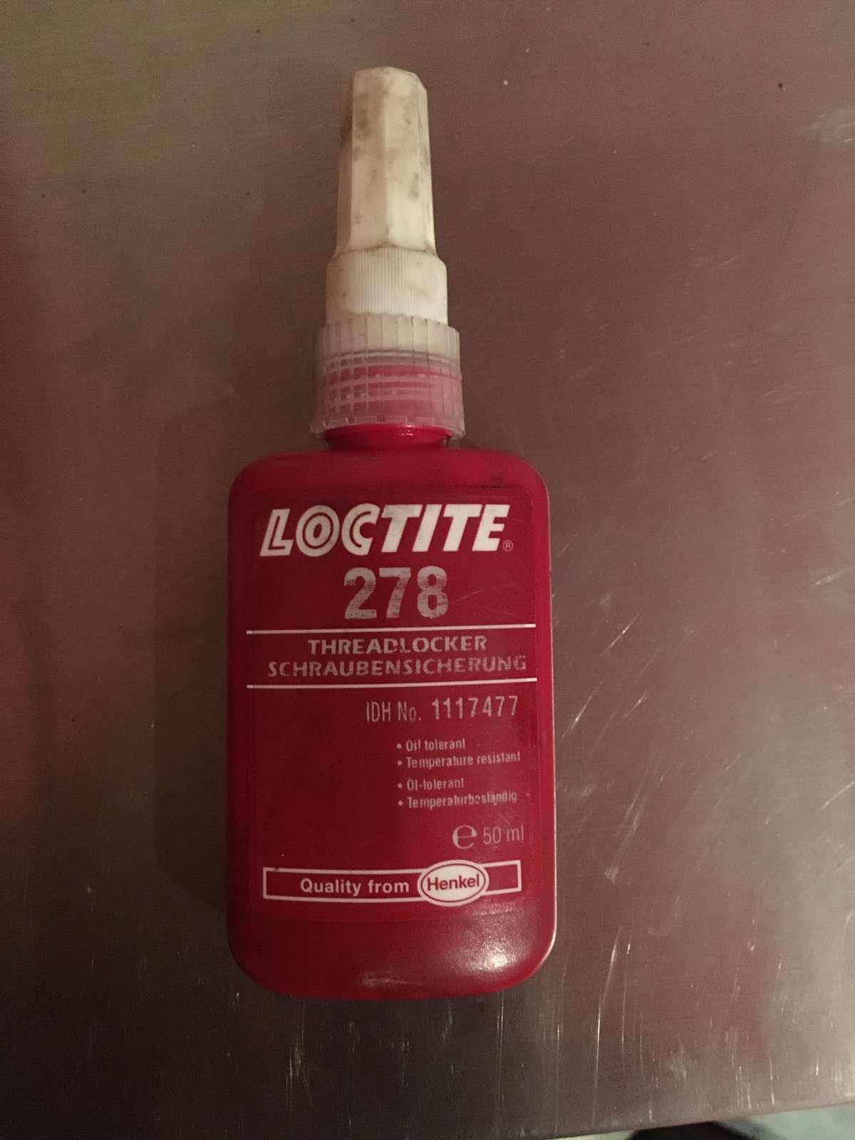

  13. Pete 1950, Im particularly fond of this type of threadlock. IMG_0830.JPG IMG_0830.JPG
