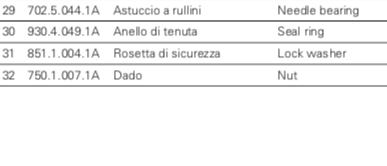

  8. Screen Shot 2020-11-23 at 12.24.54.png Screen Shot 2020-11-23 at 12.25.07.png

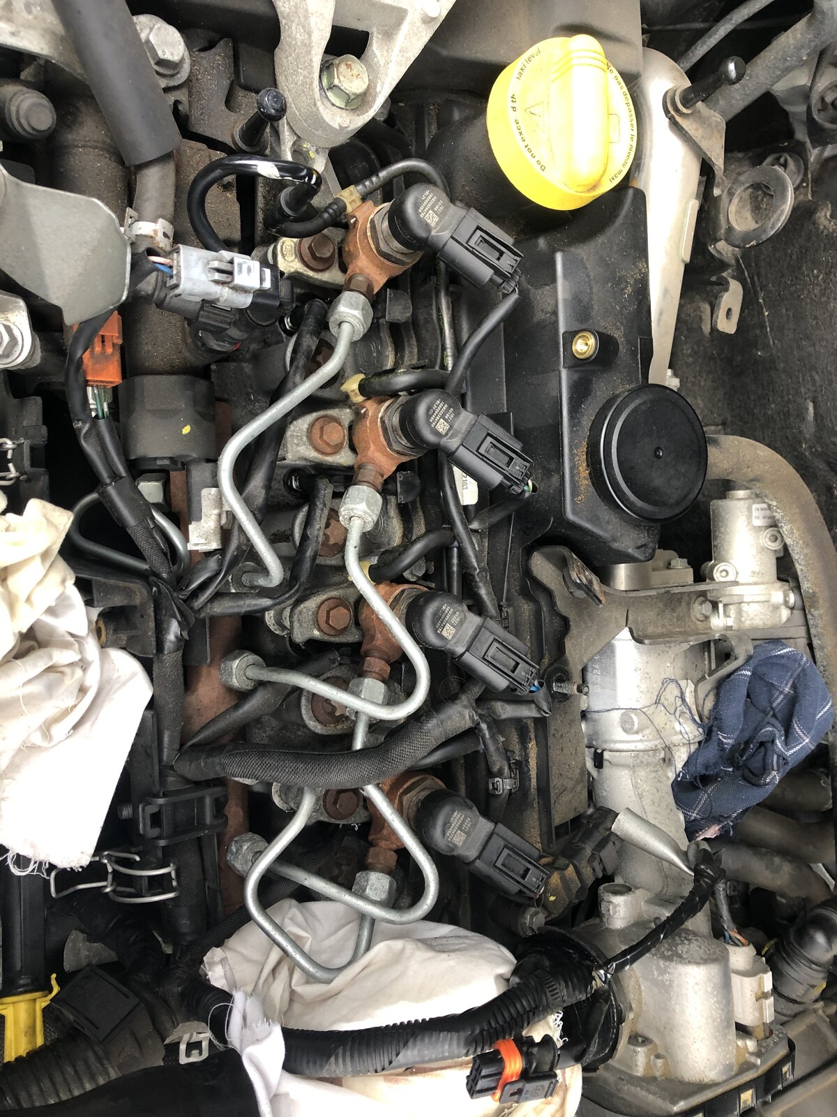

  11. I would hazard a guess that was a Renault motor ?
  12. Yup- glow plugs. The horror, the horror...:skull:

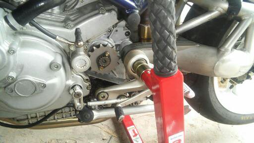

  13. So when did Ducati change the retention of the front sprocket?
    Both my '97 900SS and my current '05 S4R have the sprocket retained by a plate, which rotates in a groove half a spline and is bolted to the sprocket, as per the photo. Never been a problem to remove or caused a failure.
  14. I’ve managed to grab a copy of a workshop manual and it’s a toothed washer with a tab. I’ve ordered one online and hoping it turns up for fitting this weekend.

  17. I agreed with Sparch’s post as to what should be there but I also know that if the retaining washer on mine had flung itself off at some point the b’stard sprocket still would not have budged
