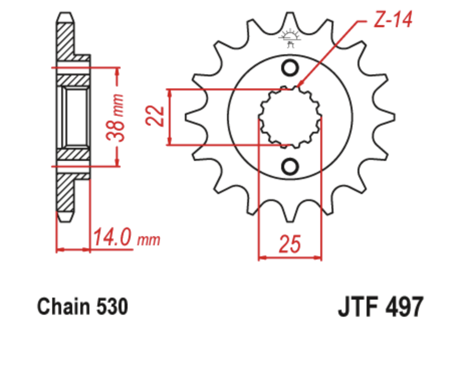

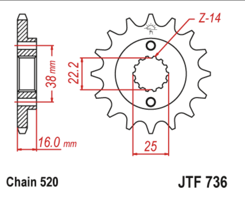

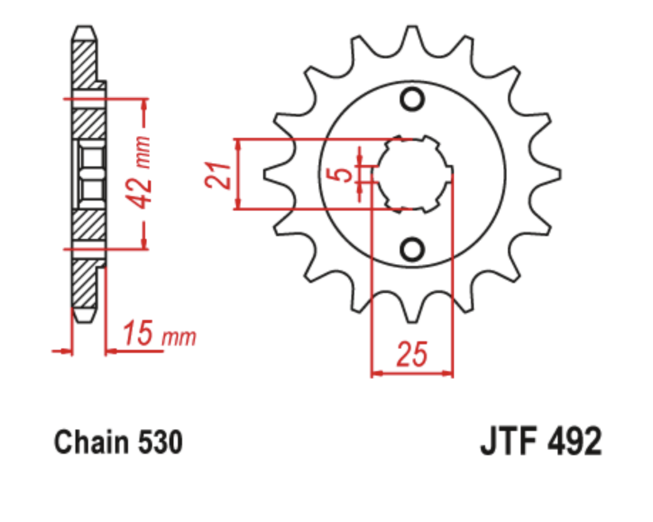

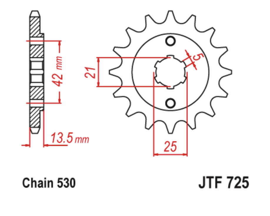

  4. Beware with replacement gearbox sprockets. They come with different offsets depending on what model they are for.
