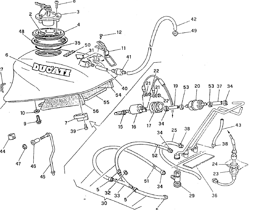

  1. To the OP. Check item no.43 in this diagram. It is a rubber tube that connect the boss in the bottom of the tank the drain stub on the bottom of the filler cap. Outside the tank it connects to the rubber tube. If it is split, or has come off at the filler cap, fuel will leak out continuously until the level drops below the hole or the upper end of the tube.

  4. Full marks to Rhubard & Custard and Derek - the hose had fallen off the spigot and was sitting in the fuel providing an open pipe to drain the tank.
  5. Great news, at least my theory only cost you £3.20, I’ll go and sit in the corner for a while.

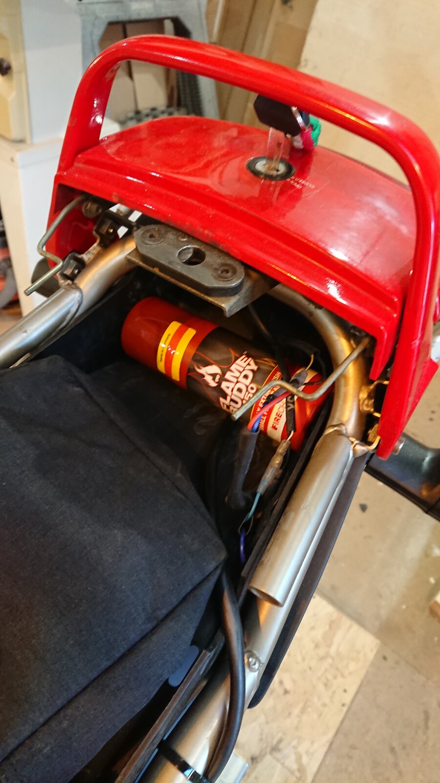

  10. What a rotter. On the "what tools do you carry" idea I give you the mini fire extinguisher that fits under the seat.
    https://www.screwfix.com/p/firechie...-chemical-fire-extinguisher-spray-150ml/387fv
