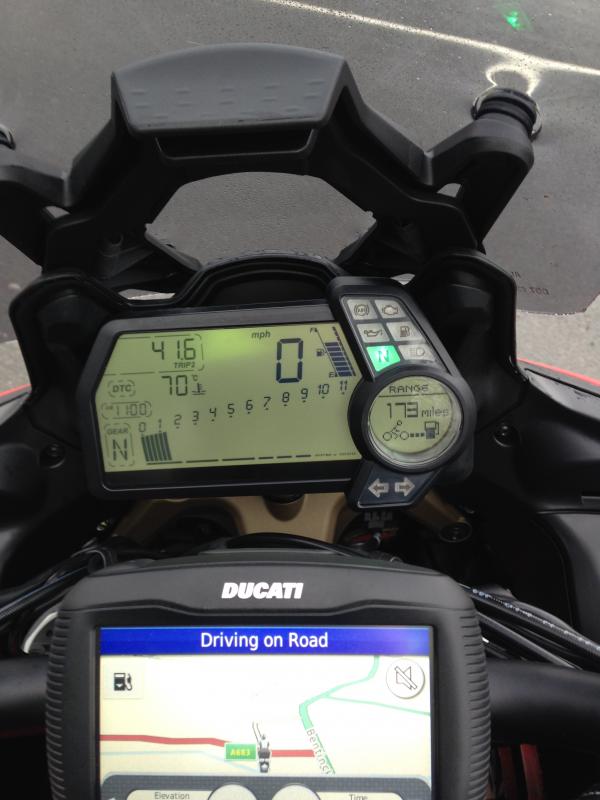

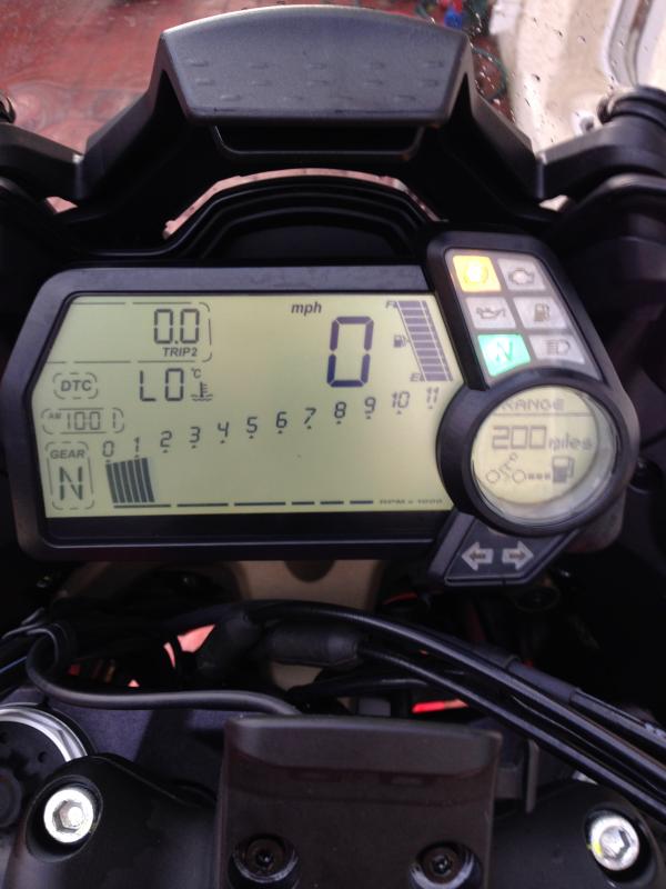

  4. Ok So today was supposed to be a nice day, So I took it upon my self to test my tank range just to see if my light was coming on early and if after a brew stop the gauge read the same as it did when I'd pulled up,
    I brimmed the tank and took this photo.
    Then went to the first burger bar Devils Bridge
    it read
    The Rang isn't totally accurate but hay ho.

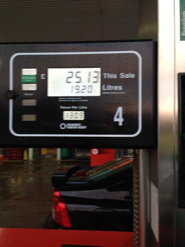

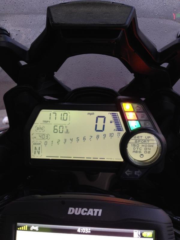

    I stopped at one of the most expensive petrol stations in Cumbria after my last bar started flashing and my range meter went to 0 and started flashing.
    here's the photo after I filled her up again.
    This is how many ltr's I got in after the range flashed 0
    171 miles to a full tank
    God know how my light kept coming on at 104, the only thing I can think of is that in an attempt to get as much fuel in for the range test I stud the bike upright to fill her and kept going until it was going to over flow.
  5. 19.2 litres = 4.22 imp gallons 171 miles = 40.5 MPG
    So 20 litre tank = 4.4 imp gallons giving a theoretical range of 178.2 miles.
    Reserve light came on at 130 miles which if you are getting 40.5 mpg means you have used 3.2 galls = 14.5 litres leaving 5.5 litres left in tank. So light on 5.5 litres left not too far away from book figure.
