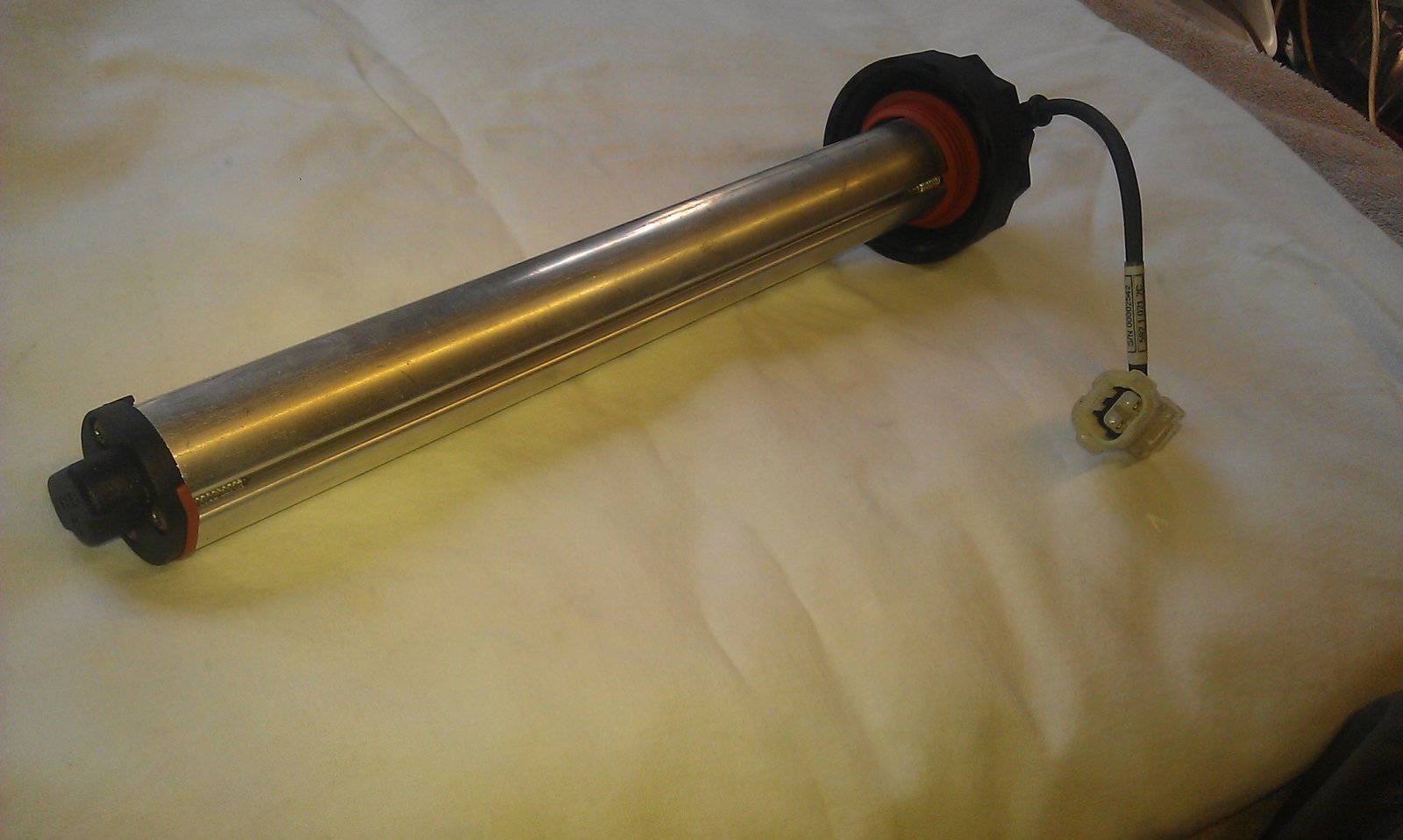

  19. For information, here are some pics of fuel gauge sender part no 592.1.021.2C (now superseded):

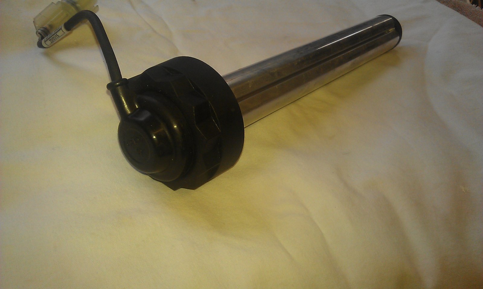

    Here it is from the connector (bottom) end. The cable has a label which helpfully gives the part number, so you can't confuse one version with another:

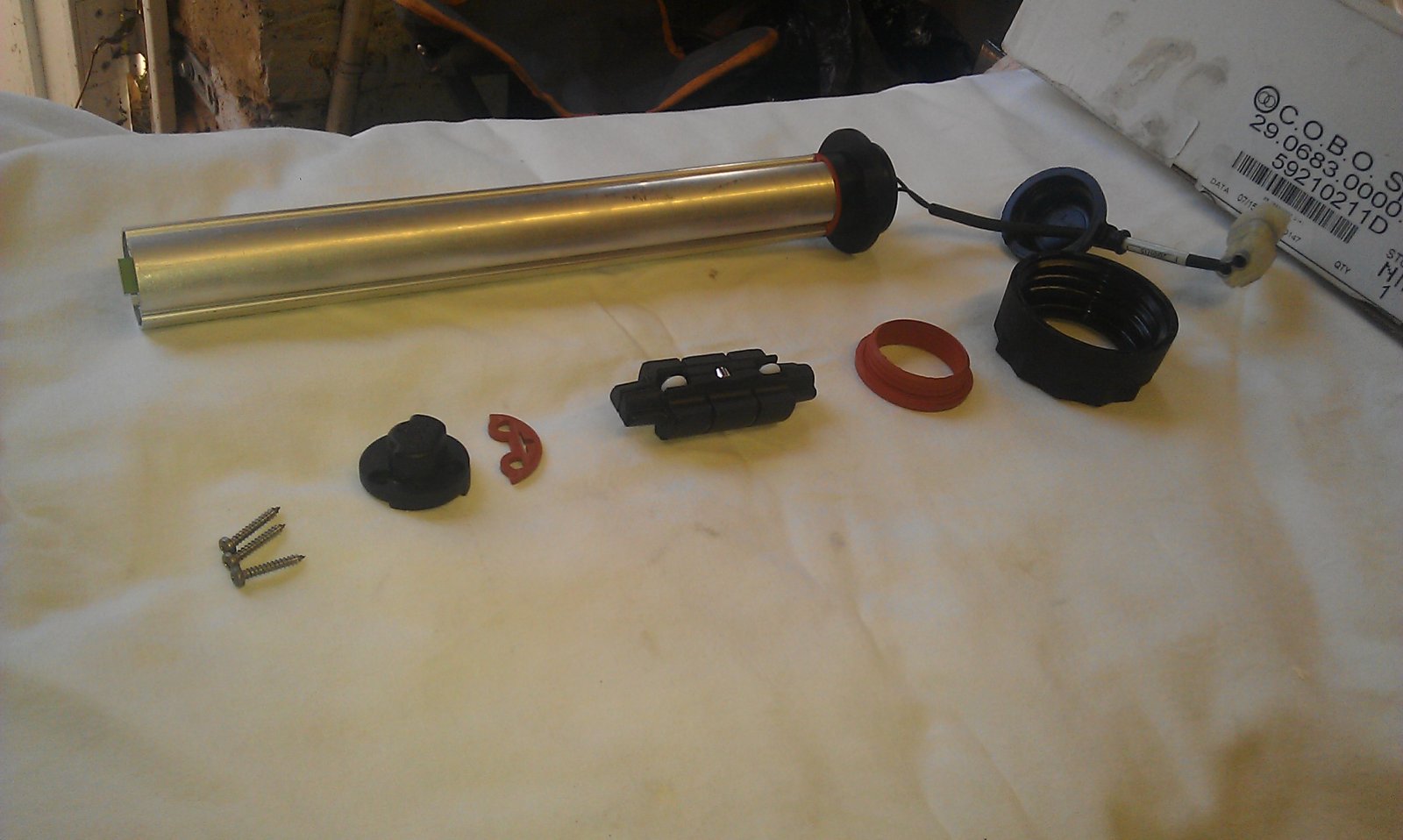

    Here it is in bits:

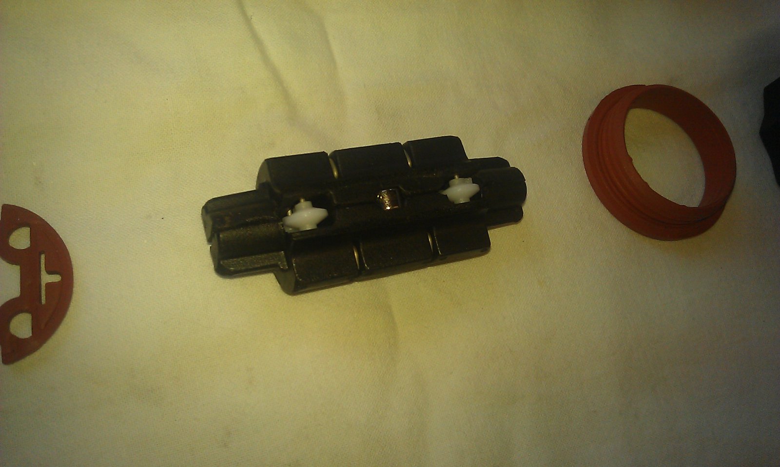

    This is the slider-float. Held vertically, it slides up and down very well. Held at an oblique angle, not so much.
