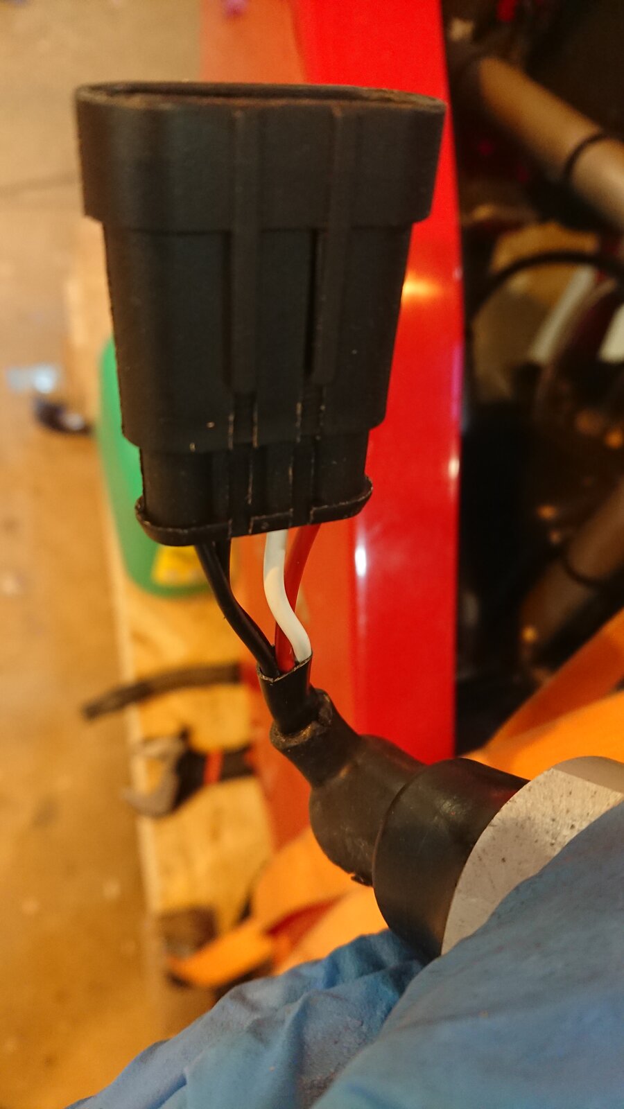

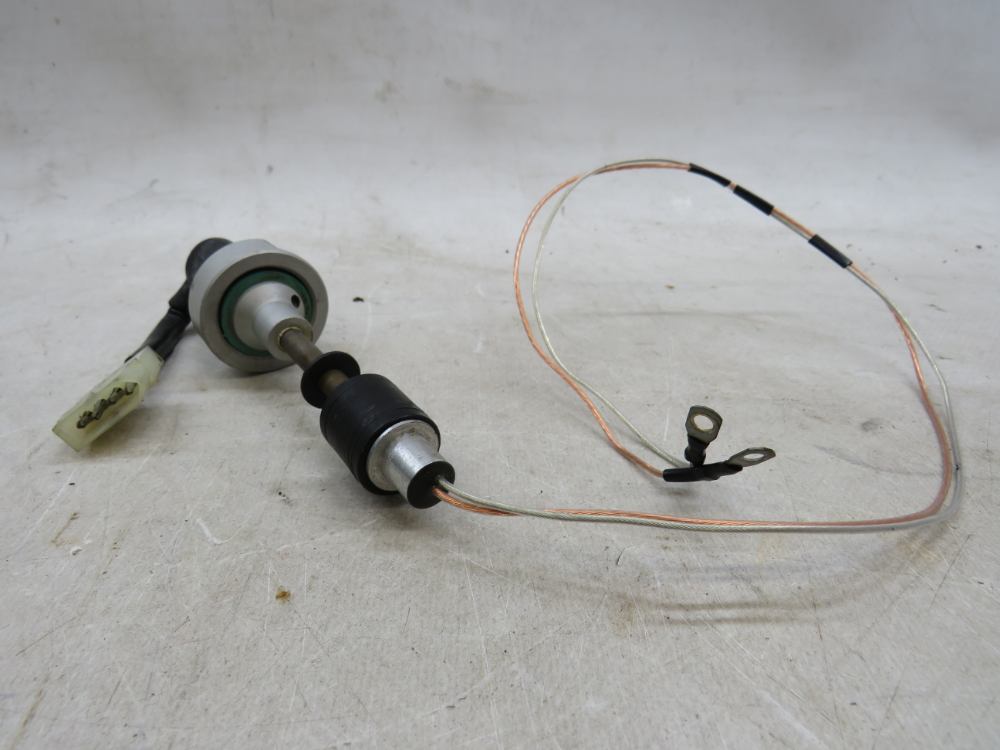

  4. I got this on Ebay for £40 so let's see if it solves the problem. Not identical to the one on the bike now but if it works it's a cheap fix.
  5. Swapped the non working one for the Ebay sensor today and it works. I had to cut off the plug that was on it and swap it for one that matched the loom.
    The old one used a thermistor to sense the fuel level and this one has a float that rises and falls.
    Motorapido quoted £144 plus VAT for a new one so for £40 and a new connector I'm happy.
