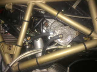

  9. [​IMG]
    Here's the kit I've fitted, somewhere just after the fuel filter, visible under tank, is also a vacuum fuel stop valve.
    Pumps the fuel on start and seems to ride fine around the town with little dashes - yet to test on open road.
    John
    Sent from a mobile transmitter.
