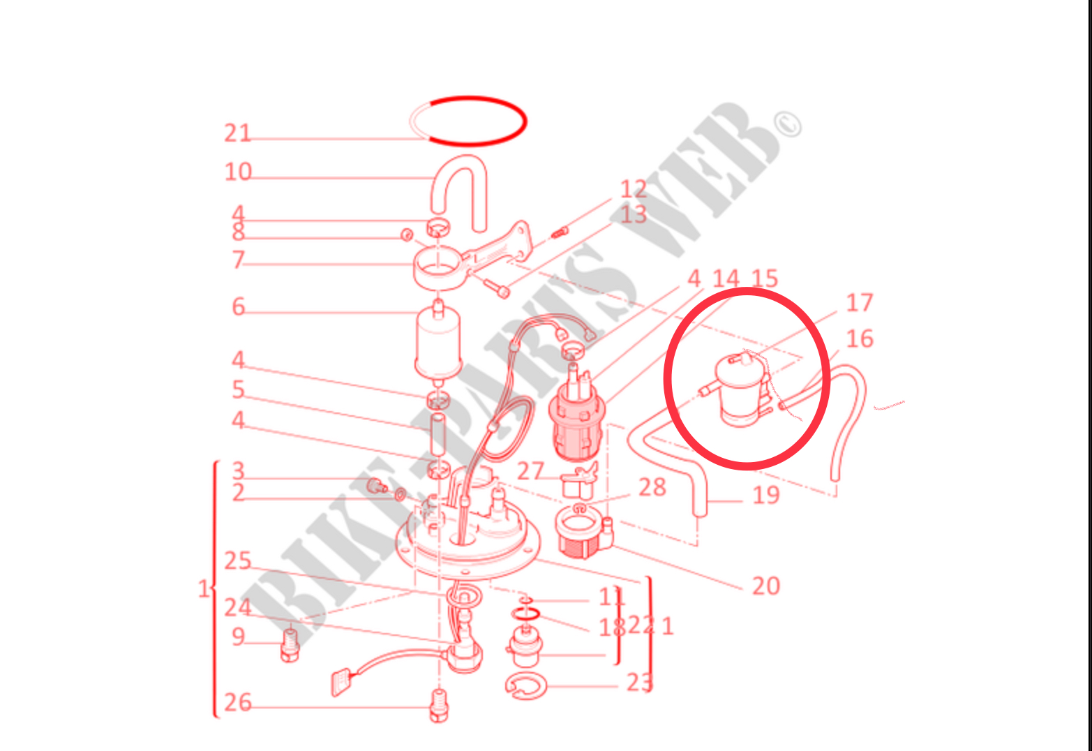

  1. Got them out intact (mole grips, as I could get neither an open-ended or socket on them.) mangled a little, but as they’re being replaced, I suppose it doesn’t matter. Those little springs go quite a way, don’t they!
  2. Everything back together in the tank. Now I’ve come to changing the male QR connectors I find that the hose is actually 2-part, a rubber? outer but a plastic inner, shrunk onto the male connector! Got p*d off trying to wiggle it off, and packed it in for the day.
    Once I get those off (any suggestions?) the tank can go back on and be tested for leaks from the various joints/seals.
  3. Change the hoses for standard rubber? My MV has the hoses you describe as well. They're nice because the hoses are shaped to stay in the right place but I remember that people having the same problem you're having and replacing the hoses with rubber ones was the solution.

  7. I took the advice and replaced the hoses. Question. Now the bike is running again, should there be fuel recycling into the tank from this component?
  8. Yes
  9. Good. Thanks.
  10. yes, but not massively, if you can run it with the fuel cap open, try and see where it's coming from, be careful about opening the throttle too much though.

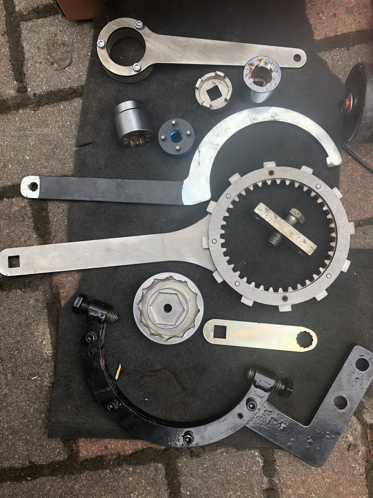

  11. While I’ve got your notice, could anyone advise me which of my 996 tools will fit the 998? (I know the big Multistrada socket doesn’t, but I’d taken the pretty picture by then)
