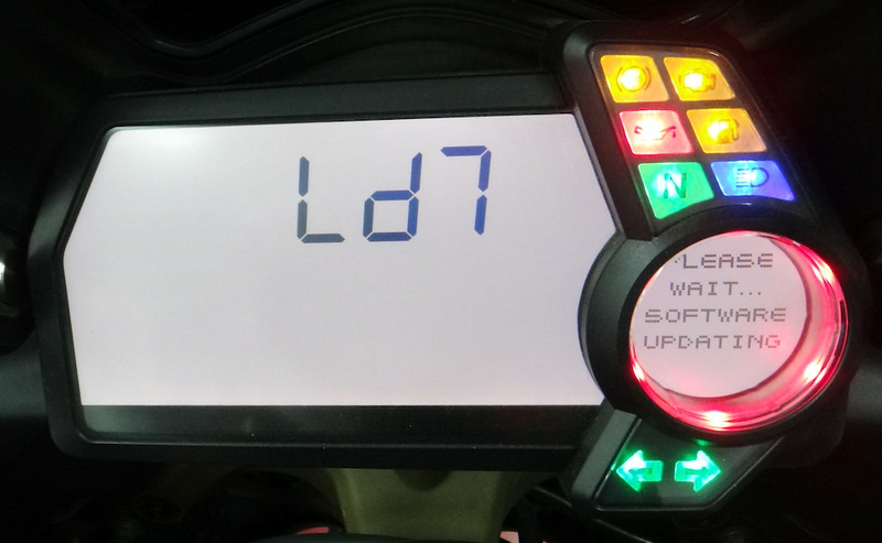

  3. UPDATE... had time earlier today to have my new generation fuel level sensor (59210211C) installed and the software update was done.
    All working fine and well again now with my MTS-PP..... ready for more China ADV cruising....
