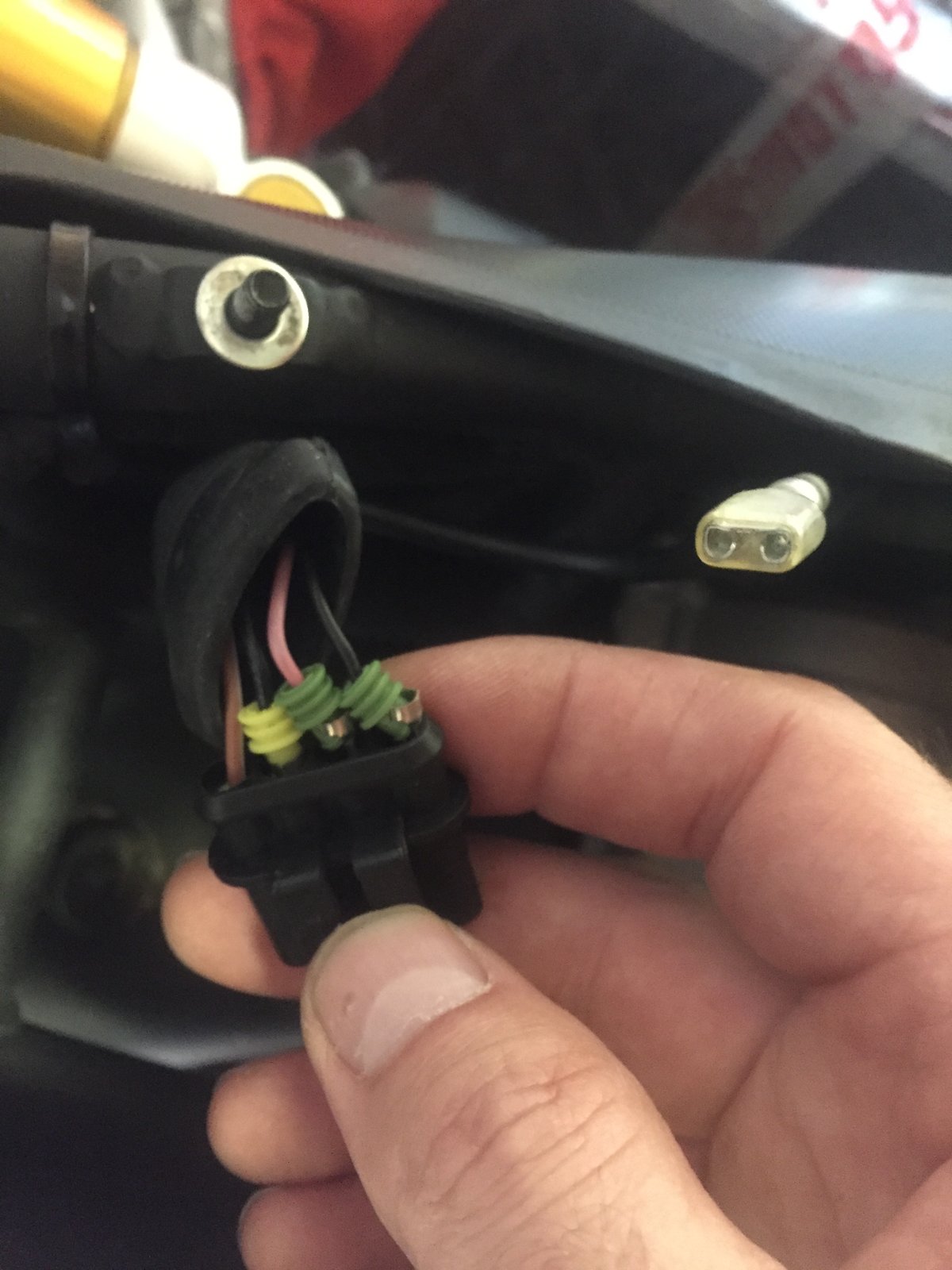

  11. 4603B9D9-5855-4742-813E-D995FE1A0B51.jpeg SORTED.
    Quite annoying what it was. The pins on the fuel pump were fine. Dead straight. But three of the four silver plugs had been pushed back in their housing. I only found this out as my dealer suggested testing 12v was getting to the plug. On initial inspection I couldn’t see any contacts, so I proceeded to take the plug apart.
    I guess they either got pushed back on reassembly by poor alignment on my part, or pull back when I removed the plug in the first place.
    Jeez, I’m happy the bike is now working. Missed all the nice weather though!
