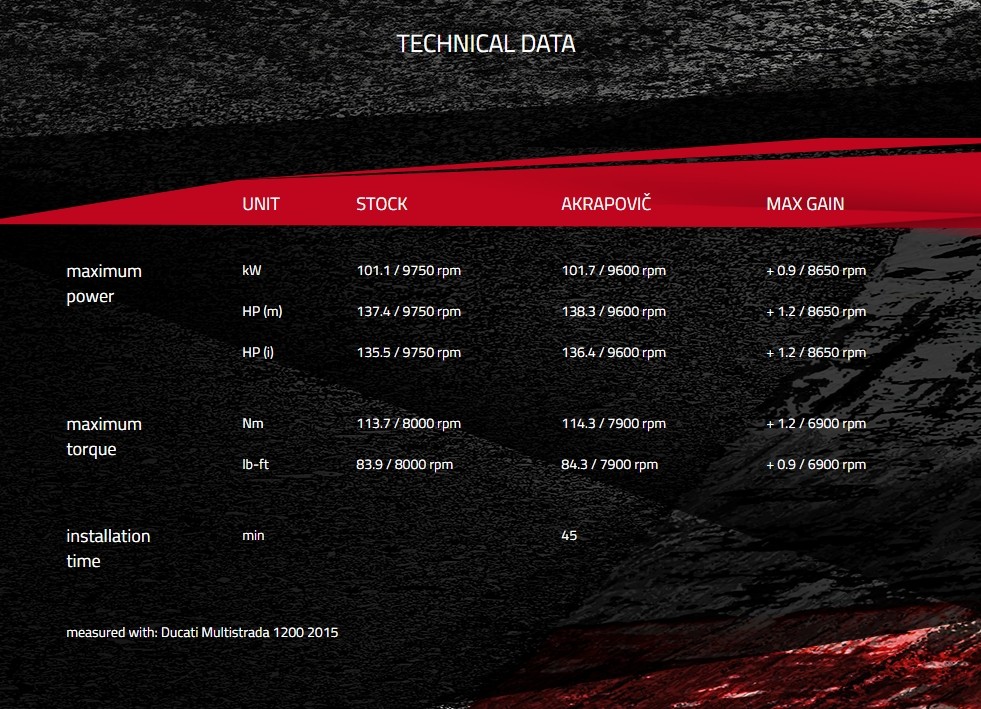

    A full titanium system from Akrapovic only adds 1.2 HP.....and that's under optimal marketing conditions. YMWV.
    Here's the text:
    Optional titanium headers for the best aftermarket performance increase
    The new exhaust delivers 1.2 extra horsepower at 8,650 rpm, and 1.2 extra Nm (0.9 lb-ft) at 6,900 revs.
    akrapovic-revolutionary-exhaust-now-available-in-titanium-for-the-ducati-multistrada-1200_6.jpg
    https://www.autoevolution.com/news/...i-multistrada-1200-photo-gallery-101686.html#

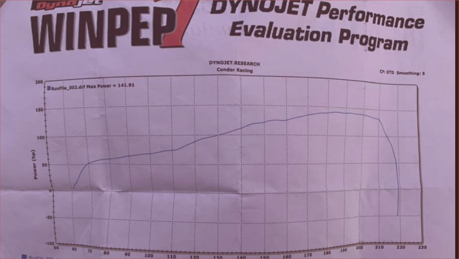

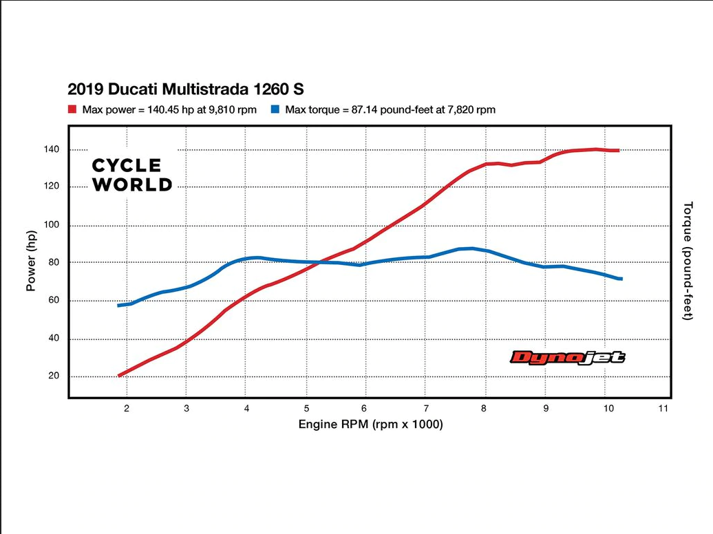

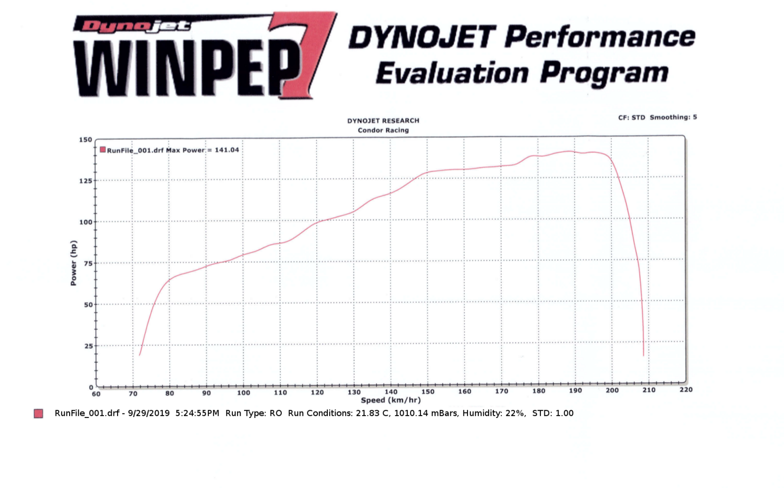

    Both my 18 1260 Multi and my pal's 17 Multi 1200 were put on the same dyno, same tech, just a couple of hours apart.
    Both bikes are stock except his 1200 has a Rapibike unit.
    As a reference, the stock bikes were dyno'd by Moto Magazines as followed (See charts):
    1260 DVT @ 140.45 HP
    1200 DVT @ 133.70 HP which is pretty much inline with Akra's stock number of 135.5 HP shown in the table above.
    Our personal dyno results were as follows:
    My 1260 came in as expected @ 141.04 HP.
    His 1200 came in @ 141.91 HP, a huge HP increase solely because of the Rapidebike's fuel map.

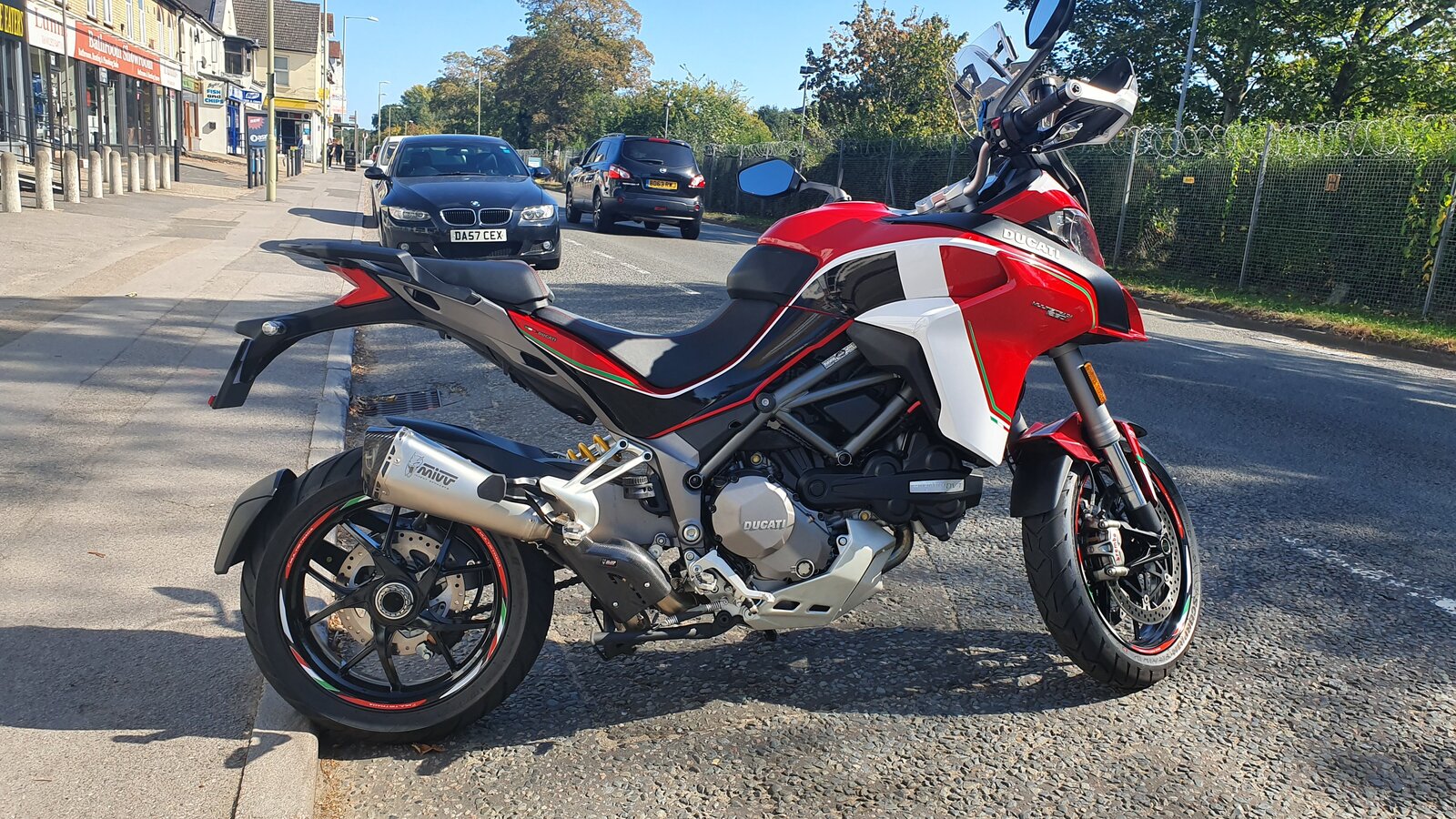

  13. I have a full Mivv system fitted (headers + end can) and I haven't had mine mapped. It doesn't feel that different to the stock set up in my opinion. Doesn't feel any more choppy or more powerful.
    I believe an up map of some description would make it better, but I'm confident that my bike self adjusts to make it OK without.
    Also have the exhaust valve eliminator fitted (takes around 5 minutes, very easy) and throttle spacer to reduce the ambiguity in the throttle response (helps make it feel less choppy)
    As previously stated, it is really quite loud on cold starts until it warms up, then it quietens down
    If someone manages a proper tune for the 1260, I'd consider it, but I don't think it's necessary
  14. Looks like your outside Infinity's in Northcamp ;)
  15. Haha well spotted!

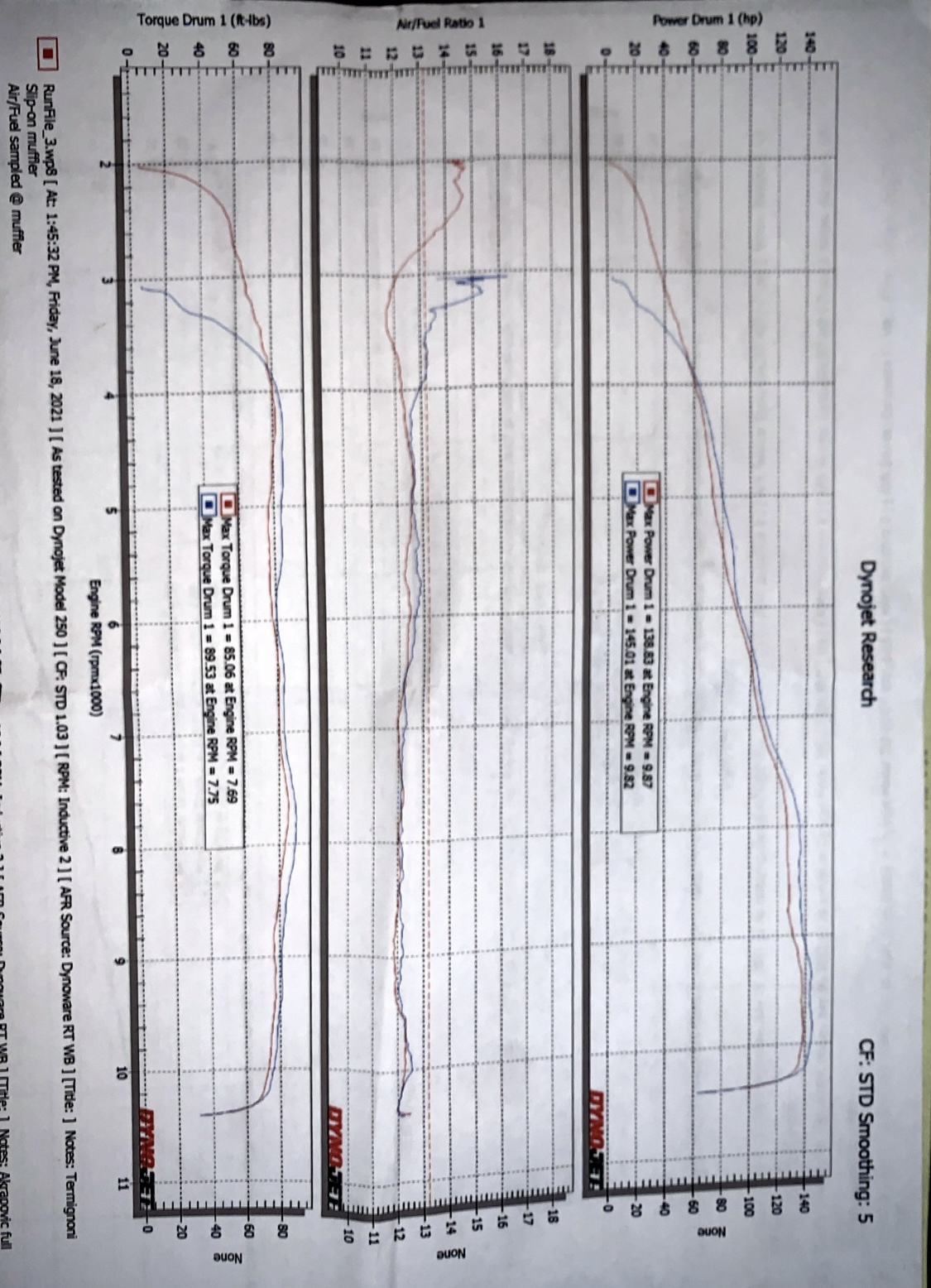

  17. Hi everyone- I just want to give everyone my data on this.
    I have a 2019 MTS 1260 pikes peak. I put it on a Dyno before and after upgrading to the full Ackrapovic
    Stock -
    peak HP - just under 139 - I am running softer tires (Perrelli Corasa 2) so I probably lost a horse or 2 from that - stock should be 142.
    Peak torque- 85
    Air fuel - fluctuates based on RPM but average was about 12.2
    After mod Dyno
    peak HP - 145
    Peak torque- 89.53
    Air fuel - hardly moved and follow same curve as stock - average is 12.5
    So gains -
    Near 5.5 HP
    Just under 6 foot pounds
    Air fuel was fine post mod - no need for aftermarket fuel mapping or systems,
    At least on my bike.

  18. Here is the Dyno chart. I had the 2017 MTS 1200s and put on the full Termi with upmap. I did not Dyno before and after with the Termi but I honestly felt no gains with that exhaust. This one I can feel and the nice thing is the gains are not just at peak but through most of the RPM range. I feel like I made a good choice on this exhaust.
