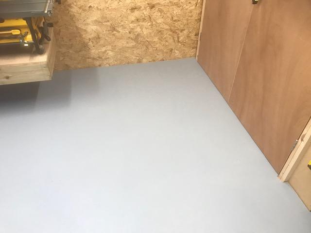

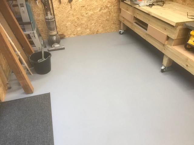

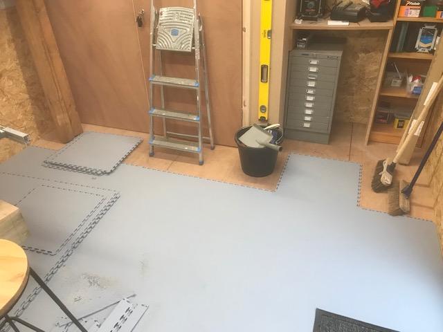

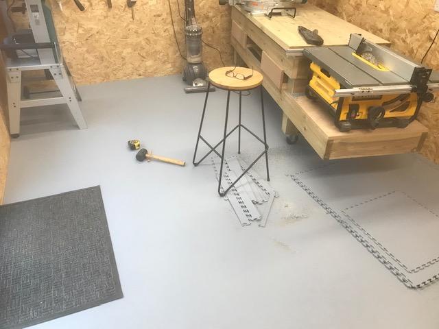

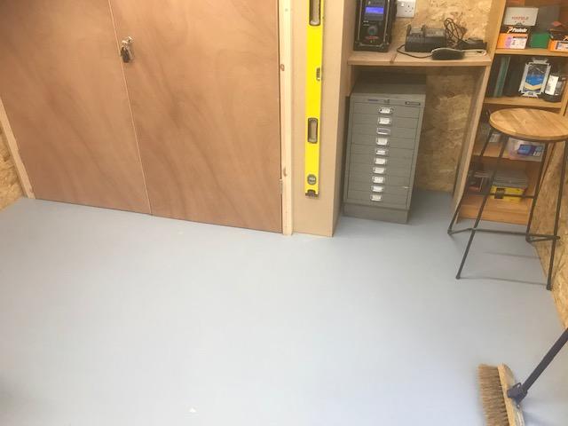

  15. Nearly finished.

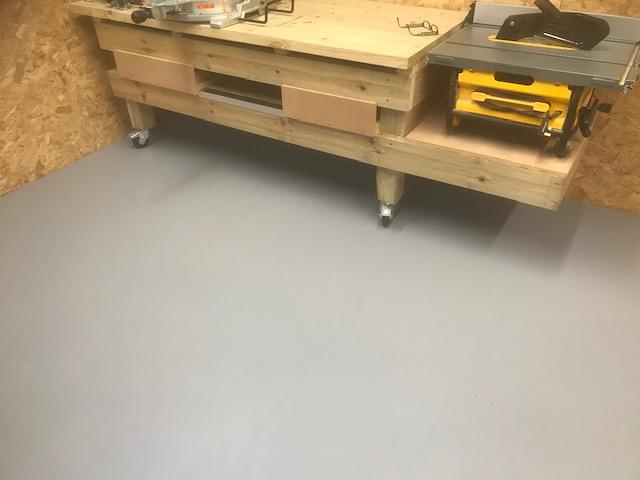

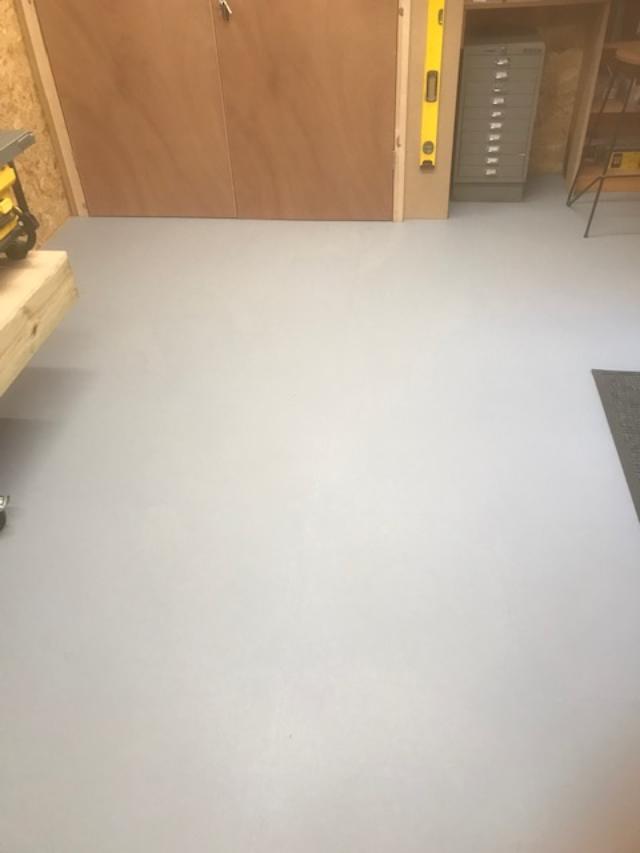

  16. Just finished. :grinning:
  17. You also buy from the same place as Rob?
    Only joint seems less noticeable - but yours looks like a flat finish tile too...
    Thanks
    GOOD JOB!!!! (Sorry for the Americanism..)
  18. Yes I got Duramat the same as Rob but I went for the smooth finish because it's a woodwork shop and I wanted it easy to clean.
    I'm really impressed. They are easy to lay and look great.
