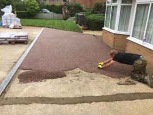

  4. Has anyone had a resin drive way and then tried it as a garage floor?

  6. Sorry, I meant the resin bound driveway such as these
    But I suspect the flooring you mean is like that heavy industrial vinyl like they use in kitchens, hospitals, commercial toilets etc
