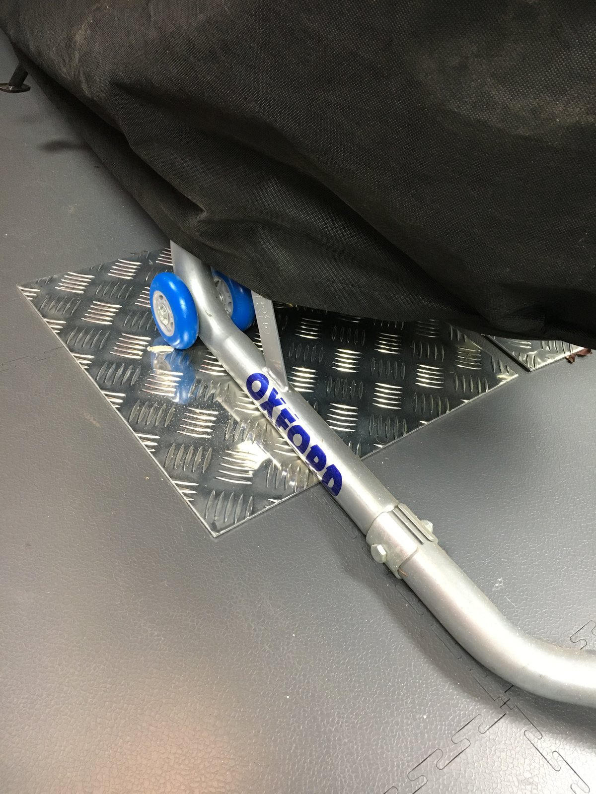

  1. I originally had my garage floor done with an epoxy. They did a great job, ground the surface to key it, filled holes etc and put 3 coats down. Looked amazing and seriously tough; I just wish they had suggested mixing some pumice with the paint! While the floor looked amazing come the day I walked in with wet boots on it was a skating rink. It needs something gritty in it. I lived with it for a while and toyed with the idea of getting them back to re-coat it but decided to move on.

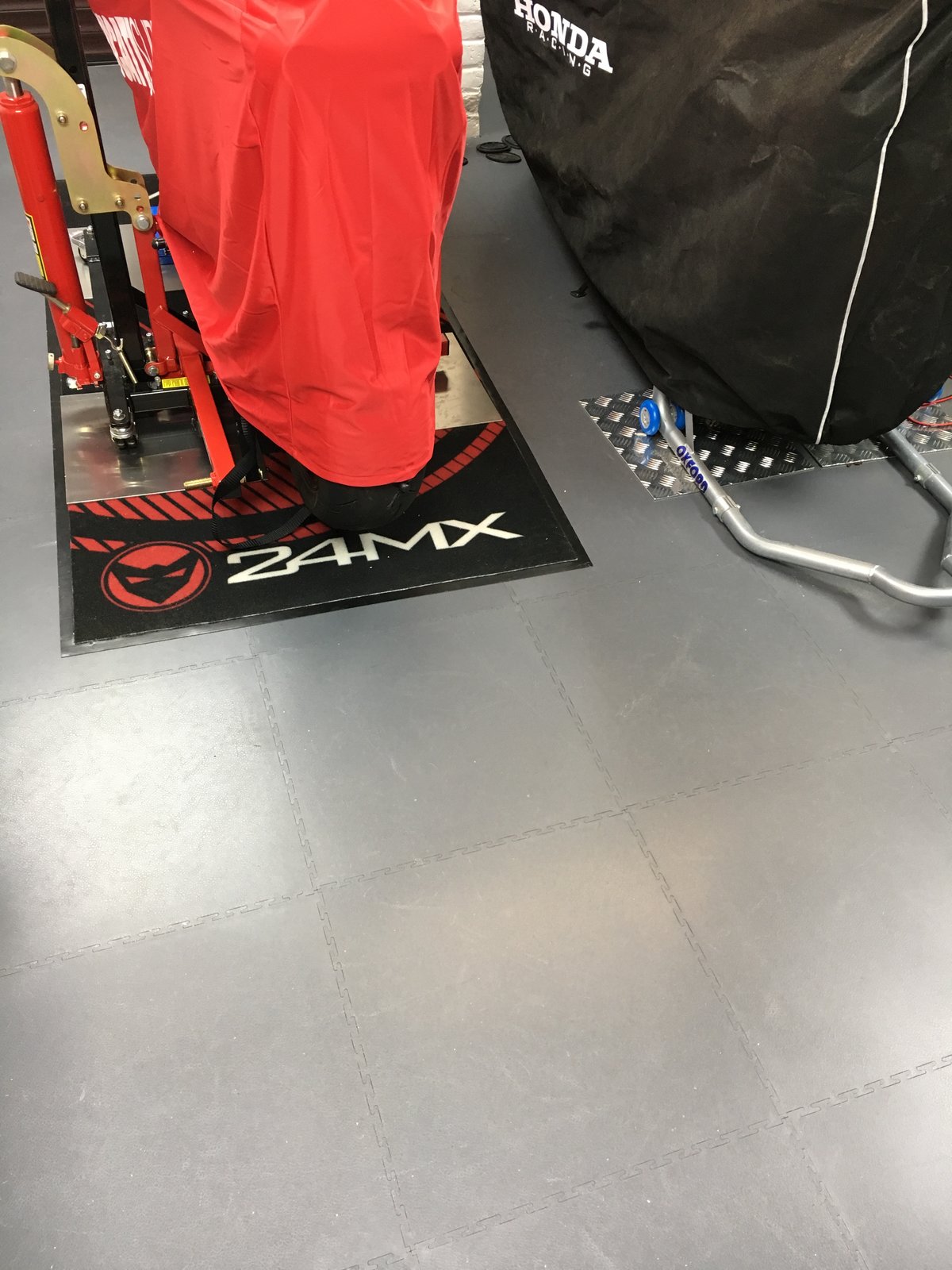

    So round two. I bought from Ecotile (https://www.ecotileflooring.com/) an end of batch load of 7mm Industrial interlocking tiles at a good price. They say heavy duty and good for garage workshops.
    They go down very easily, have good grip and also add insulation - if you have to work on the floor it isn't cold like bar painted concrete however a couple of drawback;
    1) The floor does mark due to a chemical reaction with tyres, they tell you this; "https://www.ecotileflooring.com/application/garage-workshop-flooring/) so I chose a dark grey.

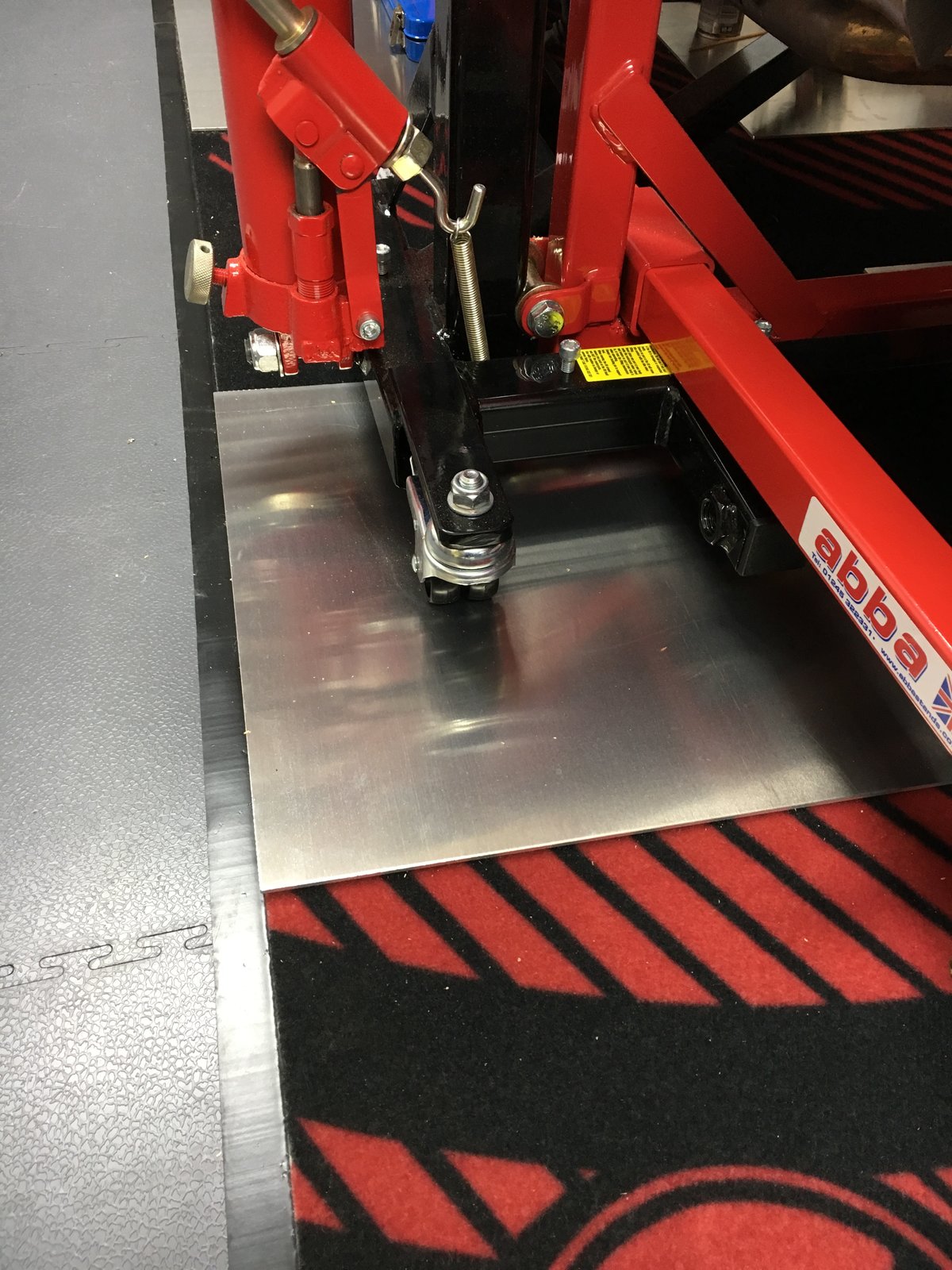

    2) I have found the tiles mark from paddock stands and my Abba Lift wheels.
    They did at one time produce some tiles with inset 3mm steal plate that could be used to avoid point 1 or I thought 2 how ever when they shipped me a couple the plates where just stuck on the tile and I didn't like them so sent them back.
    I ordered some "checker plate" 3mm aluminium 400 x 400 plates but found I couldn't move anything over them as they were too rough for anything that didn't have large castors so got a couple of flat aluminium plates - much better.
    I'm going to have a go at routing a recess into a couple of spare tiles I have, if it works then great.
