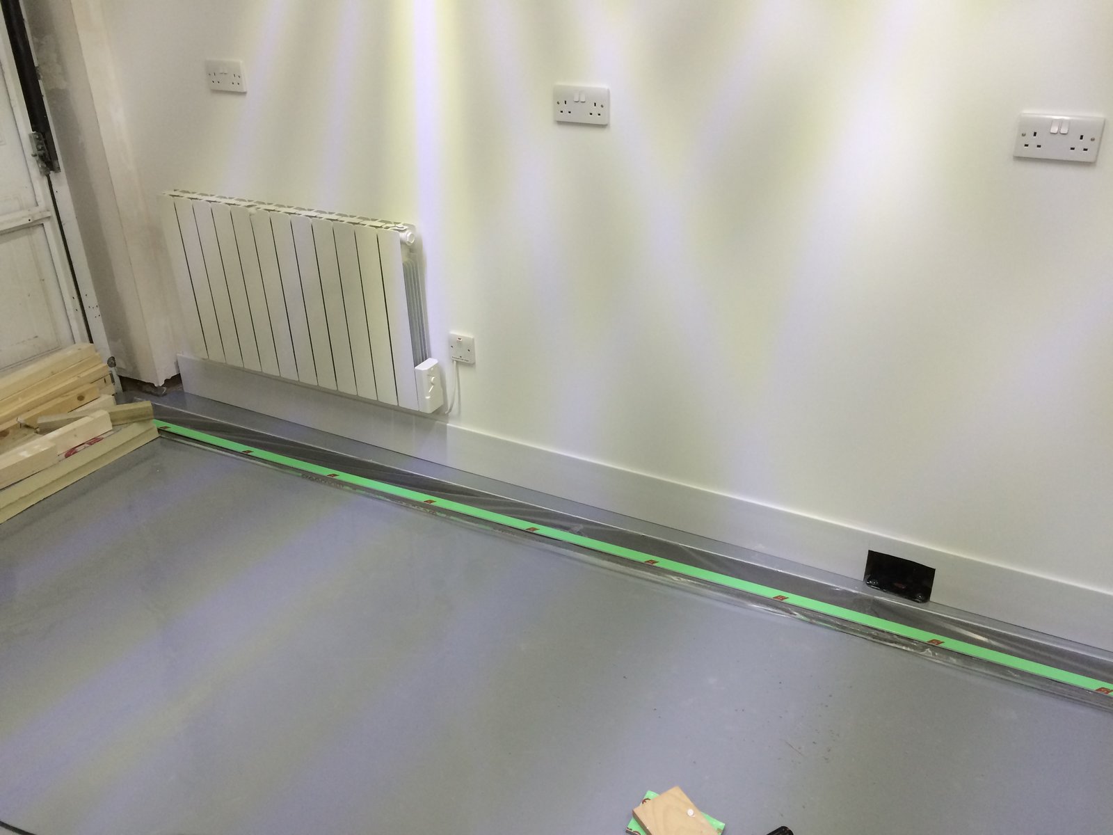

  4. Electric underfloor heating is ridiculously expensive to run.
  5. I already have 2 electric oil filled rads, so it was just a thought as these cost a fortune if you leave them on. They are effective though, heating the garage quite quickly when you need them.
  6. forget the sofa. You need barstools and a bar.:yum:beer:
  7. With Electric at around £0.12 / kWh and gas at £0.03 / kWh it should be 1/4 of the running costs to use a water fired UF heating system - assuming that your combi boiler has sufficient capacity... but the install means you need to empty the garage... lay the tubing - lay a new floor on top as well as as the extra controls and pipework, mixer valve and pump for the UH system.
    Doing it yourself is probably £1500 in materials over and above the floor covering cost....
    Electric is probably less install work - but not much....
    Me - I just fitted a large double radiator - T off my upstairs heating system and added a second wireless thermostat T to the main upstairs thermostat - so that if the garage calls for heat (set at 7 degrees) the upstairs is completely heated including the garage... but ALL radiators except one in the main bath room have thermo rad valves... so only take supply if the room needs it.
    Ideally the garage feed would have its own dedicated control and supply circuit - but retrofitting was not something I wanted to do on a new house with plasterboard walls and sheet rock flooring.... I did persuade the builder at end of build to take a hot water and cold water feed and a heating supply and return feed from the adjacent en-suite to the garage... house was 95% built by the time we agreed to buy. Then I fitted the radiators and control from there..(radiator in garage and dog lounge - room behind garage for the then pair of Rotties... now sadly gone..) as well as hot and cold water for the garage.
    Another alternate - which while using Electric - has a super high efficiency factor - is to fit an A/C system.... can be left on low all time - or on when needed - also acts as a dehumidifier... similar running cost to gas..
    Easier to fit - depending on location and pipe run... Theoretically you need an engineer to commission and turn on... but I fitted 3 systems myself... once you have the gauges, flare tools, torque spanners, vacuum pump (£250 to £300) as long as you buy a system big enough with sufficient charge and pump capacity to suit your pipework its easy.
    The actual commissioning - is less than 2 hours - including an hour vac and 30 min leak test... install time varies depending on location of units, pipe runs, ducting, electrical supply etc....

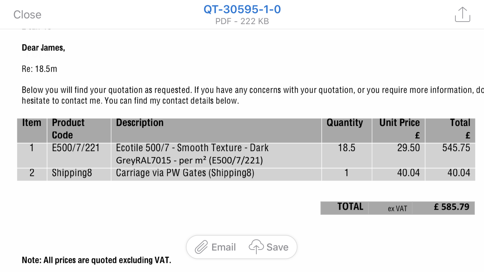

  9. Just mailed Ecotile for a quote on the smooth tiles. :) :upyeah: They look cheaper than Duramat from your pricing.

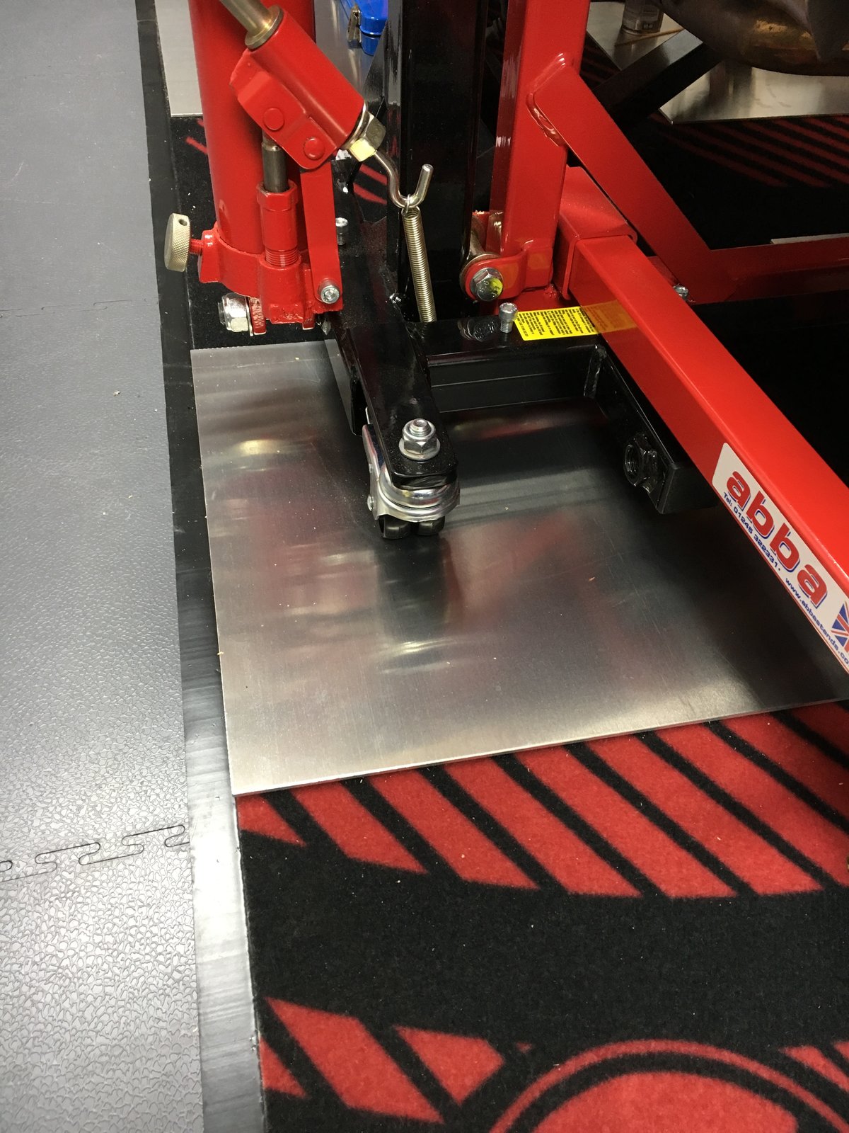

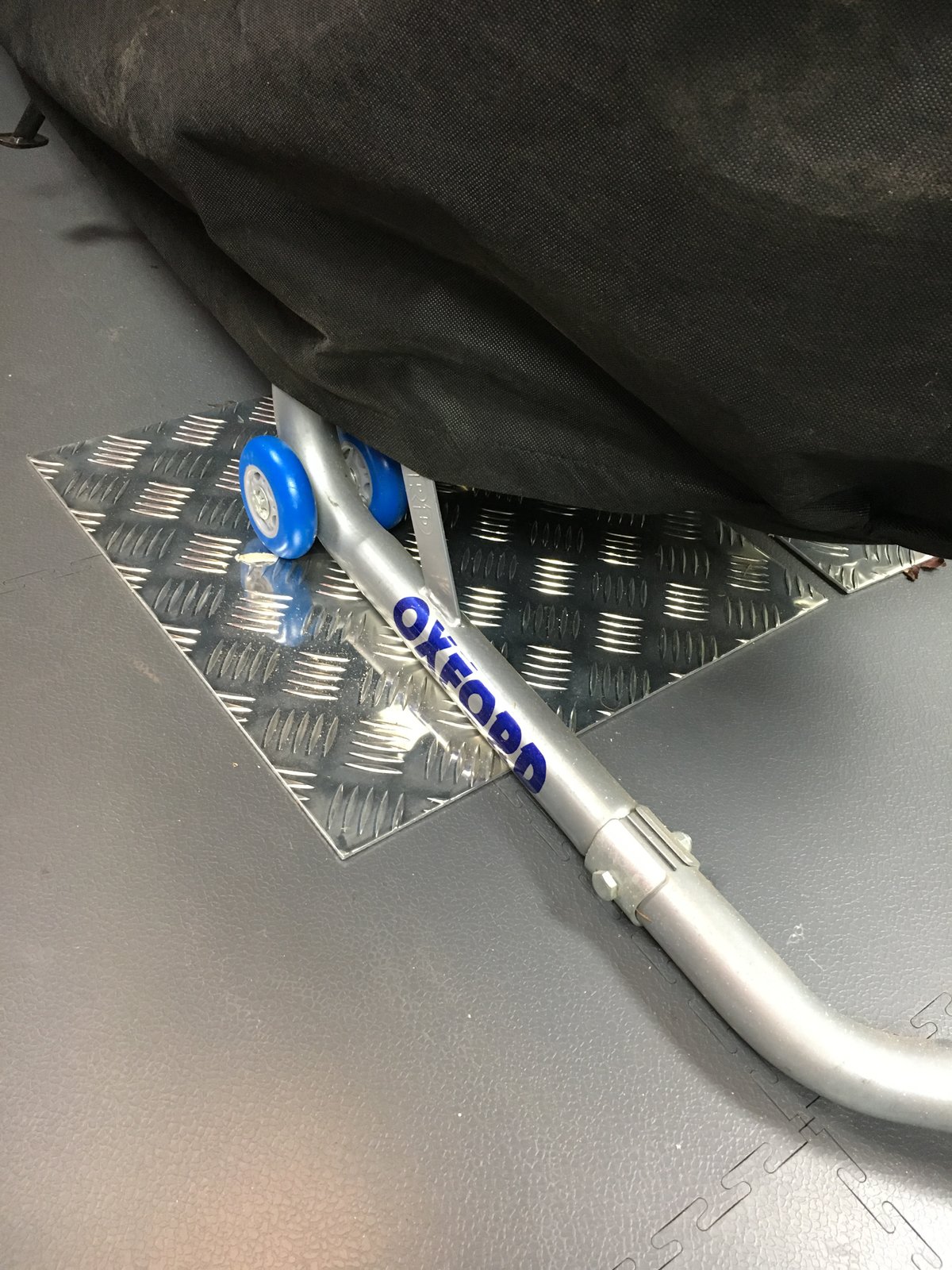

    I like the checkerplate too for under paddock stands and my bike lift.

  11. I found Ecotile for sale on eBay so whilst awaiting my official quote, I’ve used that as a baseline. I can do my 18.5sqm for around £300 which is cheaper than Duramat.

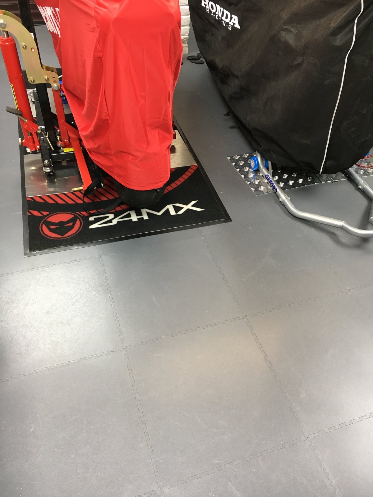

    Not a fan of checkerplate as probably not nice for the little wheels on paddock stands etc. I’m thinking smooth or cointop. Even their smooth has an anti-slip texture though which is good.

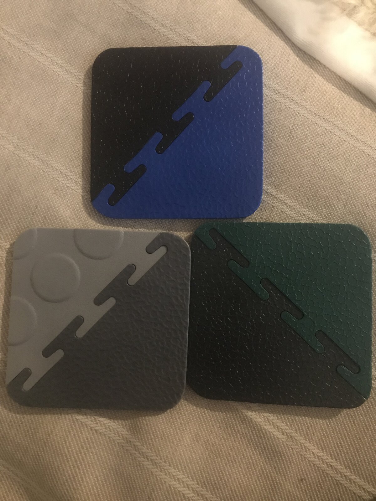

  12. I got mine from south coast matting
    About £4 for a 500mm square 7mm leather effect tile, restricted on colours but was value for money in comparison to other tiles available.

  15. Got my ecotile quote through.
    Samples look good too. I prefer the look of the cointop, but in the darker ‘graphite’ that’s adjacent to it.
