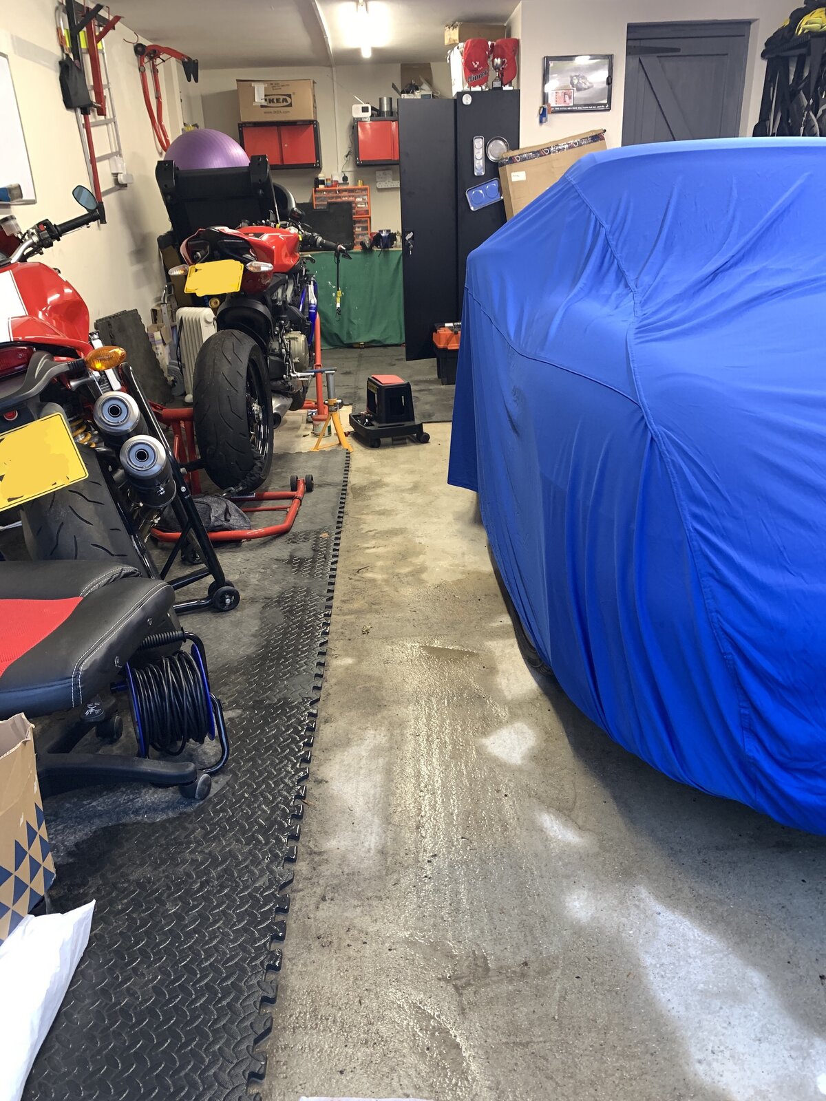

  1. I’ve deliberately fitted 180x120 individual mats, so if there’s any leaks I can just pull one up at a time.

  10. Think I may have discovered why I get puddles in the garage. It’s pouring under my new (ffs!!) garage door and spreads out from there. Part of it seals nicely but I can see daylight from inside under a 3ft section.
    There is some coming from one side wall too but that’s where my neighbours have attached a chicken coup to the side of it! And before that big compost bins…no wonder it’s damp!
  11. A simple fix for the front door woud be an angled bar stuck to the floor to form a lip behind the door.
    You may want to fit a drainage grill across the front of the door in the drive.
    Have a chat with the neighbour about the chickens.
  12. Neighbour won’t give a duck.
    I’ll have to do something about it for sure. First time I’ve witnessed why it’s getting so wet.
  13. You could also put a small mortar ridge just behind the door,
  14. May be the only real option. The floor is clearly not level at the front, I live at the bottom of a hill so not surprised tbh.

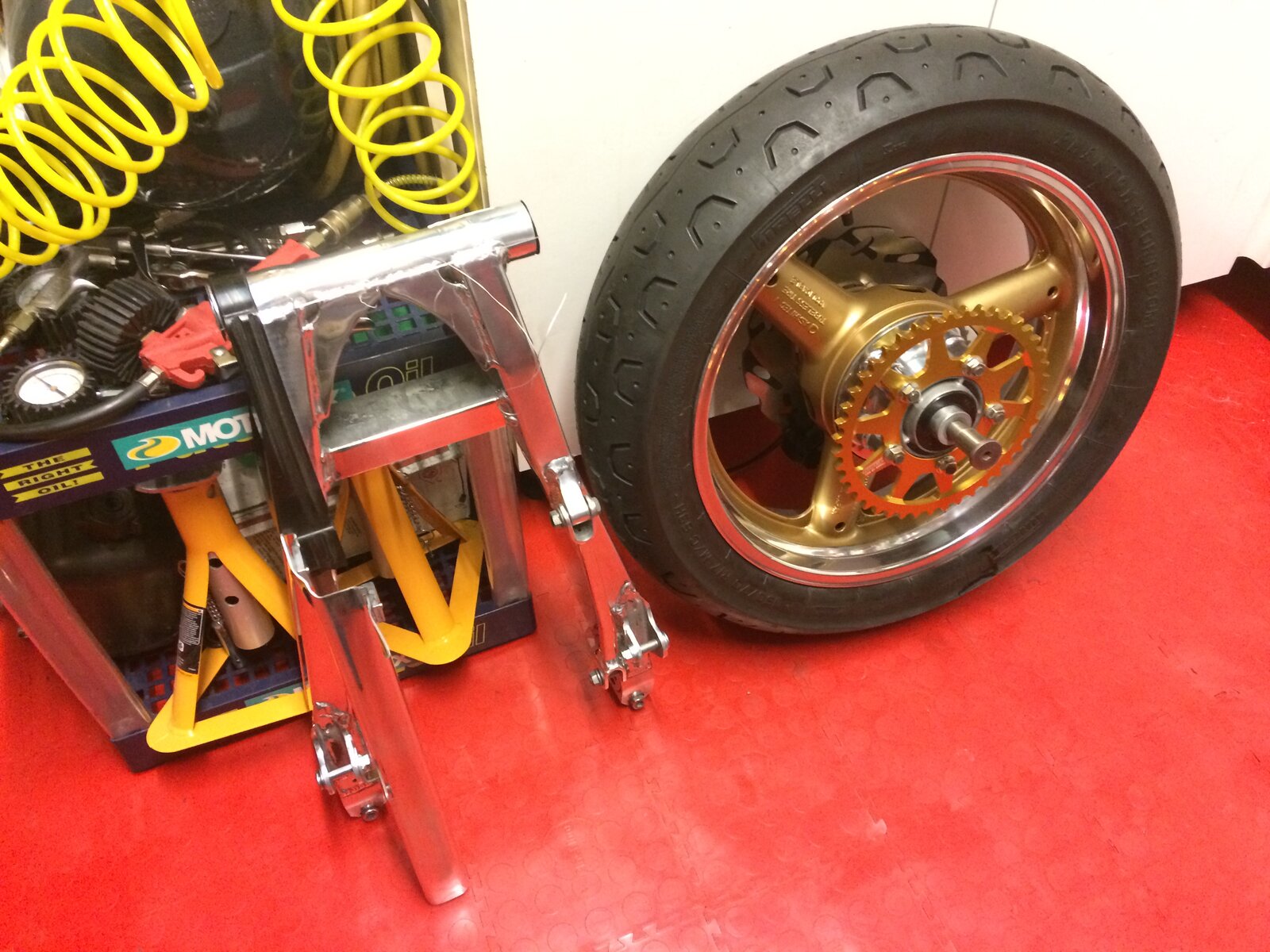

  15. I covered my garage floor a while back now with interlocking plastic tiles. One of the best things I did. The garage is warmer, less damp and a lot cleaner now. I bought mine from Plasfloor. Since added a sealed roller shutter too to complete the job :)
    http://www.plasfloor.co.uk/ Easy job to fit upload_2022-2-14_9-43-10.jpeg
